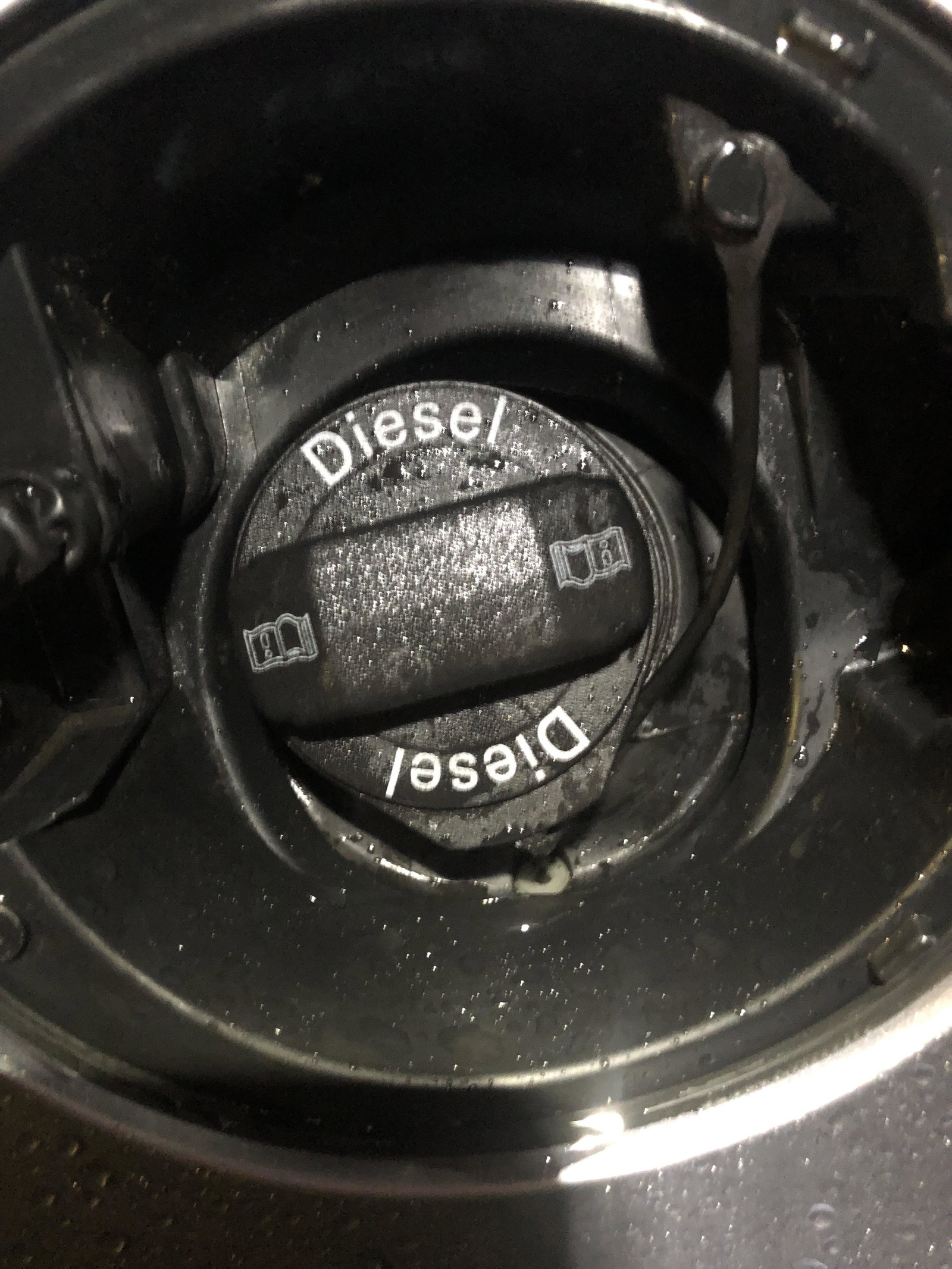

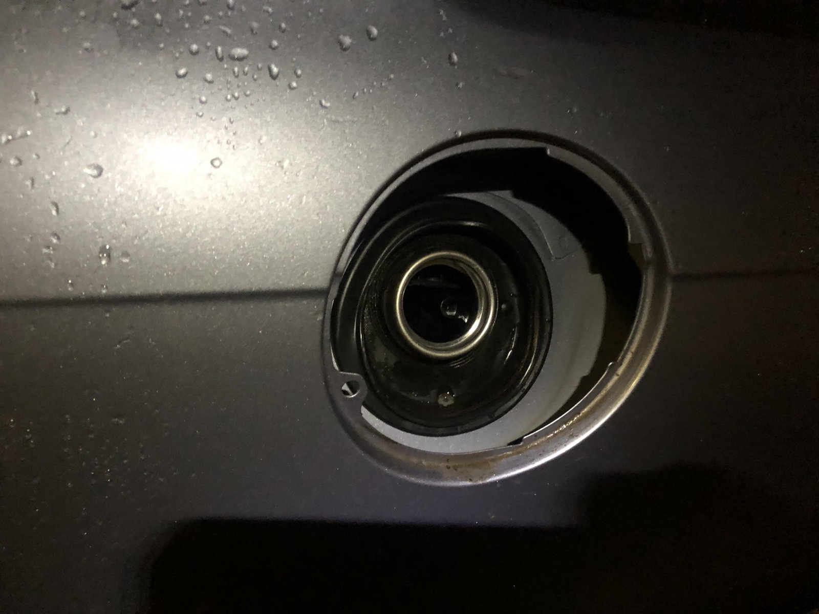

Shane G60 Posted January 5, 2023 Share Posted January 5, 2023 Hi. I had water leaking into my boot. Checked everything from rear wiper seal, brake light in spoiler to rear light cluster and in the end it turned out to be the seal around the fuel filler flap. The water was dripping down inside, down the inner arch and pooling inside the trim. It then overspilled into the wheel well. One Philip screw holds it in from the outside but you have to disconnect the solenoid from the inside. Tube of sealant and she鈥檚 sorted 馃憤聽 Quote Link to comment Share on other sites More sharing options...

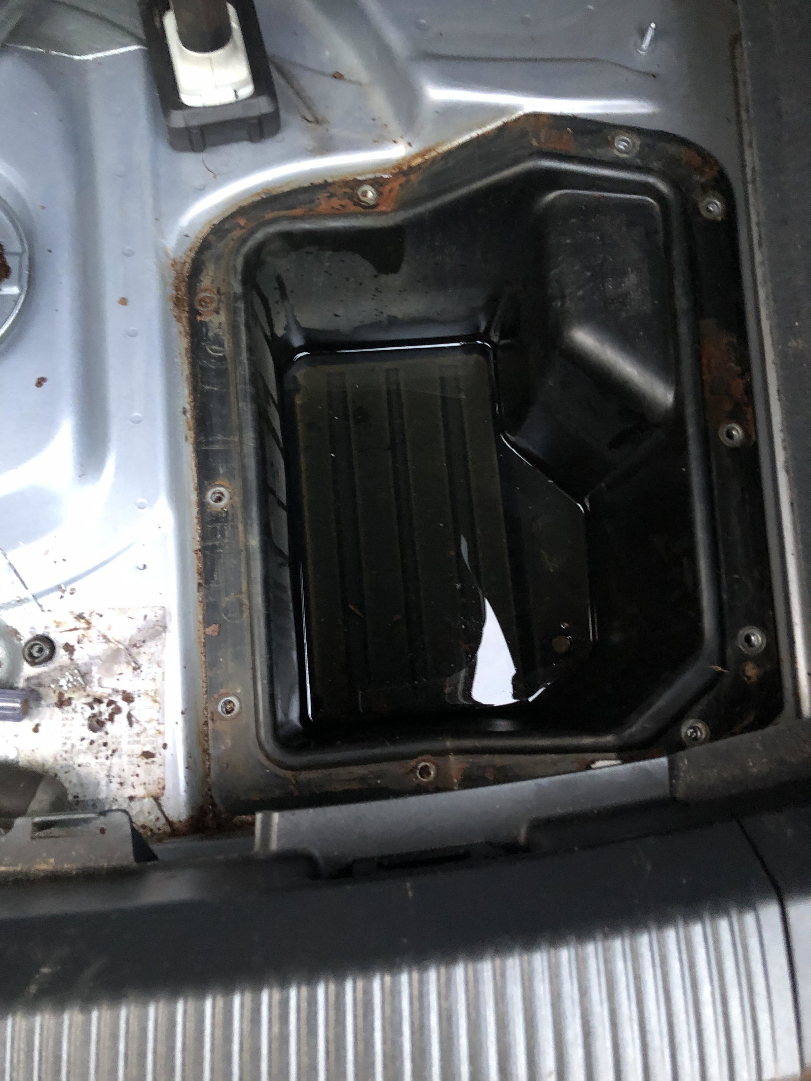

Shane G60 Posted January 5, 2023 Author Share Posted January 5, 2023 It鈥檚 a 2007 Audi A3 2.0 TDI sportsback. This strange box was located under a metal lid held down by 10 T30 screws. No idea what it is for. It was FULL of water and no drain hole. Think it鈥檚 for goldfish 馃お Quote Link to comment Share on other sites More sharing options...
