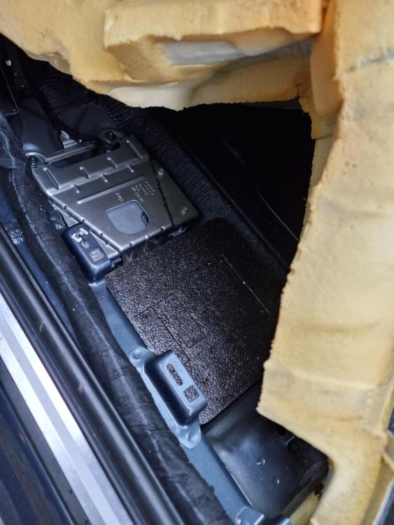

I'm trying to find the culprit for my mmi not working and I have replaced/reimaged the HDD in the main unit.  I have also tested with a loopback the optical fiber from the amp with no success.  When looking at the fiber cable that connects to the main unit there is no light so I'm assuming there is a module somewhere that is not working.  My next move was to test the Bluetooth module which, from what I understood, was underneath the carpet in the passenger foot well (RHD).  When I pulled up the carpet there was no black box with the module inside but only a camera/lane assist module.  Any idea where this Bluetooth module would be?  I pulled up the driver side as well and nothing there either. Any other points to check with the loopback?
