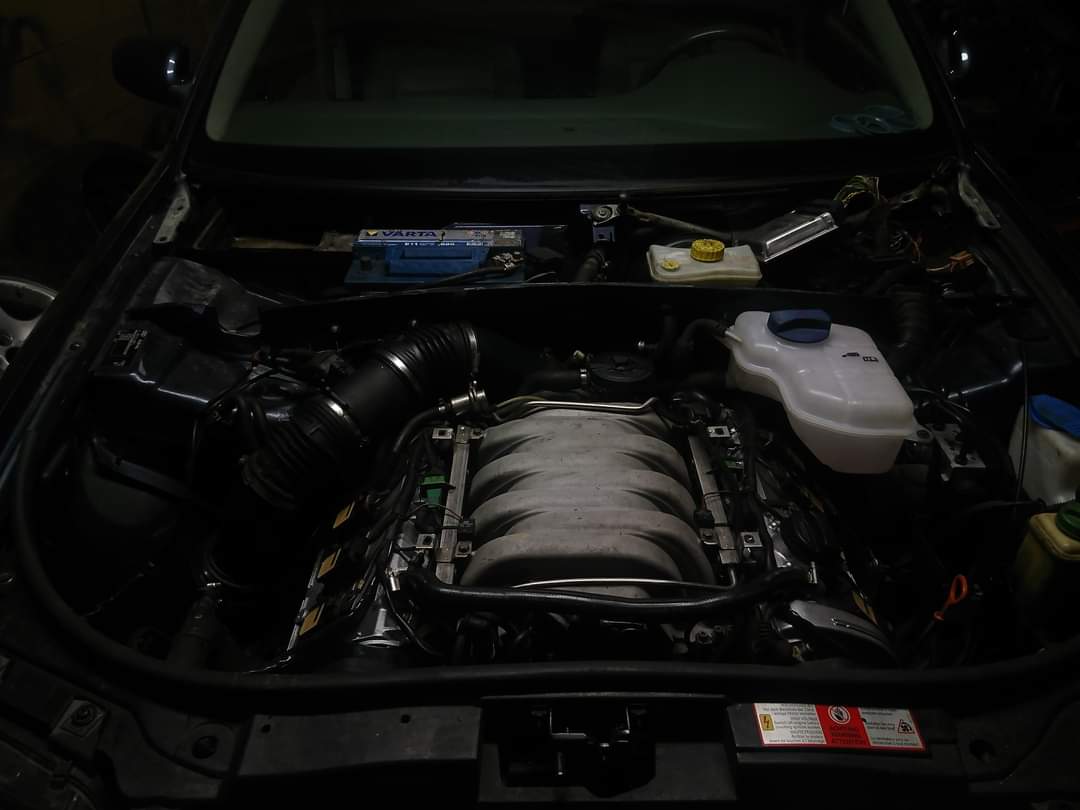

Not ruling out a V8 either, as I've found a narrow body A6 like mine fitted with the 4.2 Audi V8. I'd be looking at the rover V8 3.5 or a lexus v8. I've ruled out the Toyota Hilux diesel (2LT) as they're not as reliable as I thought.

NEEE PROBS STEVE       OH A V8 LIKE MINE
