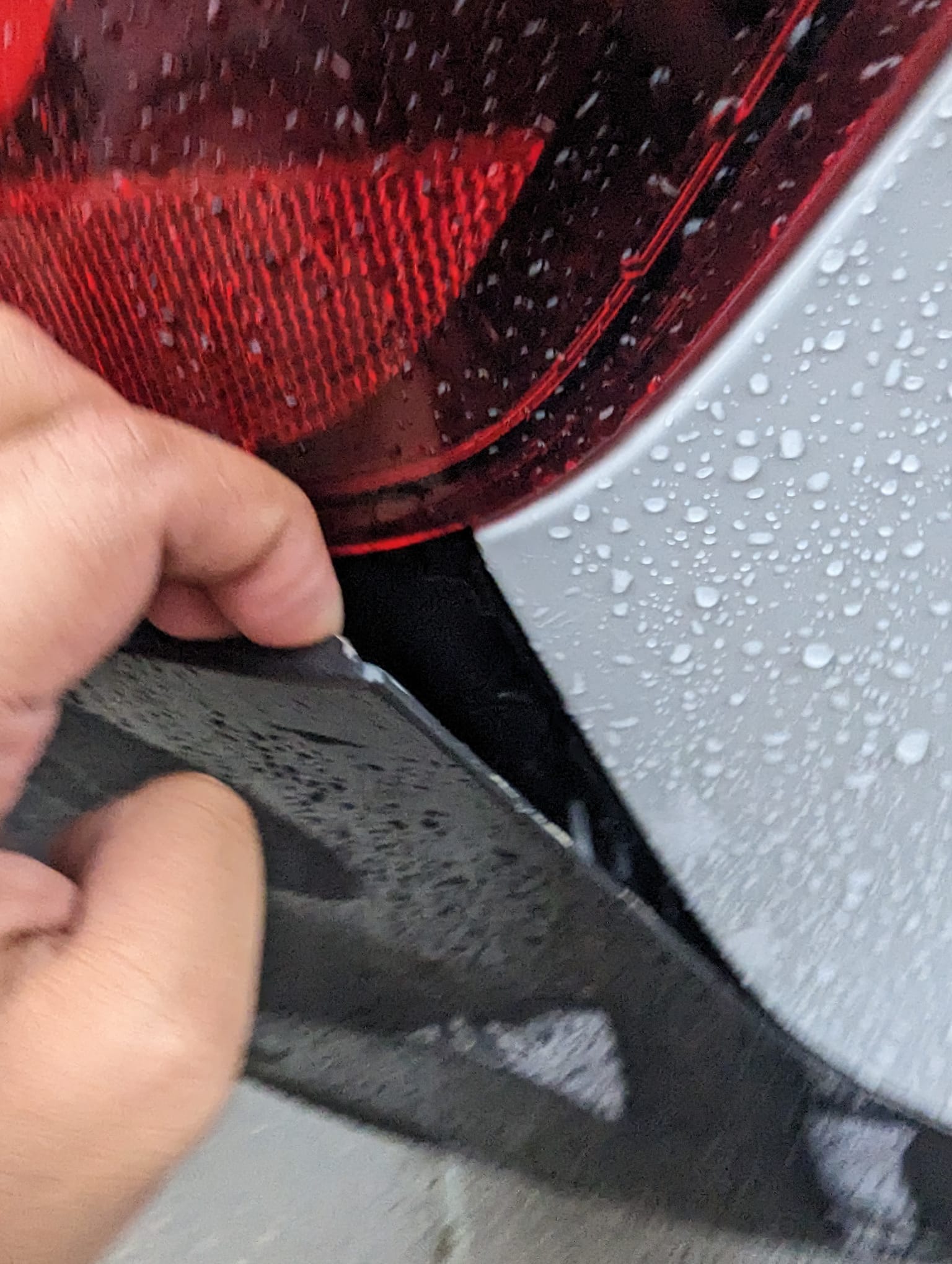

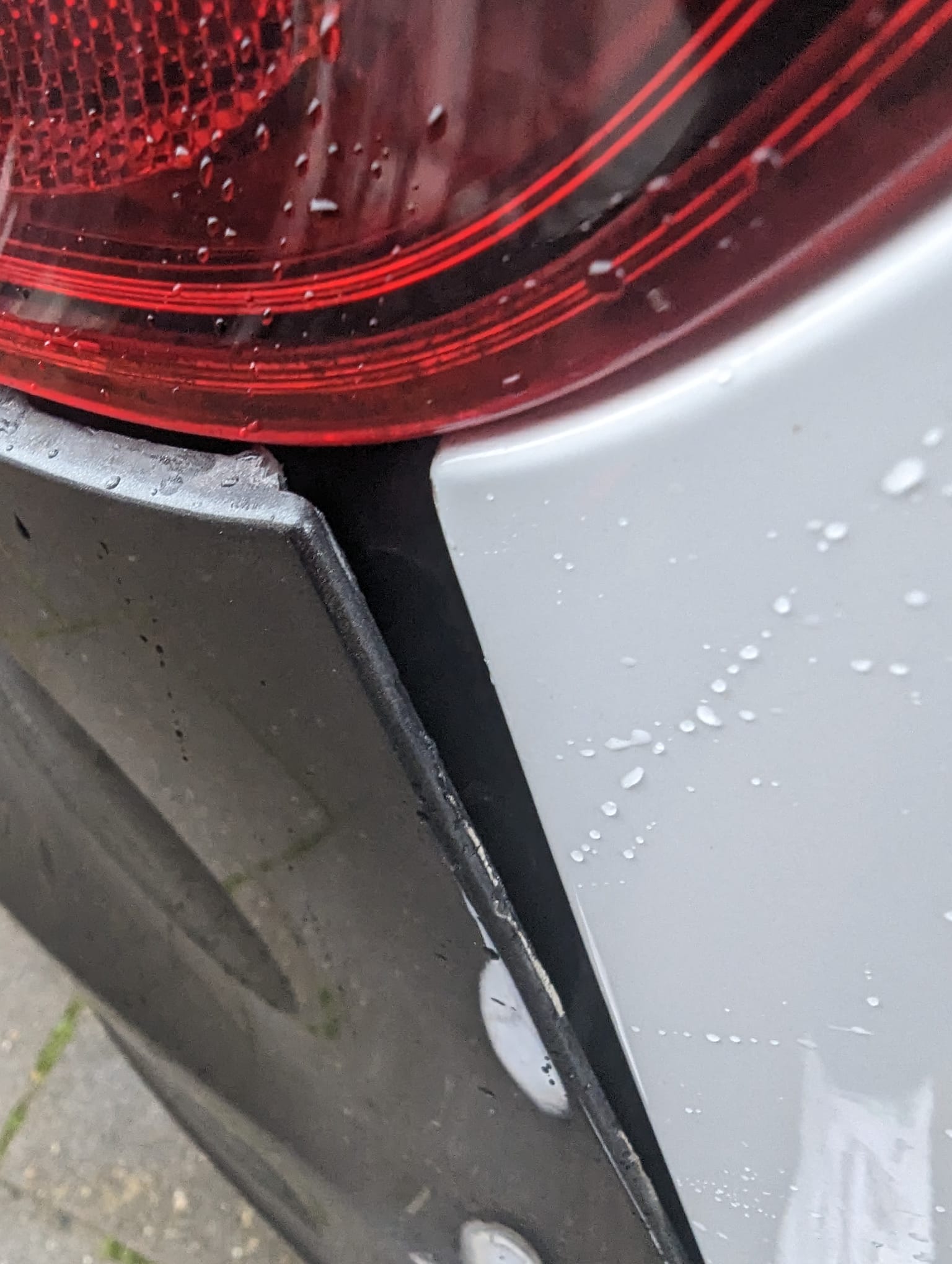

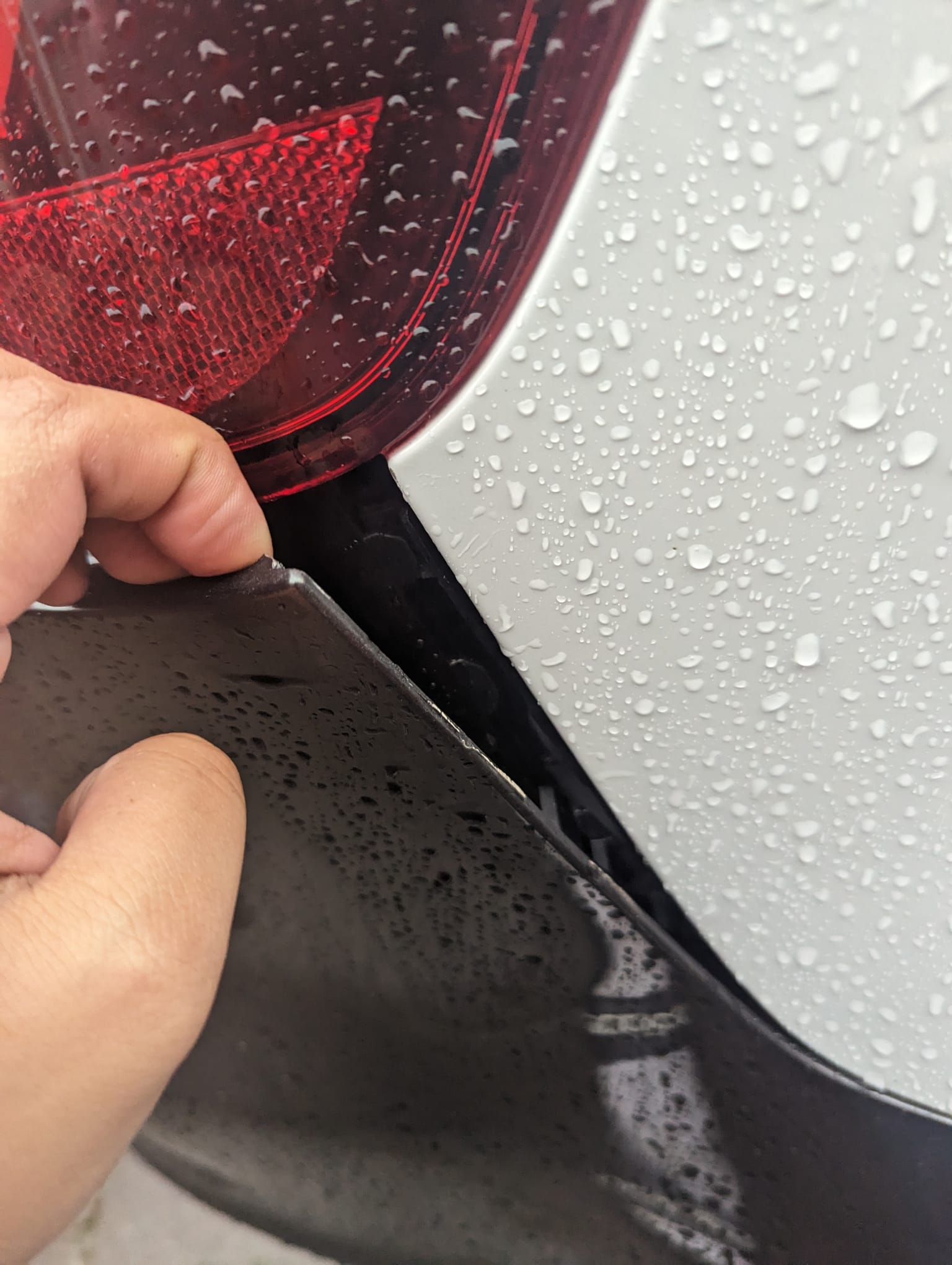

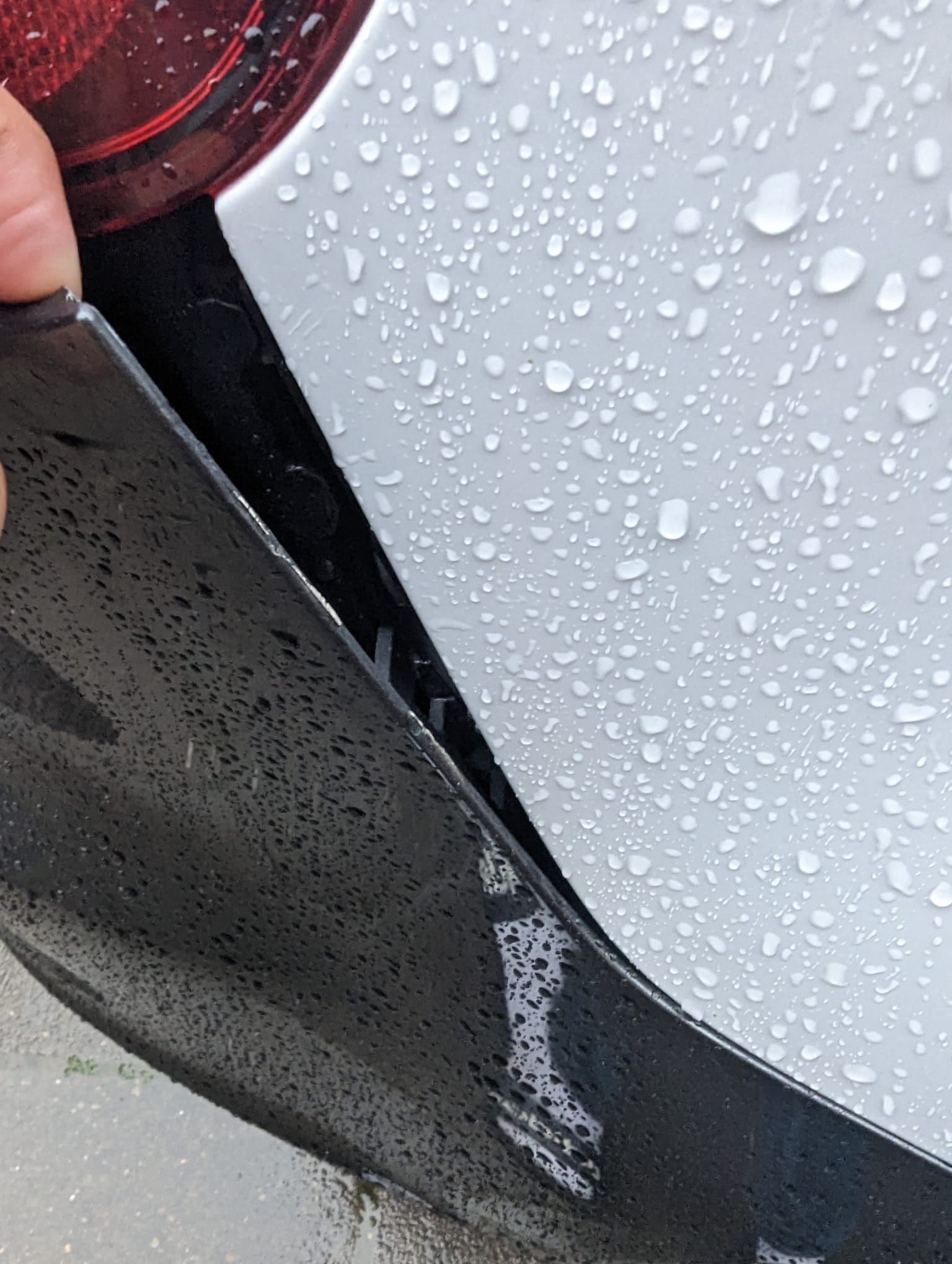

Hi All,
Unfortunately i've been fobbed around by a bodywork shop that i rejected a quote for them to do some work on my car(respray)
They have clean cut one of the plastic tag/clippers on my bumper which means it doesnt full slot into the bracket on the car. Does anyone know if this can be repaired or if i have to get a new bumper? pics below.
Any advice would be appreciated.

Hello Roshy,
Even a secondhand ( and probably damaged) bumper is not going to be cheap.
My way forward would be to get a new piece of plastic fabricated to match the others and get it plastic welded on. Any reasonable bodyshop should be able to do that.
Thanks for the response,
Amazing website, @Magnet you read my mind mate, i actually have my spare damaged bumper at hand and all the clippers intact. I plan to cut a section out for the body shop i will be using for my car work and have them weld it on and make it look spanking new after the respray! 😄
Regards
R0shy
