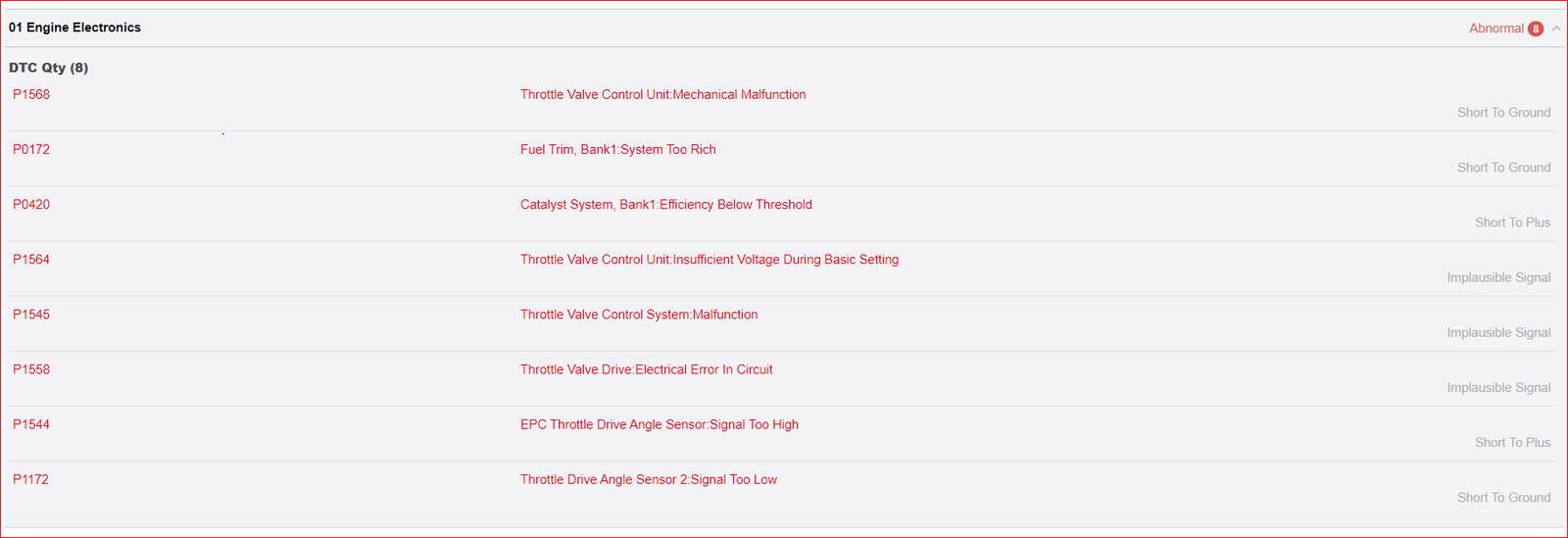

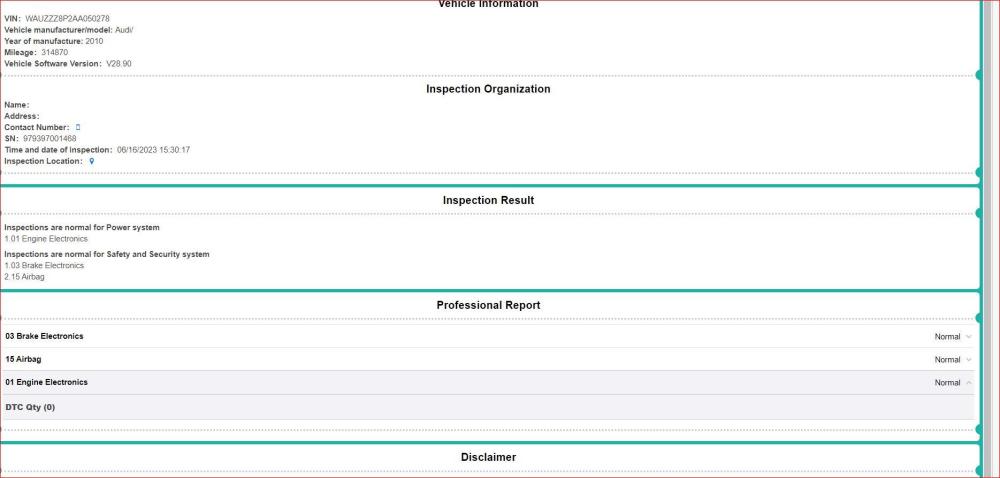

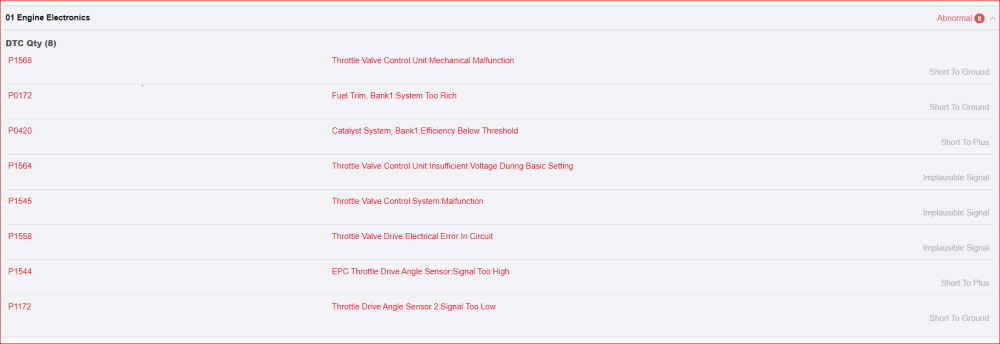

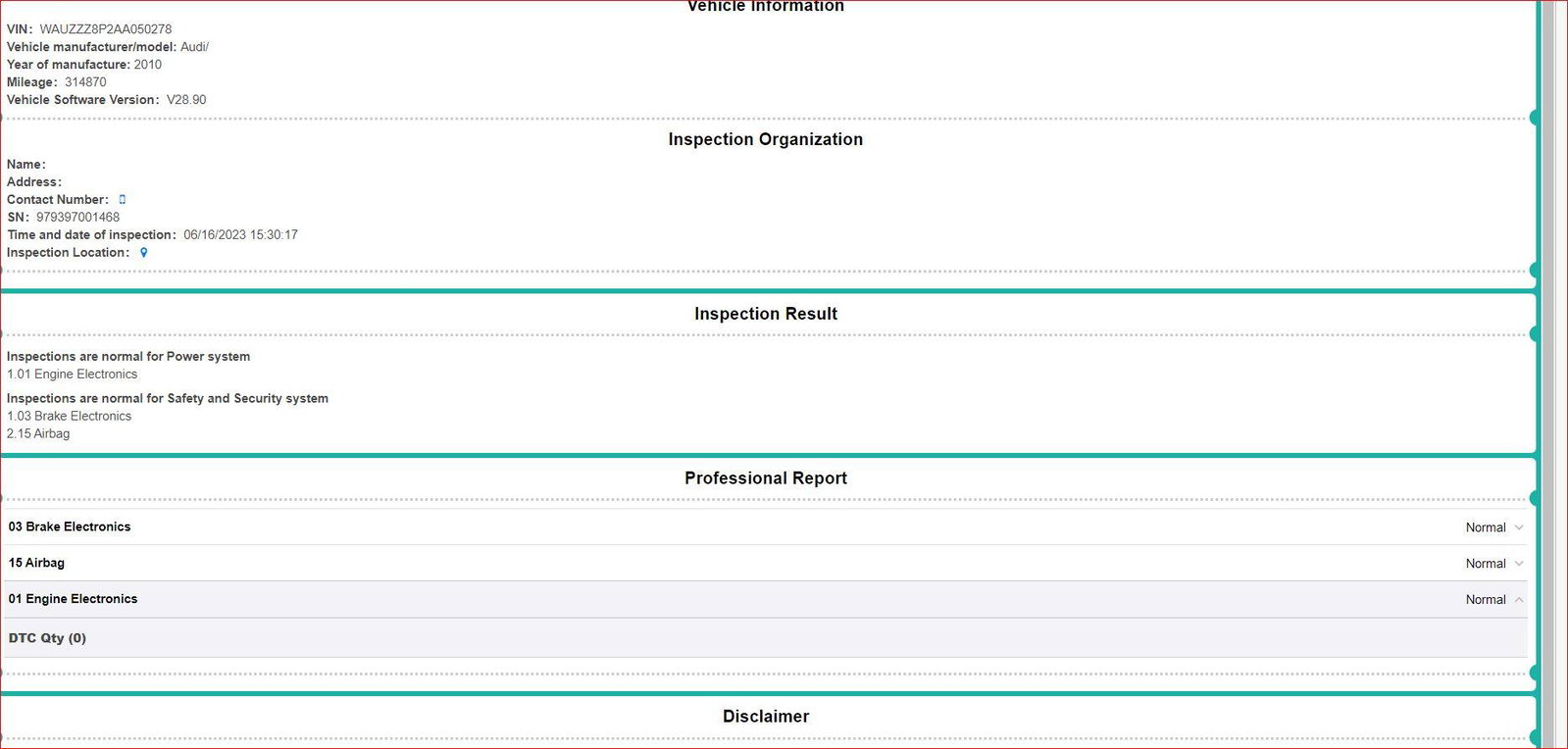

so I changed the Throttle body and the old Manifold had a crack in it so I changed to a new Manifold
No Steve no rough running at all, I found out tonight the even at 90deg it still did it , I feel it could be ? the inline fuel filter ? or fuel pump ? or ECU  ? .
