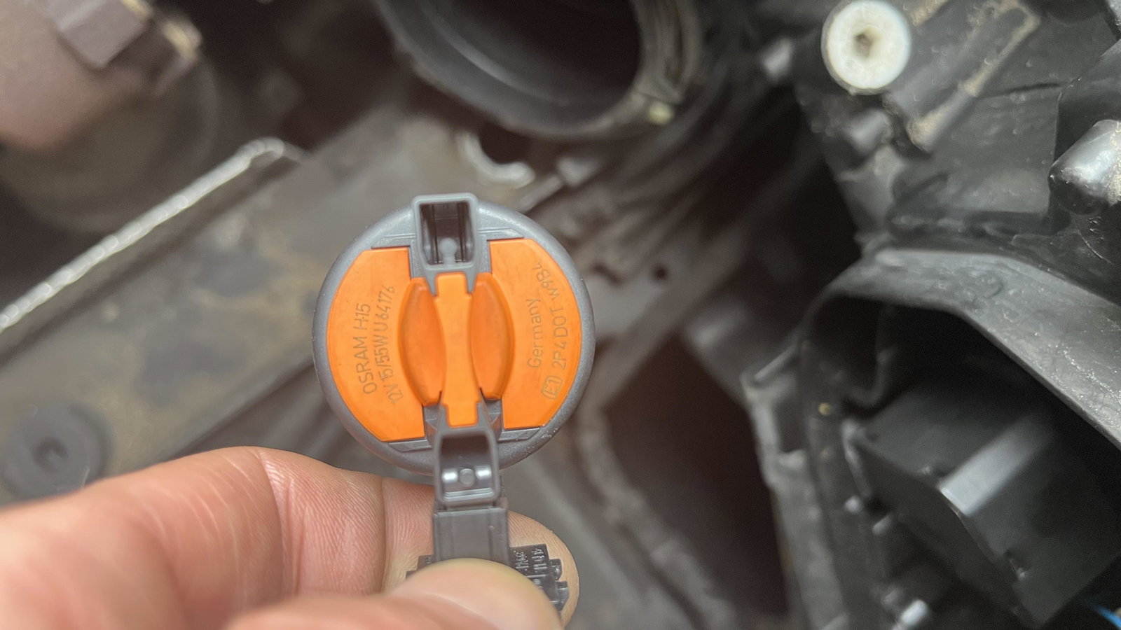

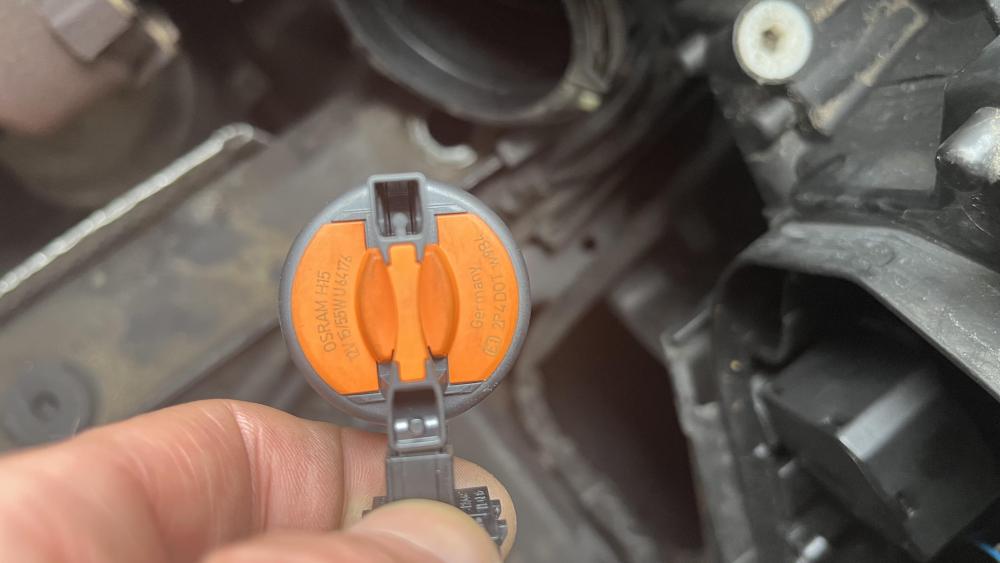

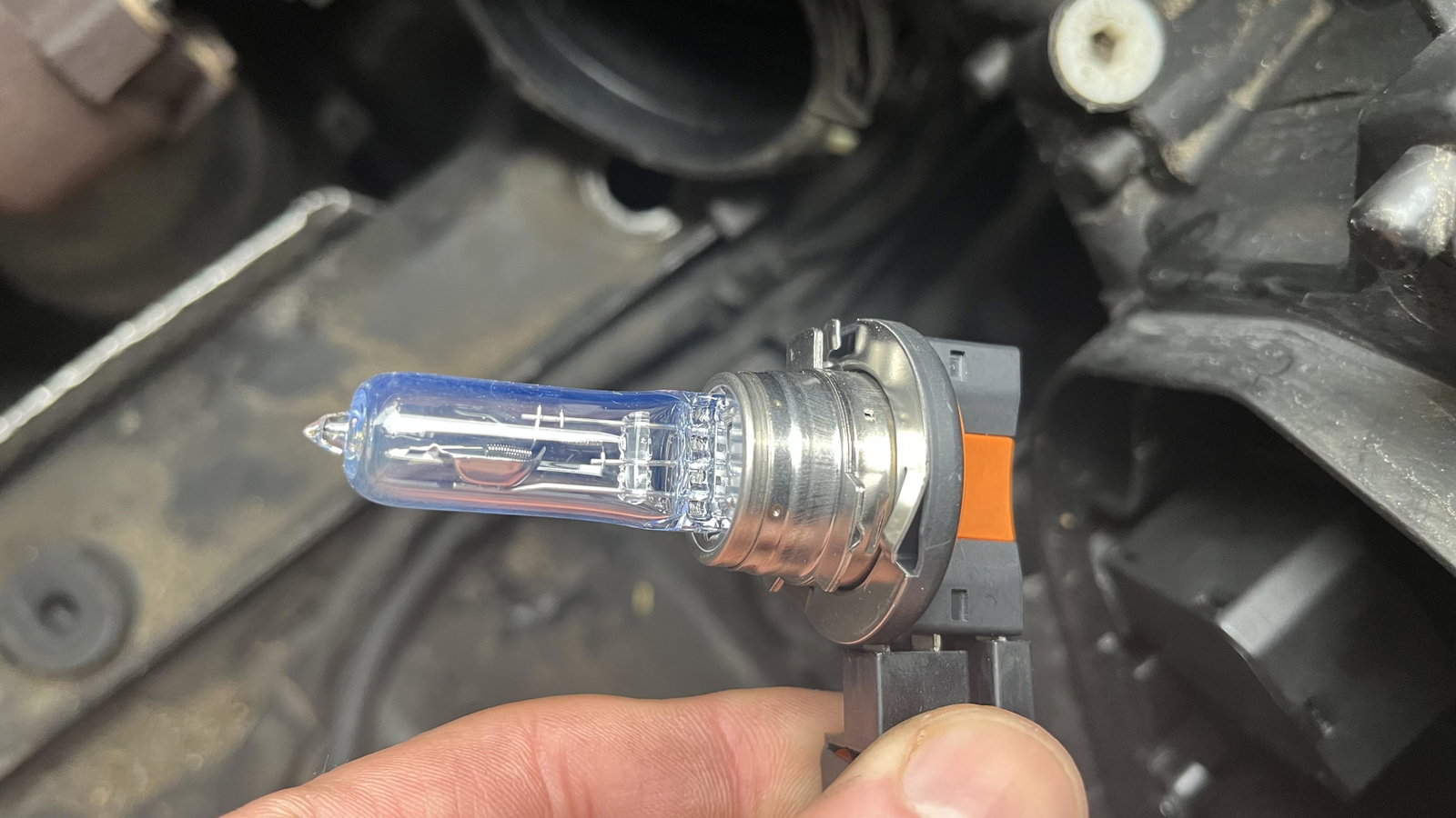

-first weird thing I found is the bulb near the signal one is an h15(img 7378 & 7379) with 3 pins( when looked at halfords it says it should be h1) and other websites too. Being rare, Some decent led cost ÂŁ45 on amazon, can i change them back to h1?

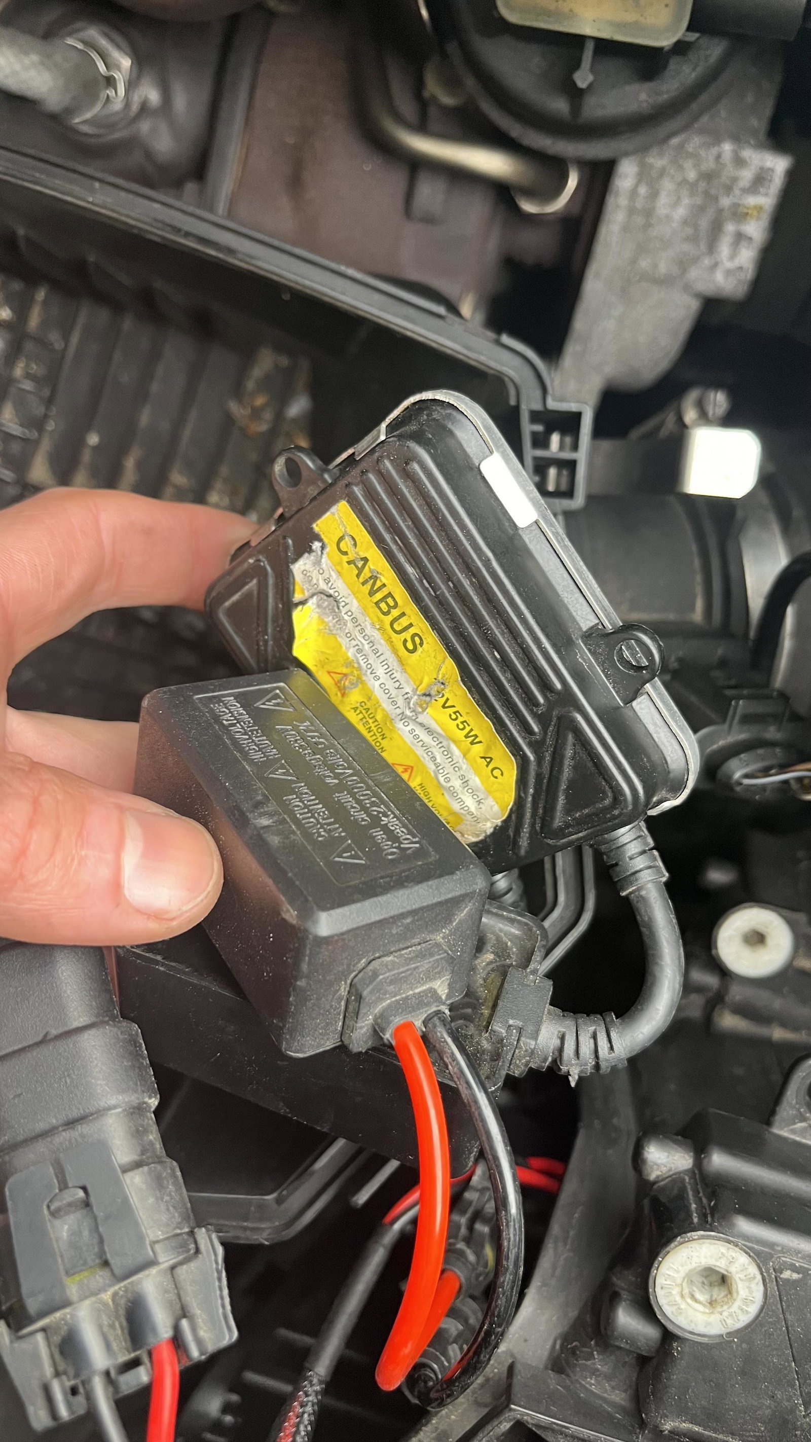

-second thing, the h7 halogen were upgraded to an old xenon version with a ballast device and 2 other mini power units(img7368) or something, is so complicated with all the cabling and things i am not even sure i can ever fit them all back inside, so i decided to switch to led, do the leds from amazon, need any other type of conversion? Do i need to use the ballast from the xenon ones? Or something?
