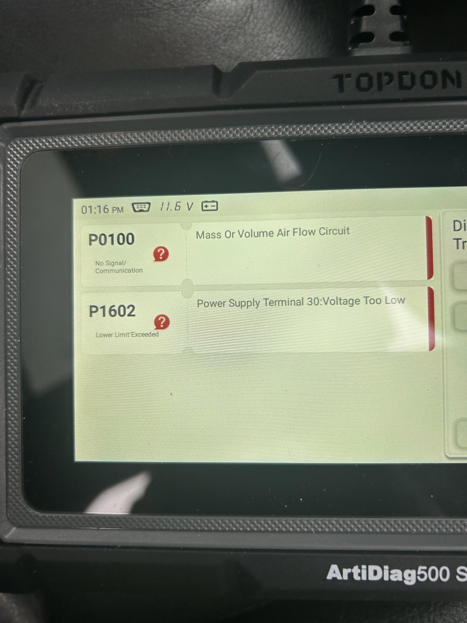

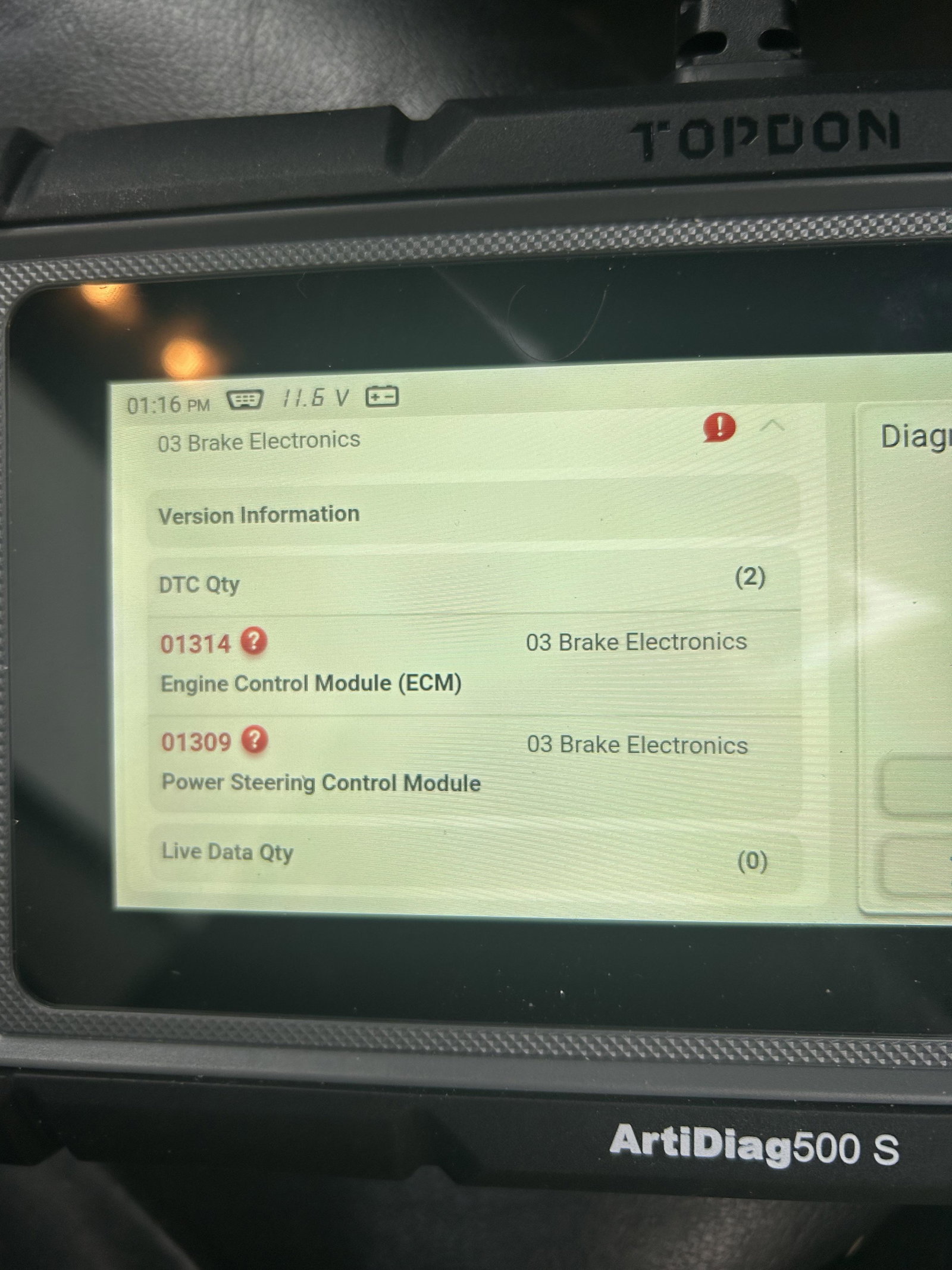

doesn’t start,cranking sounds like low compression so put my diag tool on it.
only a few faults, 01314 & 01309 in brakes..
low battery terminal voltage in engine (replaced battery)
so I did a compression test, the cheap Amazon kit was used, no compression on any cylinder.

when I run a diagnostic check it flags up these
but like I say the compression test is o on all cylinders also
I’ve checked wiring and fuse box etc
replaced the ecm relay also
I feel there’s 2 issues with this car,ecm n possible head gasket
I put on a brand new battery as the old one was totally dead..
the faults do clear except steering light but I’m not concerned about that at this point..

only engine fault on the diagnostic machine is air flow meter but I have that disconnected.
