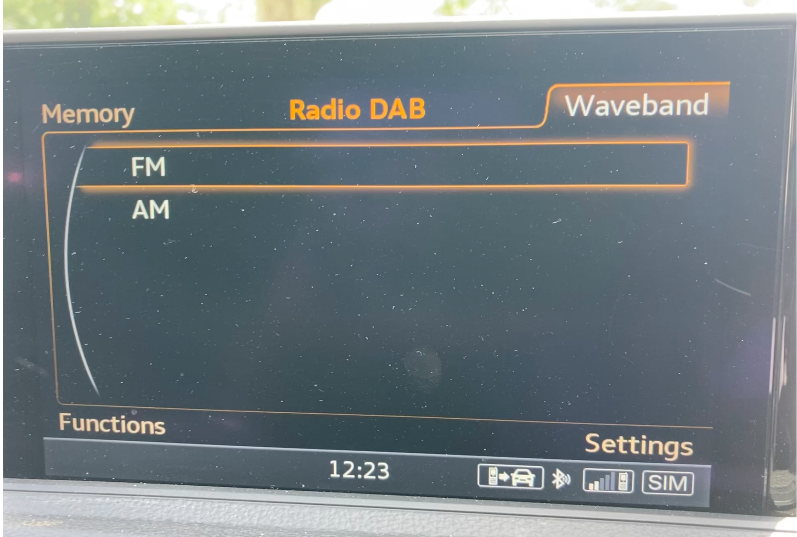

Thank you Richard. I can't seem to be able to navigate to a list of all stations ?????? I can get only as far as here.......... confused !
From that you it looks as if you don't have DAB on the set despite the DAB bit at the top. That suggests to me that you might well have a fault with the MMI or it isn't a DAB capable set. Have you had DAB reception in the past? There was a known software glitch in the 2016 A3 a few years ago that meant DAB just disappeared. Unfortunately it is a dealer only solution.

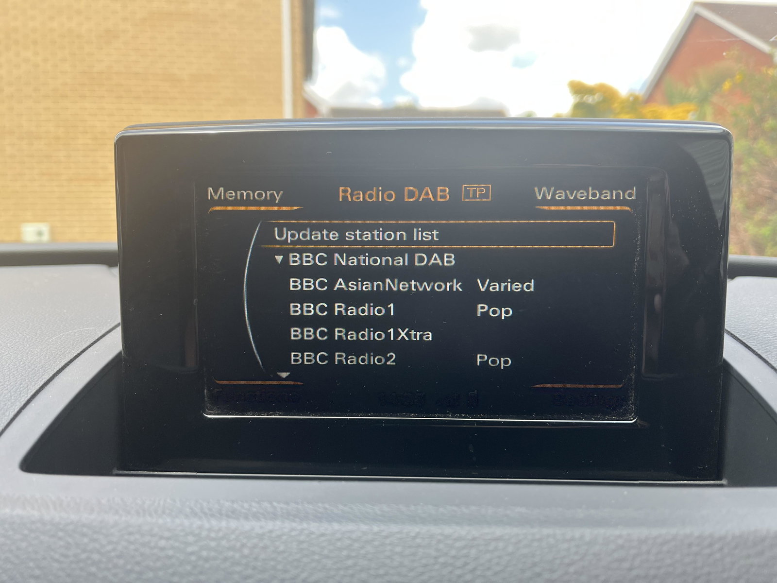

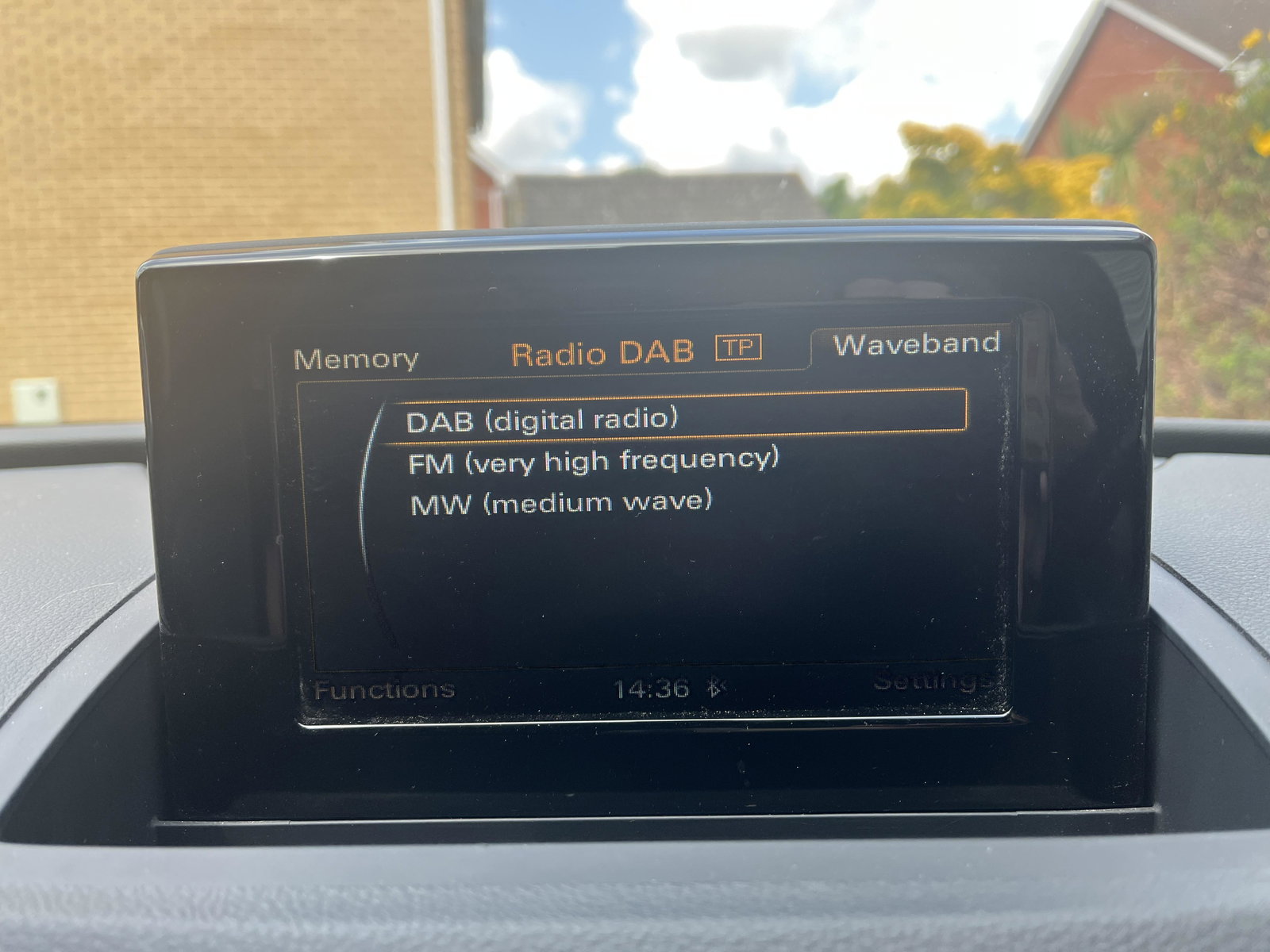

Anyway on the Q3 the process is to go to the Waveband option and select the waveband you want. Here mine shows DAB, FM and MW (aka AM) as available.
From this screen select the waveband you want and the update station list option is at the top of the list. I've selected DAB and as you can see the update option is there.
Thank you Richard.
I very much did have DAB for three years then it just dropped off suddenly in March or April. All of my saved DAB Radio stations still exists in my 'Memory'. The coincidence of me losing my DAB when everyone else did is too great to ignore, but perhaps it IS the DAB antenna ???? So that may be Audi Barnstaple and a large bill then !
Your help is much appreciated, thank you.
I have just downloaded via the SD drive in my car a software 'patch' created by https://www.vagcarcoding.com  This solved the software fault. DAB now fully operational.
