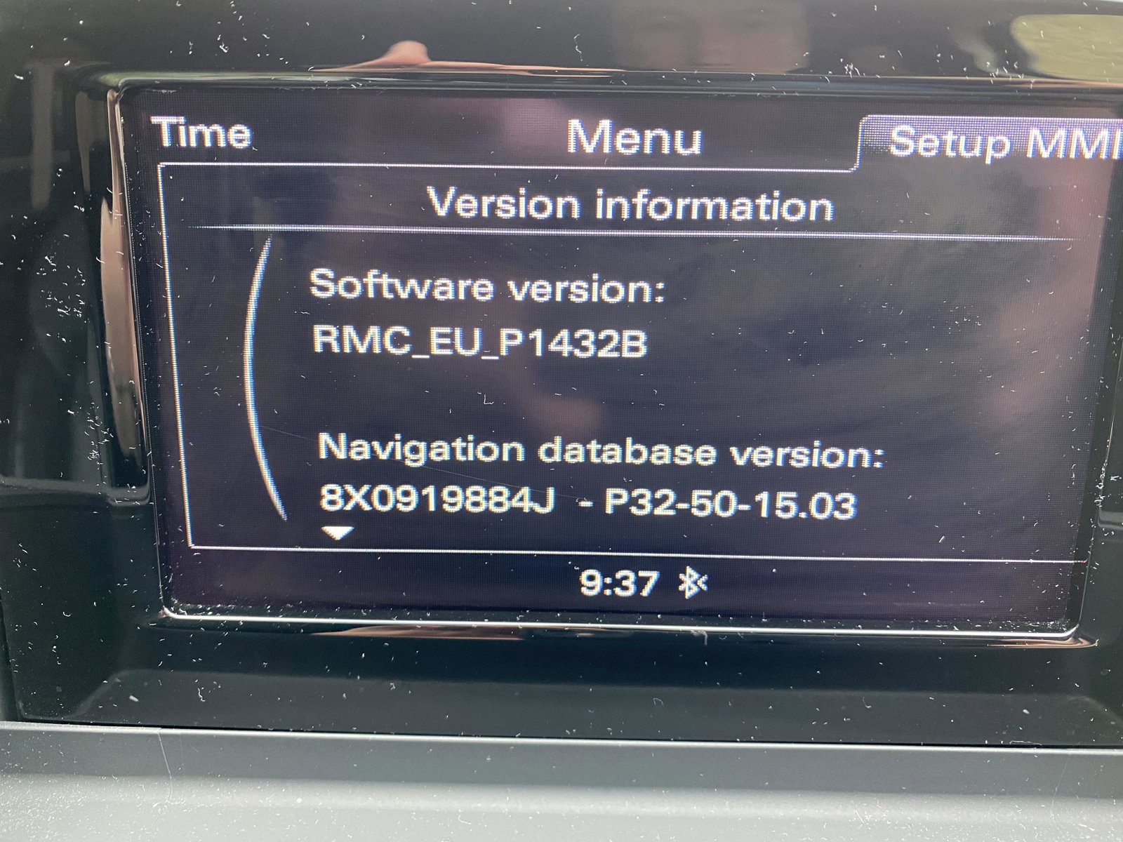

    The solution is, all RMC HW H61 needs to be :- 1. Firmware updated to enable DAB+ decoding  2. H61 swapped for a DAB+ working version. The vehicles affected were sold as DAB+ ready.

Same issue, our A1 went in for a service and MOT - they must have updated the version then. So far we’ve figured out it’s just the national DAB stations, local ones work fine. Only commenting to try and give a bit more proof that it’s Audi at fault! Thank goodness for this thread, we were running out of ideas! Same software version as previously mentioned: P16342
Just to remind you all.
All of us have the exact same MMI
That being RMC HW H61.
That MMI was only installed in A1, A6 and Q3 between 2015 and 2018.
It angers me when I read that Audi are telling us that the vehicle is not the issue and it is Bauer media. Let's not forget that Global also switched, so it isn't just Bauer media.
DAB+ is DAB+. The issue isn't Bauer or global using the wrong DAB+.
The issue is 100% Audi. They have either installed and programmed the chipset incorrectly or they have missed something when it came to adding the mpeg4 audio codec to allow is to listen to the DAB+ frequency.
Audi also have it documented that out RMC MMI is DAB+.
There are earlier models of our vehicles that have RMC MMI installed but that HW version is earlier than HW61.
HW61 should be recalled and corrected to match how it was marketed, that it is DAB+
