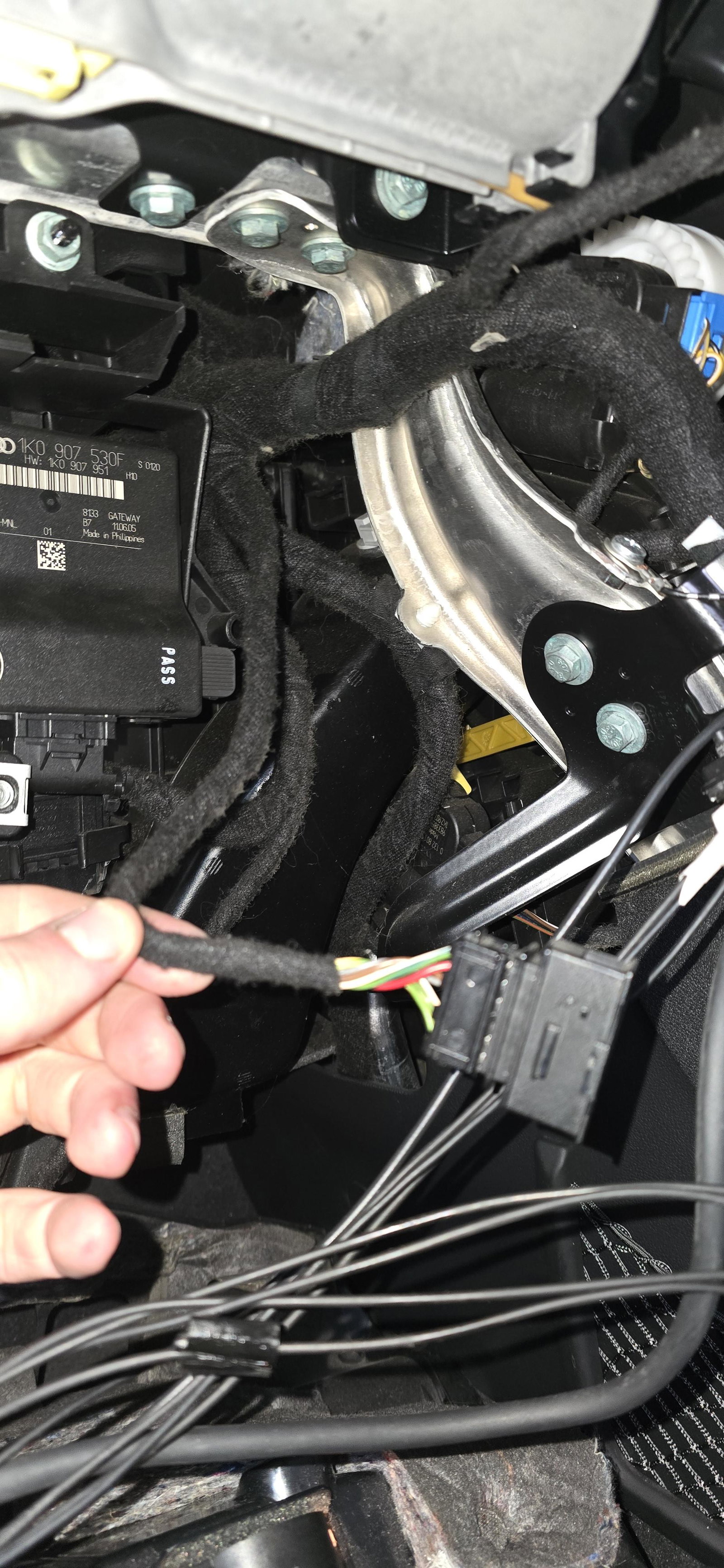

dannyanny246 Posted May 6 Posted May 6 Hey everyone. Im new to the forum and to Audi's in general so i apologise in advance if what im saying has been mentioned before. Iv recently purchased a 2006 8P A3 with a 2.0 FSI petrol. I got it cheap with some jobs needing doing to it. Im located in New Zealand, this car was a japanese import(yes a bit odd). And it came with a japanese head unit that was useless. After i had the car mostly sorted and ready to go i thought id throw a new head unit in. I then found that the japanese head unit had about 20 kilometres of extra wiring added to the original loom. Stupidity i left the ignition on for the hours i spent untangling the mess. And when i finally had it working and went to start the car i got a battery warning light and a very slow crank. Iv only ever driven "older" more basic japanese cars and 4x4's so i instinctively hooked some jump leads on and fired the a3 up. To which i was met with a engine light, power steering light and a esp light. I plugged in my cheap obd2 scanner to find the fault saying "lost communication with tcm" i cleared the code and found that the other 2 lights might just need a drive to sort themselves out. So i went to go for a drive. But, the car is stuck in park. I found the emergency release, and once released the car goes into gear but with a sizeable clunk. Iv spent hours checking every fuse in the engine bay and the dash but nothing was blown. Im totally stumped now. Is it possible that iv done some serious damage to the TCM or could there be another fuse box that i could check? Any help at all would be really appreciated. Auto electricians aren't cheap so im doing my best to try avoid it. Thanks in advance

dannyanny246 Posted May 9 Author Posted May 9 Just re installed the old head unit. Unfortunately no change.
