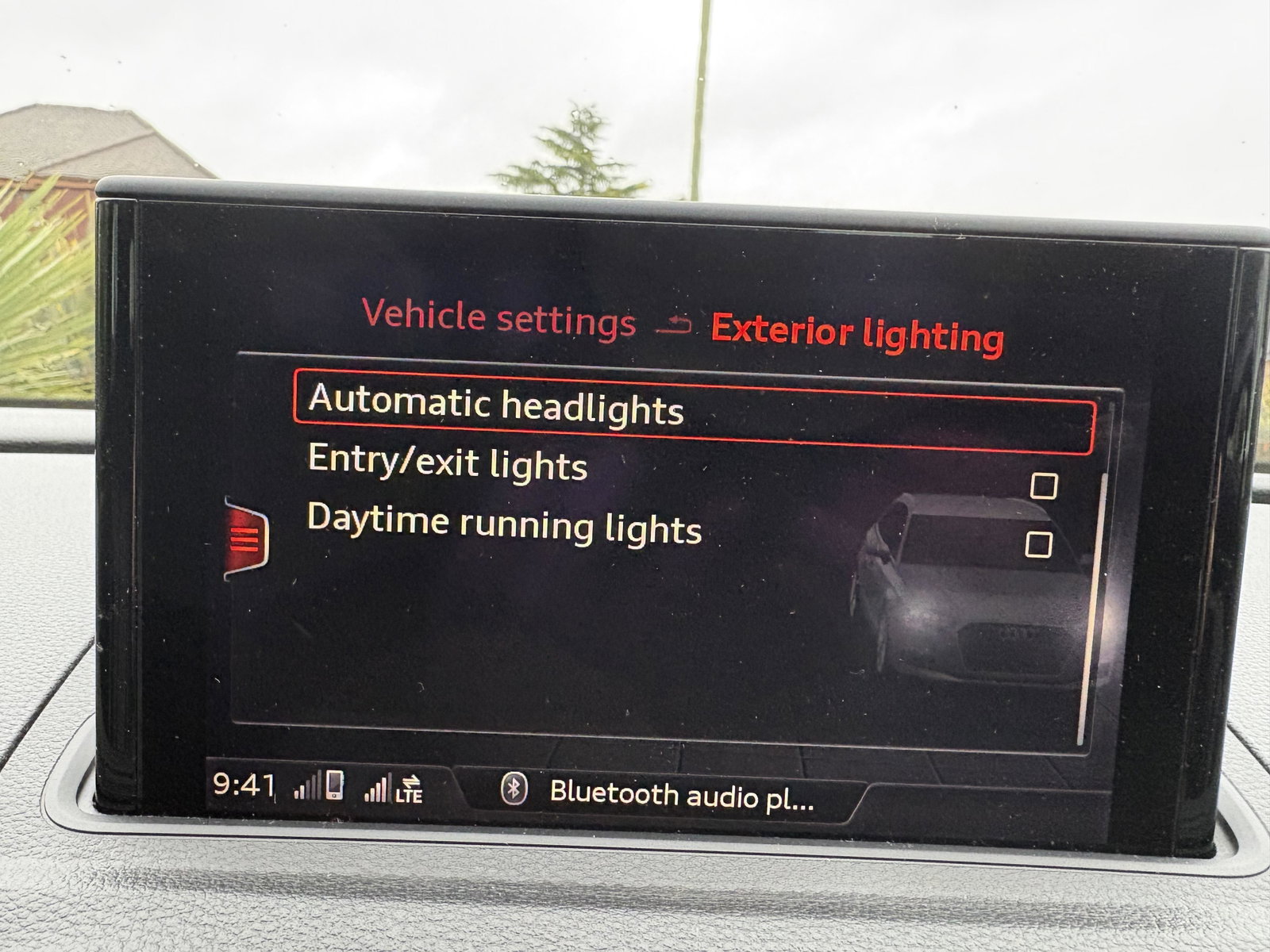

I guess it depends on what you use it for. VCDS cost me over £200 but I do all my own servicing and have a few VAG group cars so it’s been worth it. Good info on the DIY fix BTW. Appreciate the legalities of DRL’s and I’ve been driving for a year with them off and not had my collar felt. This is what it looks like on my car after I activated it on the menu. Easy to switch them back on.
I dont have that option on mine.
Hi - You need something like VCDS or OBD Eleven to activate it in the MMI adaptations to get it to appear on the MMI screen.
