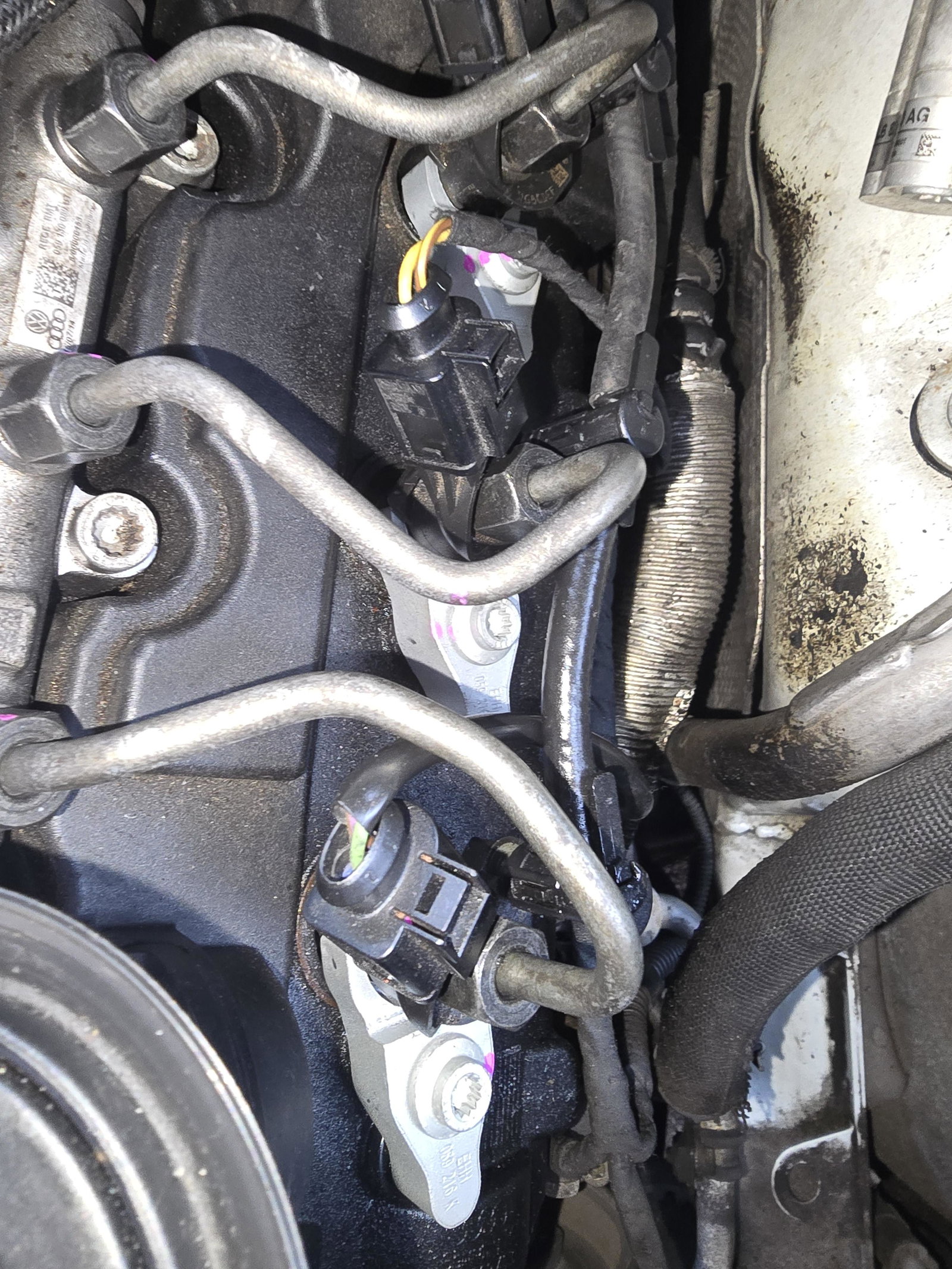

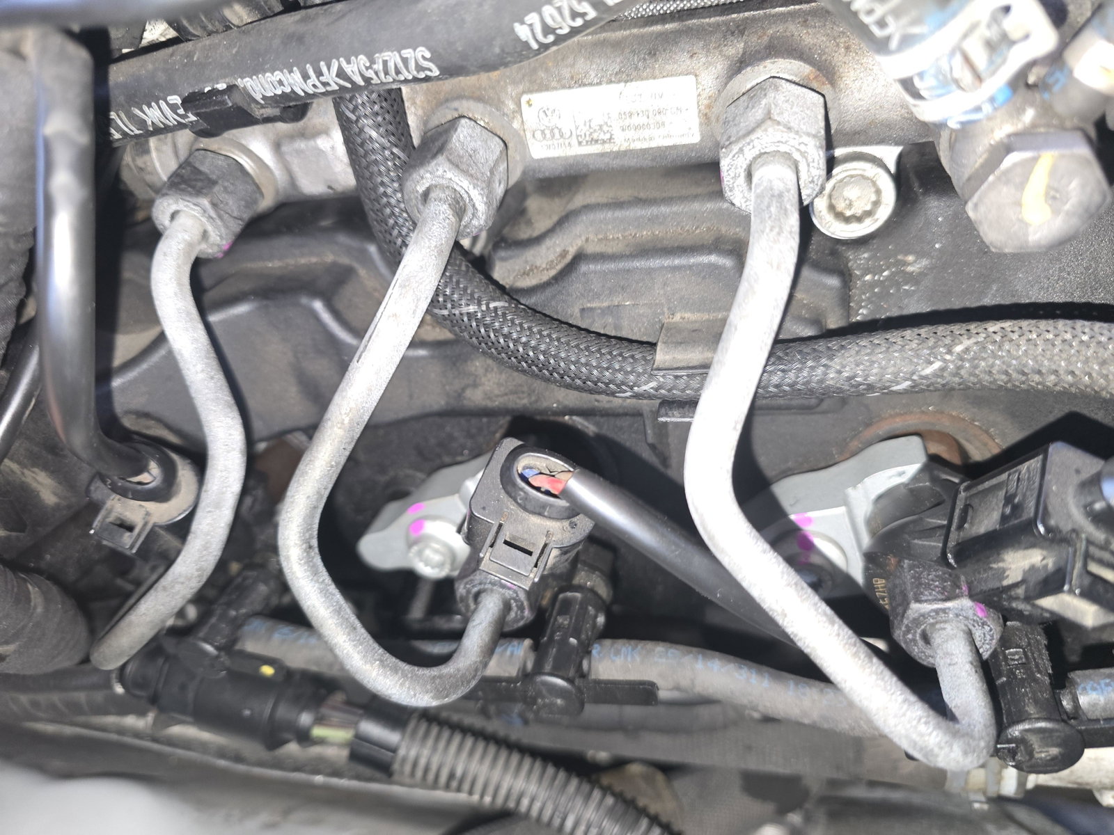

Had all 6 injector seals & o rings replaced, new bolts and new brackets £445 inc vat at midland vw
No more chuffing sound, they said all 6 injector seals were failed or failing and 2 dropped into cylinder head whilst removing so they had to remove head and re-fit.
Drove the car for around 40 miles now and all seems fine now 👍🏼👌🏼🤞🏼
