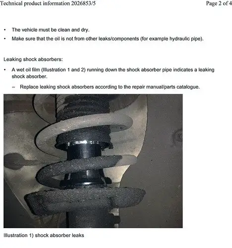

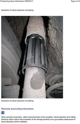

There was a VW tech bulletin in March 2018 that relates to misting on shocks. The tech background is that it's unavoidable as it's necessary for the lubrication of the piston seal. A minor film of oil on the shock absorber pipe is normal.
A leak will be clearly evident as it will extend into spring seat, accumulated debris from shock absorber oil and road dirt, etc.
