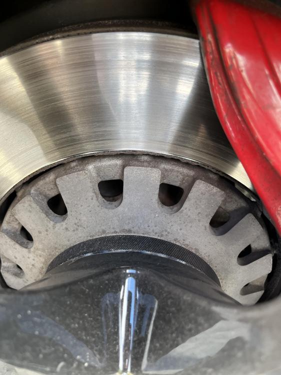

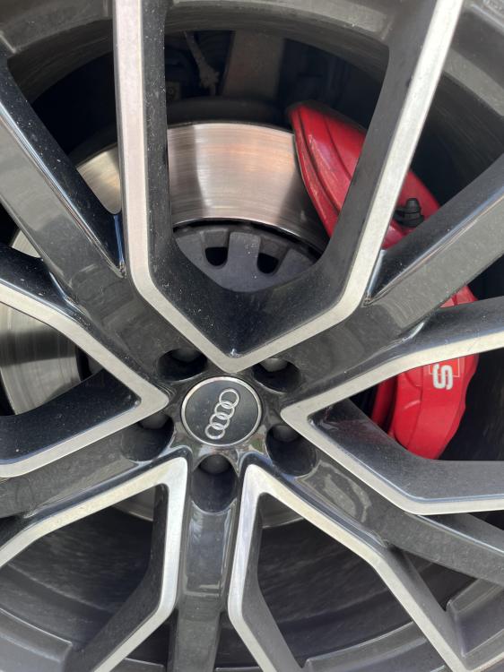

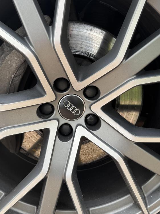

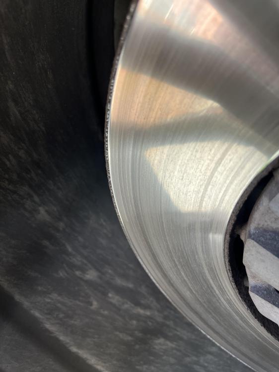

The discs look clean, front and back, I wouldn’t be considering changing if it wasn’t for the squeak. I might just chance a set of Brembo £150.
52k miles on them
How they look
They look fine mate.
That’s a tiny lip if any and perfectly normal.
I would fit new genuine pads to them and be done.
