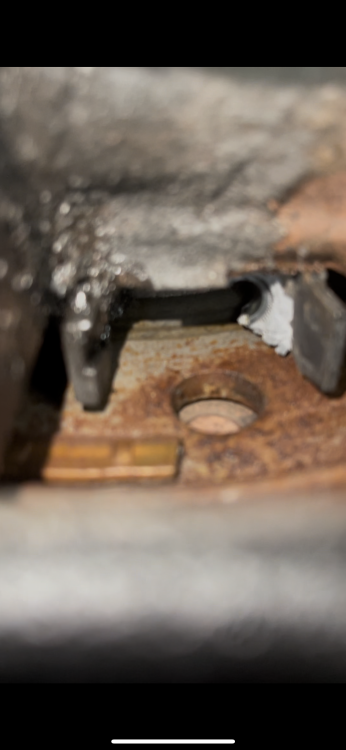

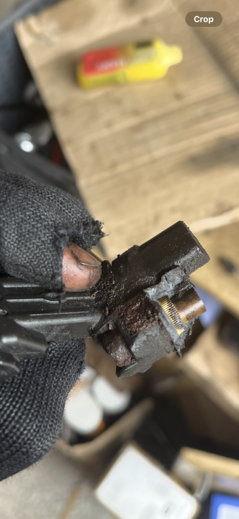

Crankshaft pos sensor bolt snapped crankcase sealing flange
So i was changing my crank position sensor on my 2.0TDI in hope it would fix my rough warm start issue that has been progressively getting worse for over a year, the bolt retaining the sensor was very seized and starting to round, i used a hex extraction kit and it removed the bolt with the sensor and snapped part of the crankcase sealing flange with it
14 hours ago, cliffcoggin said:
Ouch! That's going to be an expensive welding repair because it cannot be done in situ.
im going to remove the gearbox and change the seal flange, not what i was expecting to be doing when changing a crank sensor but oh well
