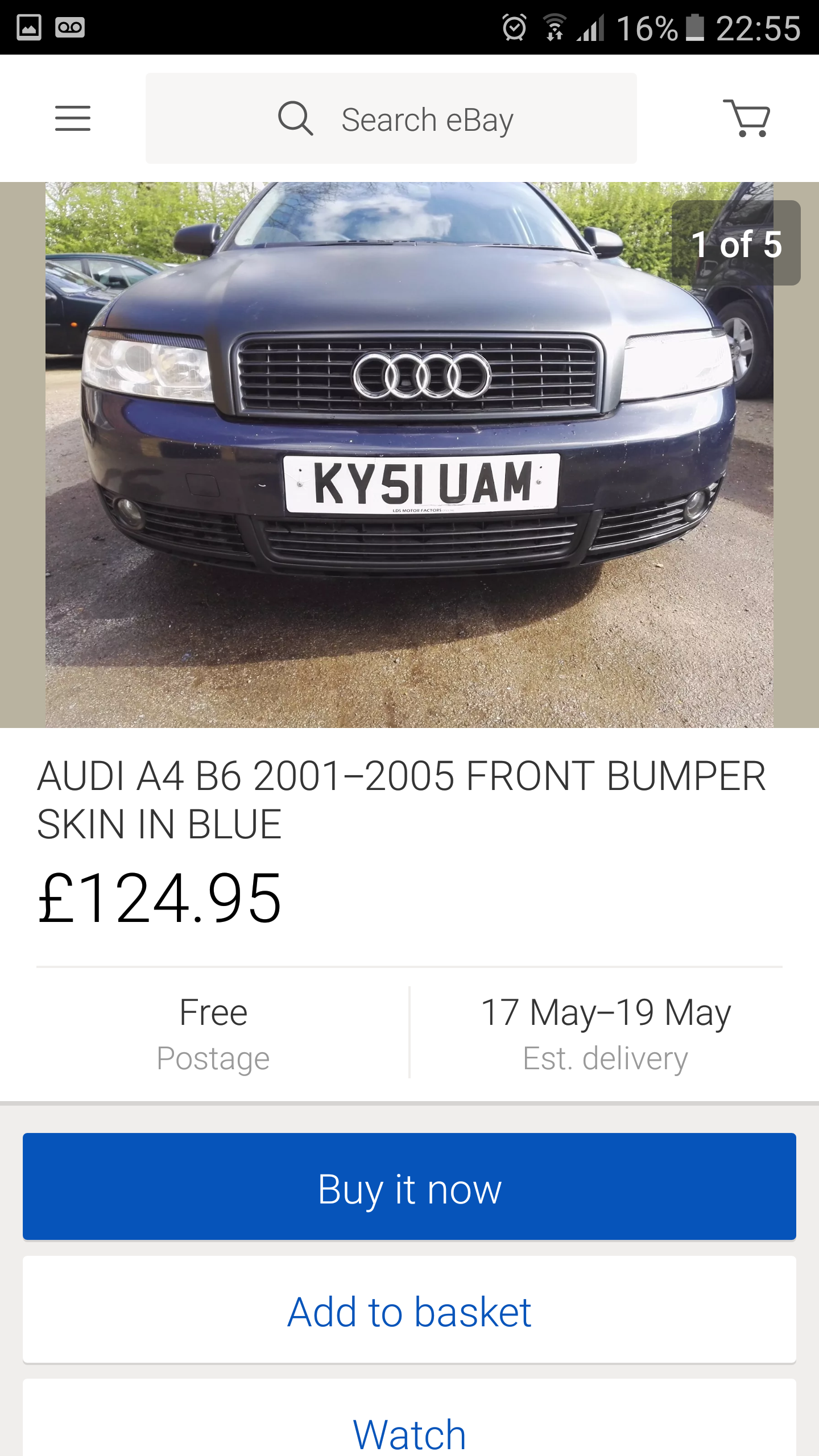

you could melt this back together (okay for plastic melting rods) or fibre glass it from behind. (I would do a little bit of both) but melting/welding it back together will be the least unsightly afterwards.
However, as it's not a rare colour you might find a half decent second hand one on eBay or try 247 Spares many others available!! You might be lucky and get one in the right colour.

Back to the problem :- I too agree with Dan's advice, and it's quite easy to weld the plastic back using a good soldering iron for example. You will be surprised how it will work out, particularly if you can introduce an additional bit of supporting bracketry.
Of course, Steve has a very good idea about trying to find a replacement which I guess will cost you less than your excess, but worth having a go at plastic welding it back in place first - nothing lost.
Good luck with it.
That is a good find Piotr!!
