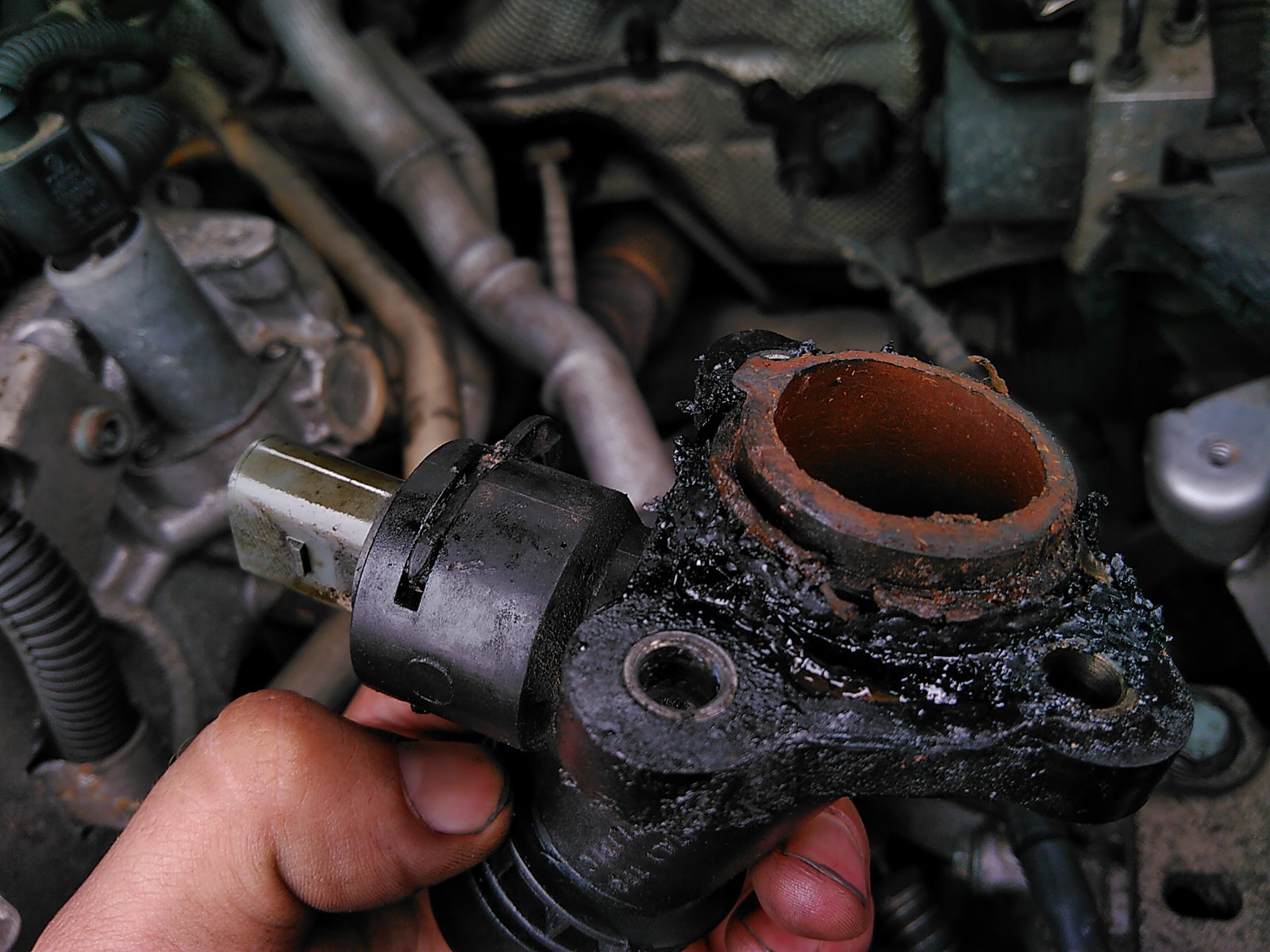

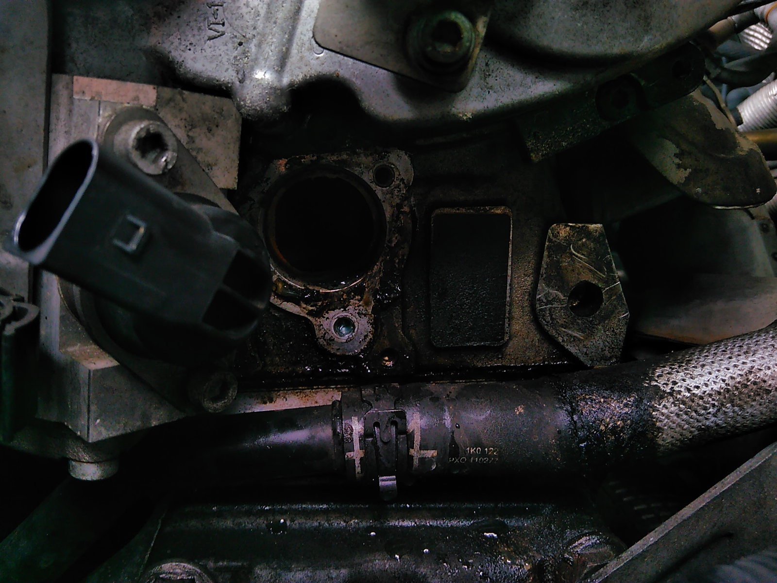

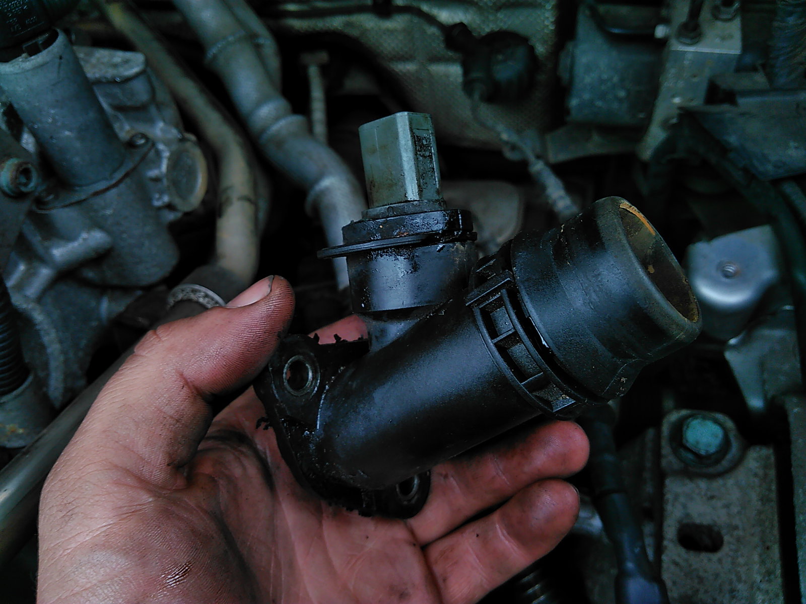

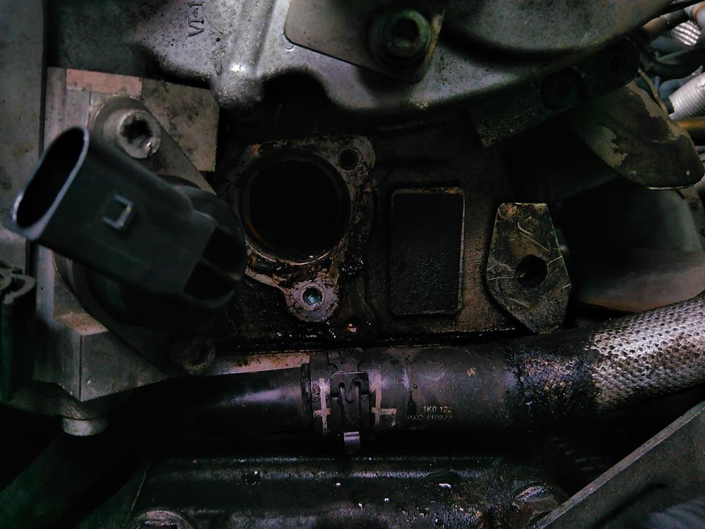

Got a couple hours free after work today so thought I'd have a quick look at the Audi..DSC_0426.thumb.JPG.2362b930e9cb7308a50cbda6de2e2512.JPG
Well I think I have found the water leak.. it's a small black connection pipe that houses the temp sensor, it's broken, bit has been broken at some point, removed, bodged and re fitted!! 2 of the 3 bolts weren't even tight, no o ring to be found anywhere, the lip that houses the o ring sat inside the head, and lots of black sealant..
This is the area I assumed the thermostat housing was, so I was right in a way of where I thought the water was coming from, looking like the head gasket is fine 😁

Nice to see some hands on stuff. Once you get that leak sorted I would be flushing the water system out. It looks like it's had a water leak product in it like rad weld for example. It could have been used because of this leak but alarm bells ringing for potential head gasket like you suspect!!
