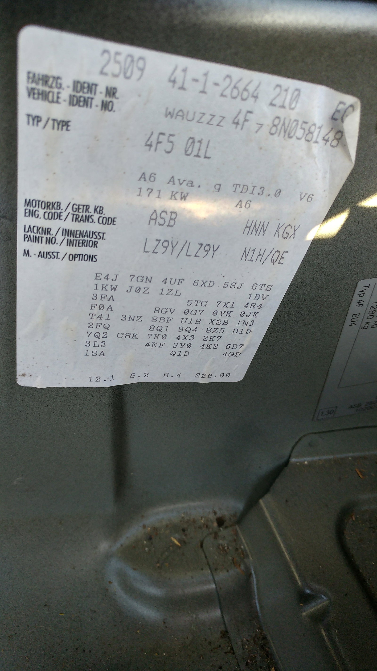

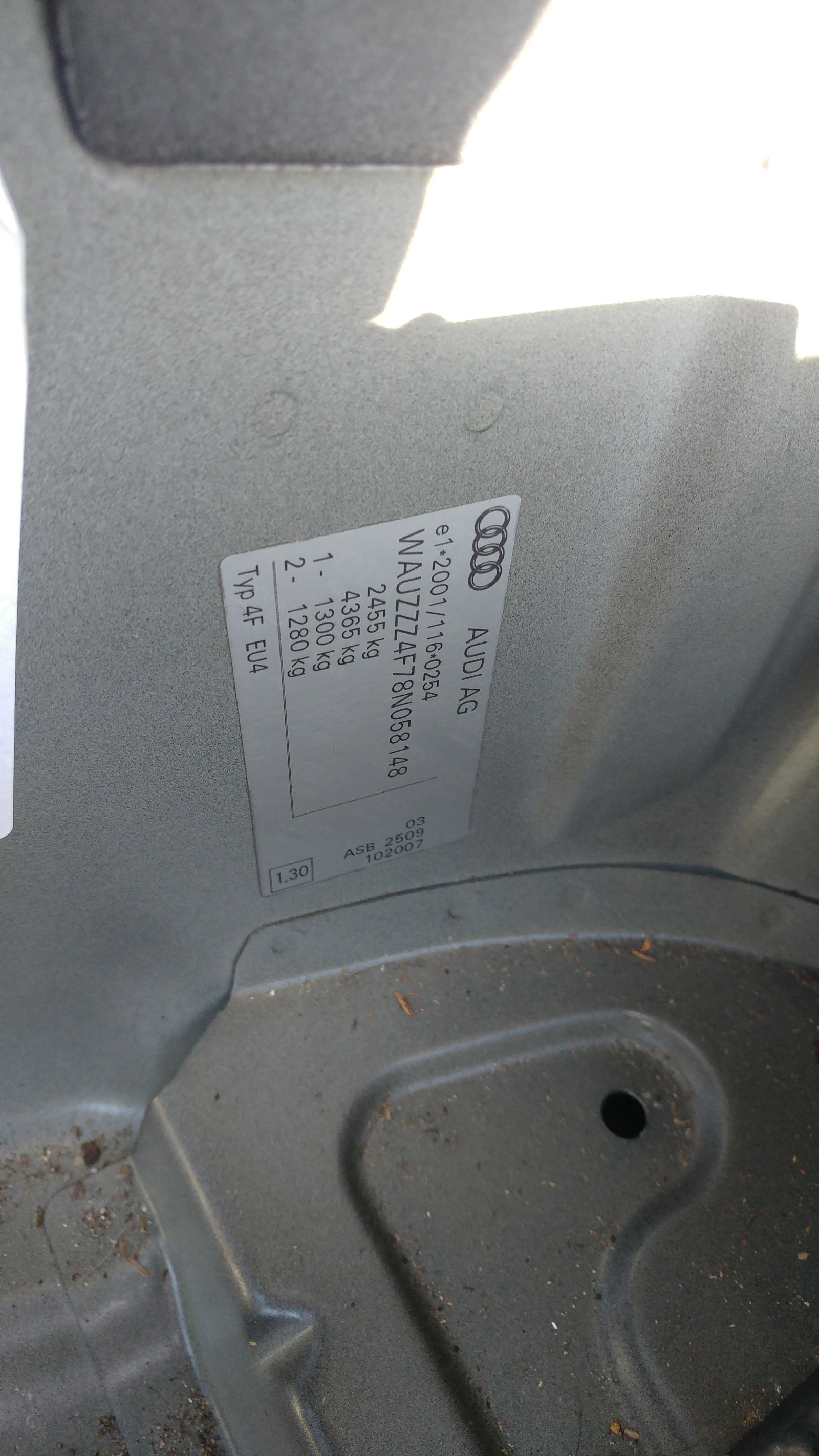

only stickers i have in my boot well are these

7gn on the build sticker . No dpf
