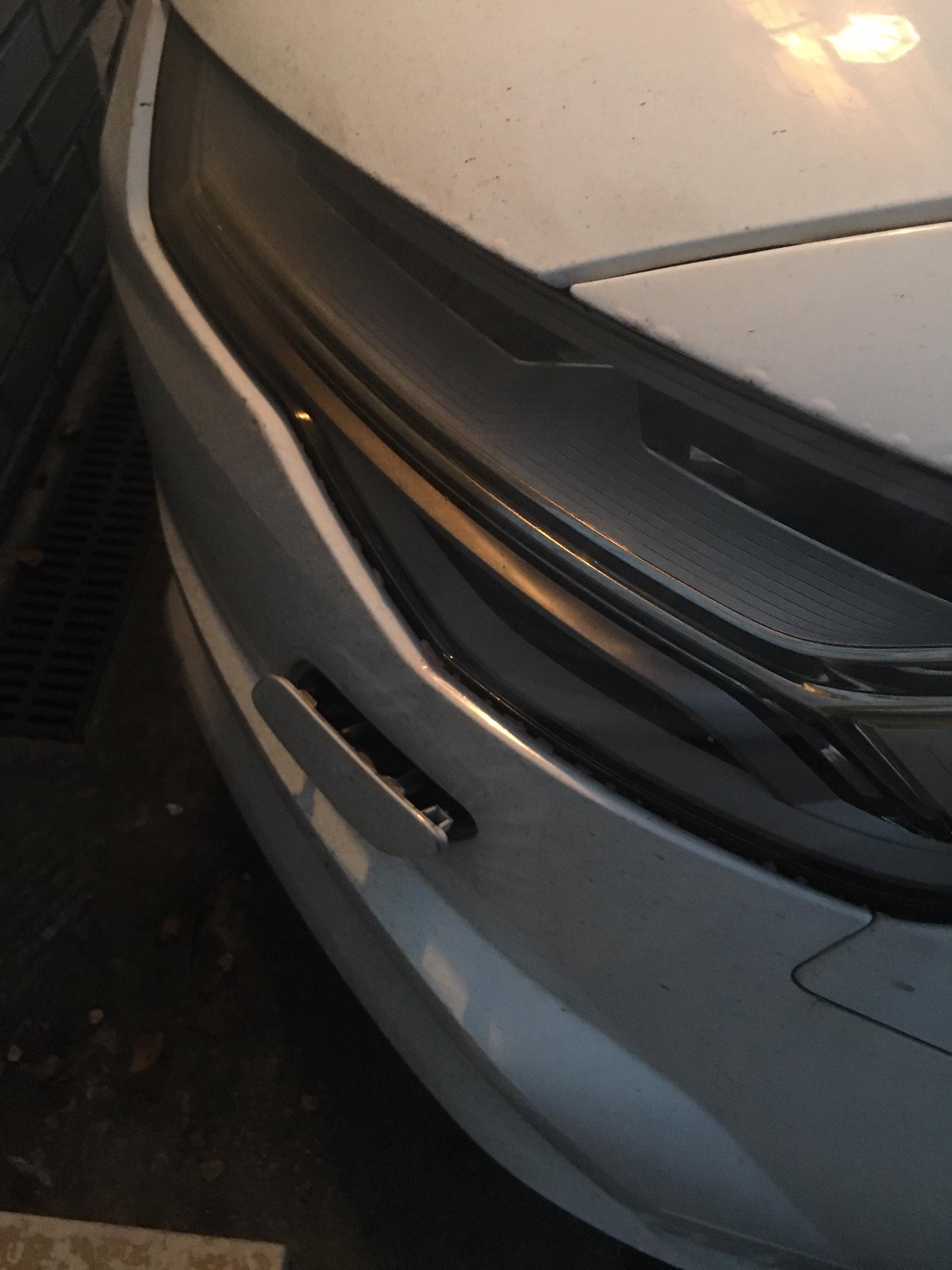

I've recently noticed when the outside temperature is pretty cold that the headlight washer jets stay popped out of the bumper, they do go back in once the temp. rises again.
Just curious to see if anyone else has noticed this and if there's anything I need to do about it?

I presume you are using screenwash that does not freez ?
Thanks for your reply, I didn't think about that 🙄
I have been using screen wash but now that you say that, I think I've probably not been using enough in it.
I have just noticed the same issue over the past couple of days. One question I do have is if it is freezing fluid then why do they pop in readily when prodded?
I accept that with wind chill included the temp may drop way below the stated protection figure stated on the SW Bottle but has it really been that cold?
I am looking into it at the moment. Last night was mild in the SW so I did not expect mine to be out this morning when I stopped for fuel but it was. I suspect  there is a grime build up on the slides the jets actuate along.
I can only assume that they pop out when the water freezes inside them as it expands and then go back in when the ice melts.
I didn't attempt to push mine back in, just left them to go in on their own when the temp. came back up and I've not had any issues since putting in a stronger mix of screenwash.

You've done right. Pushing them in could damage them. It's all because the water freezes in abd around the washers.

Note I did not push the washer back in - as soon as i prodded it - it popped back in.
So fault is persistent even during milder weather. Drove back from Reading Sunday evening - outside temperature was around 10 deg C, pulled up at home and there it was sticking out again.
Have booked the car into Audi Bristol on Monday for investigation. When they told me the soonest they could see my car was Feb 15th I did raise an eyebrow. Did mention Car was last serviced by them and this is a warranty fault and the wait time reduced from 1 month to 1 week.
Will let you know the outcome.

Have you tried a stronger solution of screen wash? Since niedzial mentioned that I put in some stronger mix and it's never happened since 🙂.
That's good you have it booked in, eventually. It's amazing what they can do when it suits them 😉 Yeah, let us know how you get on with it.
So Audi Bristol had the car yesterday. Turns out it was grime in the mechanism. It's a fairly complex  assembly just to spray fluid on headlamps and this is possibly its downfall.
In my defense and answering the question - I always use concentrated screen wash with "claimed" protection down to -15 Deg C. This is not only for antifreeze properties but also for an effective non streaking clean.
While it was in Audi they also gave it the inspection treatment. Front tyres down to 3.6mm, Front brakes 70% worn and all three wiper blades needing replacing. I am beginning to think they think I am a lottery winner. £98 for wiper replacement. Near £600 for front brake renewal and around £450 for 2 new front tyres that do not need changing. I suppose grand surroundings require grand invoices.
