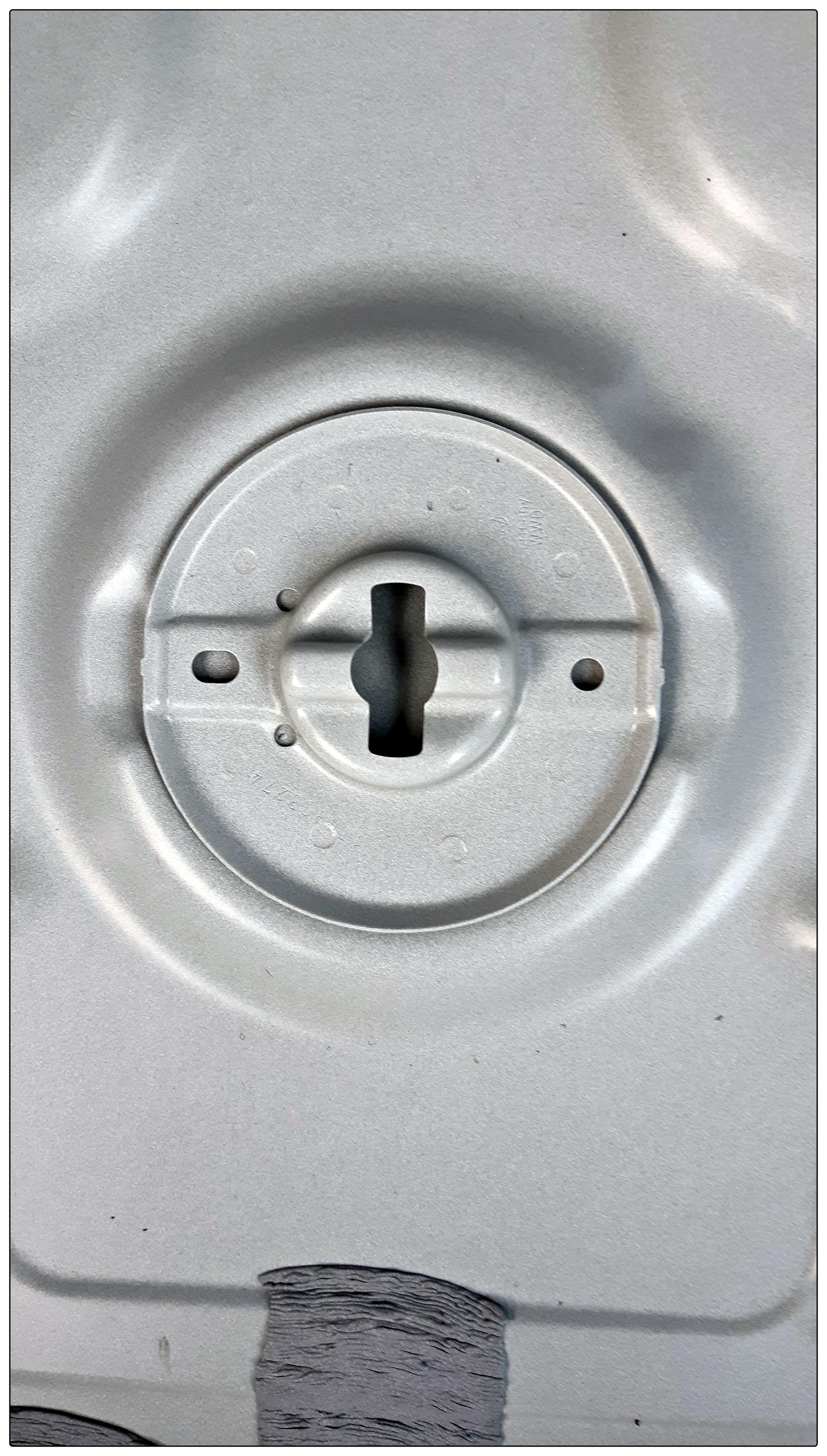

B.P.Dtephens Posted November 13, 2019 Share Posted November 13, 2019 On 11/11/2019 at 9:27 AM, james brown said: Wanted space saver spare wheel for. Audi q3tfsi 35.auto year 2019 .Where can I purchase and what price. There is a mystery about spare wheels.When I bought my 2019 Q3, Audi refused to supply it with a spare wheel. I note that you can buy a suitable low profile spare wheel from another supplier but they can not provide a fixing bolt for this car. My car has a strange fixing arrangement and I don't know how to make use of it. Anyone have any ideas? Quote Link to comment Share on other sites More sharing options...

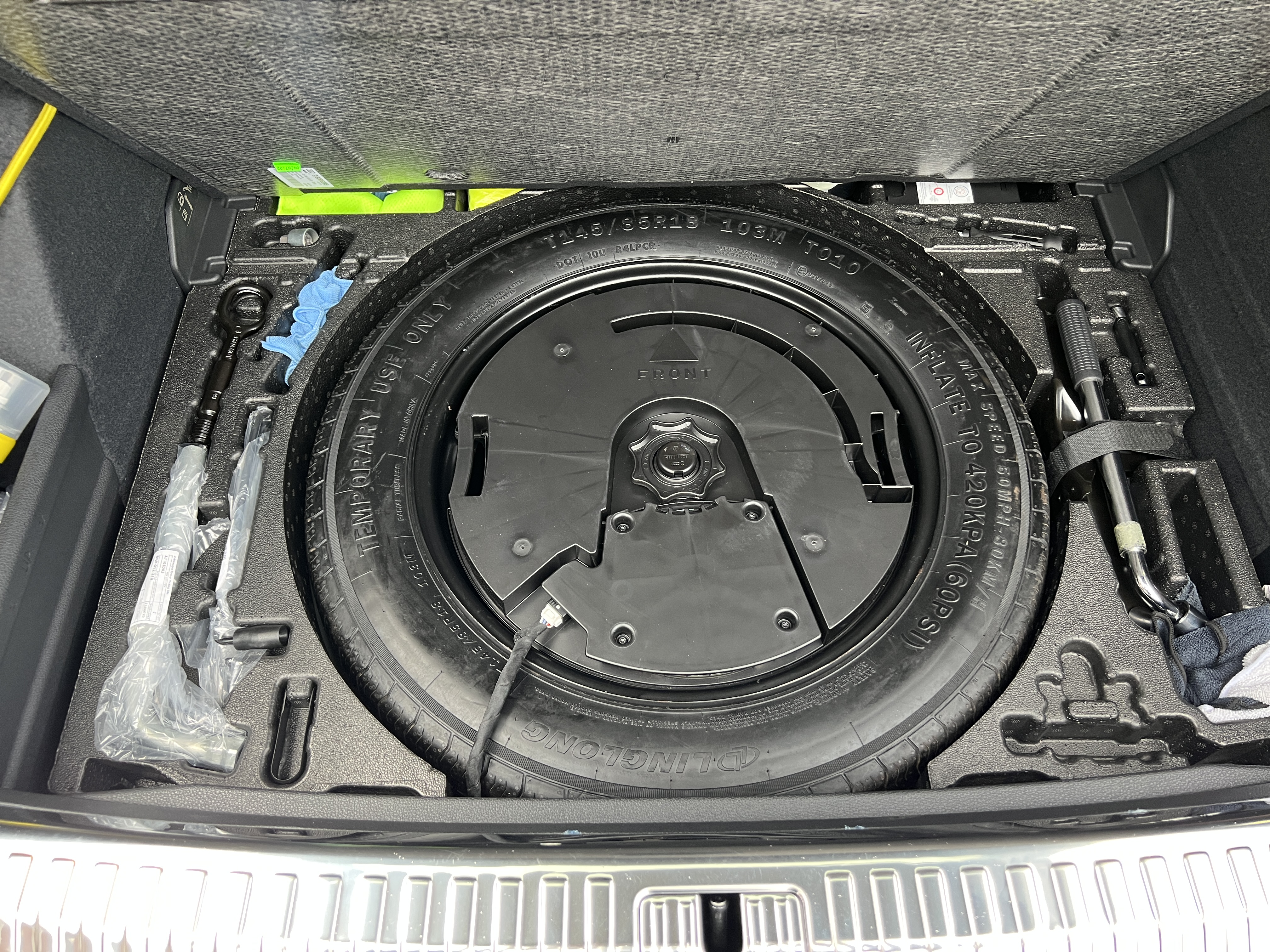

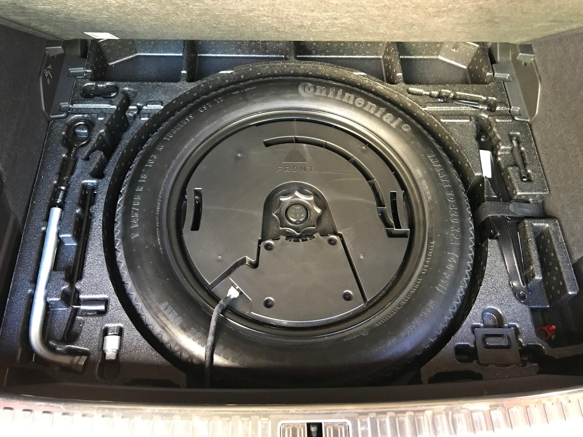

Guest Posted February 6 Share Posted February 6 An update for 2023 MY cars Q3 F3N Sportback Quattro Sline Spare I just looked round Audi dealers till i found one with a spare wheel fitted if it helps it is this one EK72 XFR WAUZZZF31P1029608. 2022 Audi Q3 F3N Sportback S LN BLK ED 40 TFSI Quat SA Turbo Blue its sold now though Just told my local dealer it was car i saw with the bits on they were happy and orederd them the parts i ordered were (the item numbers are the parts diagram on dealers screen) 7 A83A 012 109 N Stowage Compartment £100.20 16 A5QF 011 031 C jack £46.57 17 A5Q0 011 221 Crank arm for jack £7.62 21 A8N 0012 219 socket wrench for wheel bolts £13.04 Total £200.92 inc VAT arrived in 2 days Feb 2023 prices Wheel with tyre 40/85/R18 on Rim 4J 18 H2 £120 new from eBay inc post total all in £320.92 The tools Jack etc are on eBay If i had known I would have just bought storage then Tools off eBay cutting cost down My car Audi Q3 F3N Sportback Quattro S Line 45 TFSI Dew Silver 2023 I got Comfort and Sound pack & Driver Assistance Pack I forgot to order spare with it Quote Link to comment Share on other sites More sharing options...
Steve Q Posted February 6 Share Posted February 6 7 hours ago, ivor bigun said: An update for 2023 MY cars Q3 F3N Sportback Quattro Sline Spare I just looked round Audi dealers till i found one with a spare wheel fitted if it helps it is this one EK72 XFR WAUZZZF31P1029608. 2022 Audi Q3 F3N Sportback S LN BLK ED 40 TFSI Quat SA Turbo Blue its sold now though Just told my local dealer it was car i saw with the bits on they were happy and orederd them the parts i ordered were (the item numbers are the parts diagram on dealers screen) 7 A83A 012 109 N Stowage Compartment £100.20 16 A5QF 011 031 C jack £46.57 17 A5Q0 011 221 Crank arm for jack £7.62 21 A8N 0012 219 socket wrench for wheel bolts £13.04 Total £200.92 inc VAT arrived in 2 days Feb 2023 prices Wheel with tyre 40/85/R18 on Rim 4J 18 H2 £120 new from Ebay inc post total all in £320.92 The tools Jack etc are on ebay If i had known I would have just bought storage then Tools off ebay cutting cost down My car Audi Q3 F3N Sportback Quattro S Line 45 TFSI Dew Silver 2023 I got Comfort and Sound pack & Driver Assistance Pack I forgot to order spare with it That's all very useful info. Thanks for giving members the part numbers 🙂 Quote Link to comment Share on other sites More sharing options...

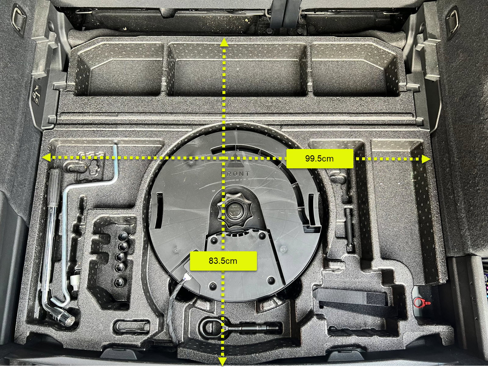

Guest Posted February 18 Share Posted February 18 (edited) On 2/6/2023 at 9:52 AM, ivor bigun said: An update for 2023 MY cars Q3 F3N Sportback Quattro Sline Spare I just looked round Audi dealers till i found one with a spare wheel fitted if it helps it is this one EK72 XFR WAUZZZF31P1029608. 2022 Audi Q3 F3N Sportback S LN BLK ED 40 TFSI Quat SA Turbo Blue its sold now though Just told my local dealer it was car i saw with the bits on they were happy and orederd them the parts i ordered were (the item numbers are the parts diagram on dealers screen) 7 A83A 012 109 N Stowage Compartment £100.20 16 A5QF 011 031 C jack £46.57 17 A5Q0 011 221 Crank arm for jack £7.62 21 A8N 0012 219 socket wrench for wheel bolts £13.04 Total £200.92 inc VAT arrived in 2 days Feb 2023 prices Wheel with tyre 40/85/R18 on Rim 4J 18 H2 £120 new from Ebay inc post total all in £320.92 The tools Jack etc are on ebay If i had known I would have just bought storage then Tools off ebay cutting cost down My car Audi Q3 F3N Sportback Quattro S Line 45 TFSI Dew Silver 2023 I got Comfort and Sound pack & Driver Assistance Pack I forgot to order spare with it I did a small modification I bought a small square of the thin soundproofing pad similar to what is on the boot floor I was not sure whether the wheel wood have metal to metal contact I think the tyre walls sit on the boot floor but is belt and braces the sound proof pad was only £1. The only extra I forgot is a tyre bag XXXXL size 75cmx26cm fits up 235/30/22 The full size 19 inch will not fit in under floor space so will need to be in the boot Its sods law if you change the wheel it will be a dirty wet day the £9.89 freepost I bought it from eBay seller "8sola" will protect your boot Picture its Now fitted in My 2023 The tyre pump and the Sticky glue does all fit in the surround glue top right air comp bottom right plus some gloves to keep hands clean The other extra on the right is an extending Bolt remover tool this i salvaged from my Q2 and before that the Focus ST3 the standard spanner i found is not long enough to crack the bolts fitted by dealers and tyre fitters. Edited February 18 by ivor bigun change photo add an extra sentence Quote Link to comment Share on other sites More sharing options...

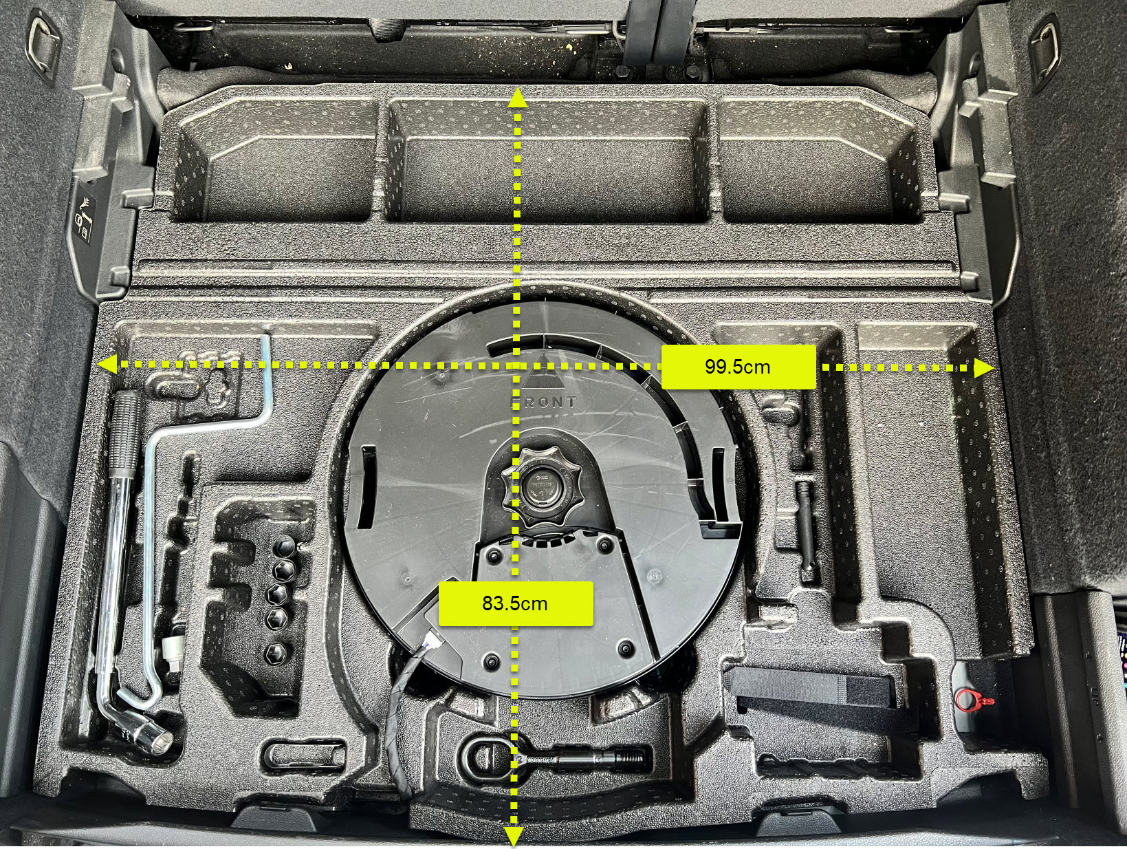

Steve Q Posted February 19 Share Posted February 19 On 2/18/2023 at 9:54 AM, ivor bigun said: I did a small modification I bought a small square of the thin soundproofing pad similar to what is on the boot floor I was not sure whether the wheel wood have metal to metal contact I think the tyre walls sit on the boot floor but is belt and braces the sound proof pad was only £1. The only extra I forgot is a tyre bag XXXXL size 75cmx26cm fits up 235/30/22 The full size 19 inch will not fit in under floor space so will need to be in the boot Its sods law if you change the wheel it will be a dirty wet day the £9.89 freepost I bought it from eBay seller "8sola" will protect your boot Picture its Now fitted in My 2023 The tyre pump and the Sticky glue does all fit in the surround glue top right air comp bottom right plus some gloves to keep hands clean The other extra on the right is an extending Bolt remover tool this i salvaged from my Q2 and before that the Focus ST3 the standard spanner i found is not long enough to crack the bolts fitted by dealers and tyre fitters. Thanks for that additional info 🙂 Quote Link to comment Share on other sites More sharing options...

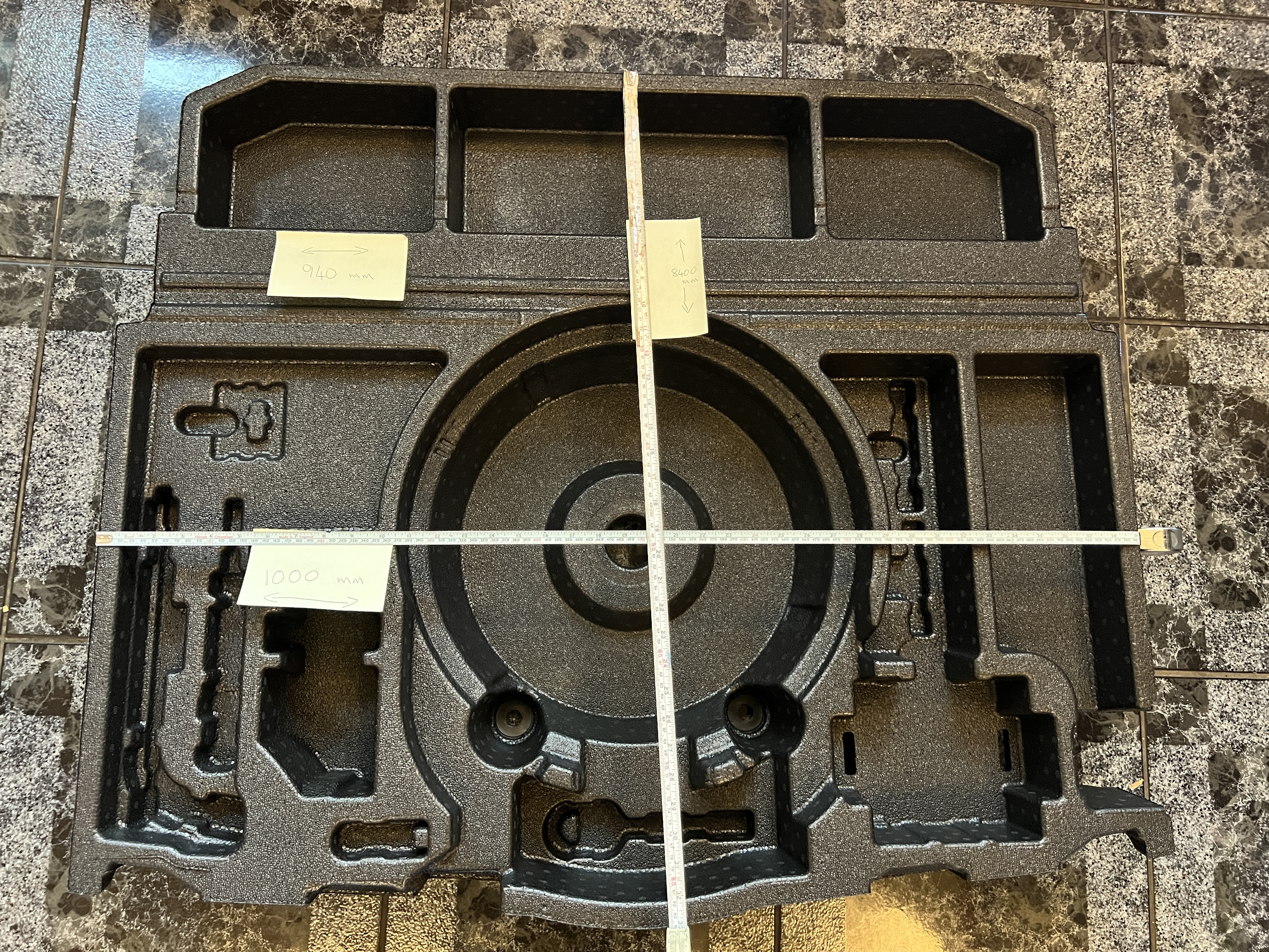

Ektoras Posted March 16 Share Posted March 16 hello all, Does anyone knows is this spare wheel compartment (83A-012-109-H) can be fitted in the 2020 Q3? I have called an Audi dealer today and he said that this part is not compatible with my car. But reading through this thread, I have the feeling that it is.. Quote Link to comment Share on other sites More sharing options...
Guest Posted March 16 Share Posted March 16 (edited) I think it will they told me it was not compatible with mine but I got the vin and reg from one on the forecourt that had it fitted from new gave them that number and it was no problem they never noticed it was their own car i think if something was not fitted when built Audi say it’s not compatible I have done the use another Vin and reg from a vehicle that has the part fitted my S1 I got front parking sensors and power fold mirrors from an A1 Sline in the showroom they told me parking sensors did not fit S1 they did I got rear camera from Q7 again I got the one with the wash Audi said it fit not fit it did they are all same camera mine did not come with one they told me not compatible I have a photo of the original boot liner with the dimensions if yours is the same as this then yes it will fit it is 150mm at the deepest part which is the base of photo 1 meter widest point 940 mm where the trays start near top narrowest point at the top of three trays 910 mm top to bottom on photo 840 mm i have put post it notes showing measurements there are 2 nuts in the speaker fitting well the new one fits in loose and does not need nuts as they wheel is in the way of fastening it you will see there is no provision that’s normal obviously the speaker and tools are in the new one it only weighs about 25 grams really light made from expanded foam let me know if yours has the same dimensions will be useful for any one else Check in the door pillar just below stricken plate where the tyre pressures are located it shows the wheel sizes for your car and also the spare wheel size is on there too even though it came with out I will put the photo of mine on shows Spare as T 145/85 R18 and pressure of 4.2 bar 60 psi make sure you do get the correct size wheel as a wrong size one could invalidate insurance I have Audi Inure and one of the questions is are you using the correct size wheels and tyres Yes box ticked if the spare was not compatible this info would NOT be on the door pillar Edited March 16 by ivor bigun Quote Link to comment Share on other sites More sharing options...
Guest Posted March 16 Share Posted March 16 On 2/18/2023 at 9:54 AM, ivor bigun said: I did a small modification I bought a small square of the thin soundproofing pad similar to what is on the boot floor I was not sure whether the wheel wood have metal to metal contact I think the tyre walls sit on the boot floor but is belt and braces the sound proof pad was only £1. The only extra I forgot is a tyre bag XXXXL size 75cmx26cm fits up 235/30/22 The full size 19 inch will not fit in under floor space so will need to be in the boot Its sods law if you change the wheel it will be a dirty wet day the £9.89 freepost I bought it from eBay seller "8sola" will protect your boot Picture its Now fitted in My 2023 The tyre pump and the Sticky glue does all fit in the surround glue top right air comp bottom right plus some gloves to keep hands clean The other extra on the right is an extending Bolt remover tool this i salvaged from my Q2 and before that the Focus ST3 the standard spanner i found is not long enough to crack the bolts fitted by dealers and tyre fitters. I can put the photos up now as this registration is void now Quote Link to comment Share on other sites More sharing options...
Ektoras Posted March 16 Share Posted March 16 1 hour ago, ivor bigun said: I think it will they told me it was not compatible with mine but I got the vin and reg from one on the forecourt that had it fitted from new gave them that number and it was no problem they never noticed it was their own car i think if something was not fitted when built Audi say it’s not compatible I have done the use another Vin and reg from a vehicle that has the part fitted my S1 I got front parking sensors and power fold mirrors from an A1 Sline in the showroom they told me parking sensors did not fit S1 they did I got rear camera from Q7 again I got the one with the wash Audi said it fit not fit it did they are all same camera mine did not come with one they told me not compatible I have a photo of the original boot liner with the dimensions if yours is the same as this then yes it will fit it is 150mm at the deepest part which is the base of photo 1 meter widest point 940 mm where the trays start near top narrowest point at the top of three trays 910 mm top to bottom on photo 840 mm i have put post it notes showing measurements there are 2 nuts in the speaker fitting well the new one fits in loose and does not need nuts as they wheel is in the way of fastening it you will see there is no provision that’s normal obviously the speaker and tools are in the new one it only weighs about 25 grams really light made from expanded foam let me know if yours has the same dimensions will be useful for any one else Check in the door pillar just below stricken plate where the tyre pressures are located it shows the wheel sizes for your car and also the spare wheel size is on there too even though it came with out I will put the photo of mine on shows Spare as T 145/85 R18 and pressure of 4.2 bar 60 psi make sure you do get the correct size wheel as a wrong size one could invalidate insurance I have Audi Inure and one of the questions is are you using the correct size wheels and tyres Yes box ticked if the spare was not compatible this info would NOT be on the door pillar Many thanks Ivor, super helpful! I'll check my dimentions and let you guys know. By the way, amazing colour!! Quote Link to comment Share on other sites More sharing options...

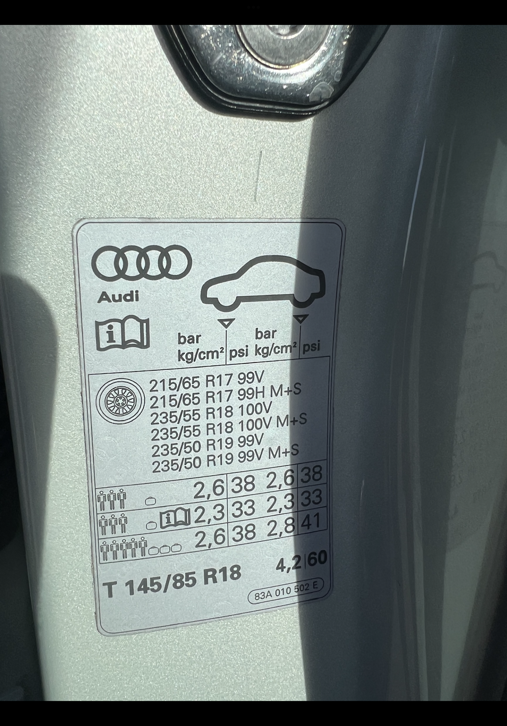

Guest Posted March 16 Share Posted March 16 (edited) Check the door pillar it will tell you if a spare available and what size and thanks it’s Dew Silver one of the colours with a mind of its own under blue sky gets a blue tint here it has green tint at the Audi dealer it gets a grey tint Edited March 16 by ivor bigun Quote Link to comment Share on other sites More sharing options...

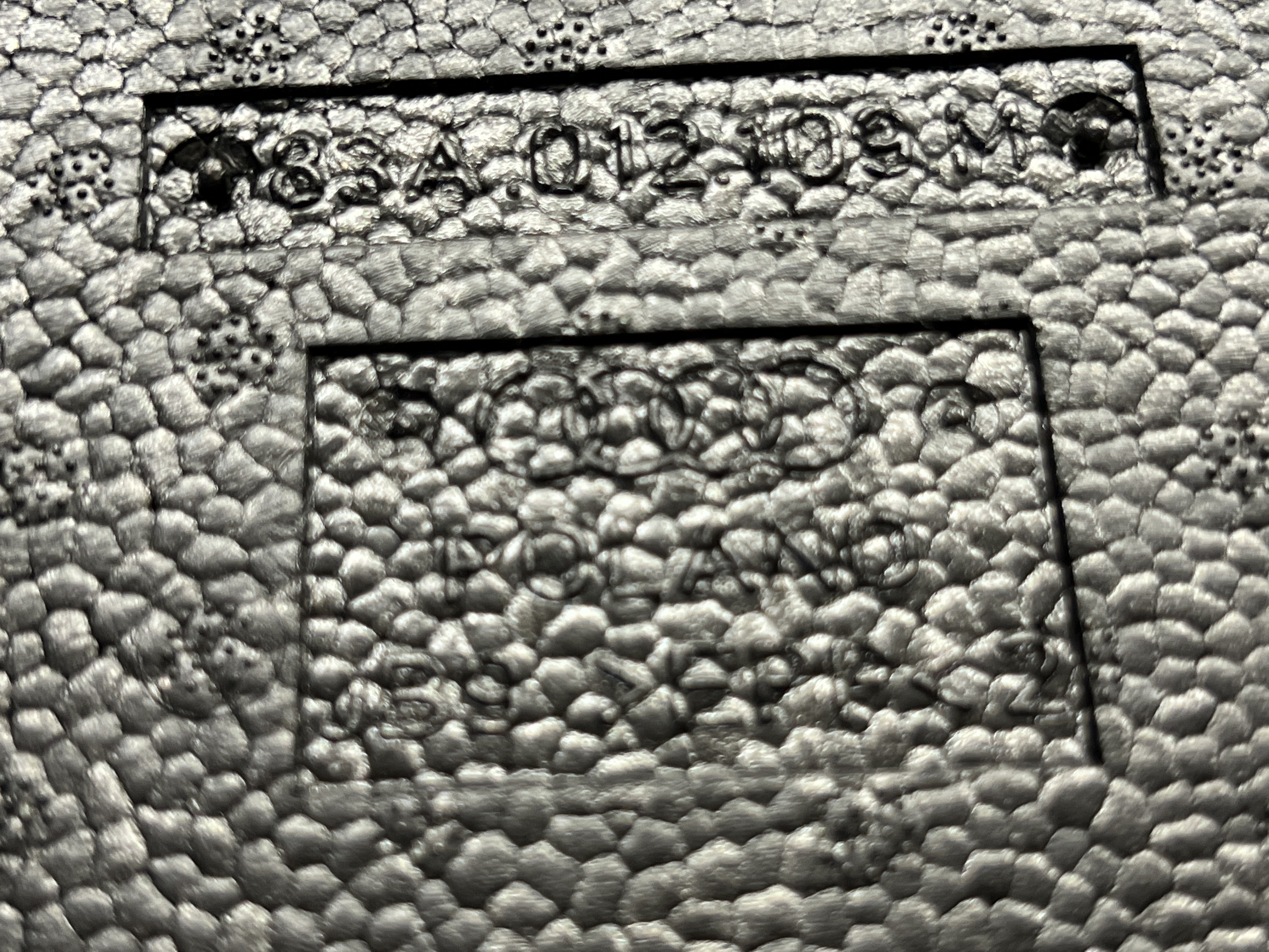

Guest Posted March 16 Share Posted March 16 I have had an idea May be I was loosing the plot i will check if there is a part number on my original boot liner with out spare wheel I will post it here if there is and then if you have the same none spare wheel liner you know the replacement will fit post this in the morning as I have to go dig out the original again Quote Link to comment Share on other sites More sharing options...
Guest Posted March 16 Share Posted March 16 (edited) On 11/13/2019 at 1:41 PM, B.P.Dtephens said: There is a mystery about spare wheels.When I bought my 2019 Q3, Audi refused to supply it with a spare wheel. I note that you can buy a suitable low profile spare wheel from another supplier but they can not provide a fixing bolt for this car. My car has a strange fixing arrangement and I don't know how to make use of it. Anyone have any ideas? If you look on eBay the same centre bolt which has like a T piece on the bottom is readily available with the tools or spare wheel right back to 2017 my Q2 from 2017 had same part any from the VAG Group will do my spare wheel came from a V W Tiguan I think Seat Audi Skoda VW Lamborghini and Bentley spare wheel holder will fit I think Skoda or Seat are the cheapest but they are all the same part Edited March 16 by ivor bigun Quote Link to comment Share on other sites More sharing options...

Ektoras Posted March 19 Share Posted March 19 On 3/16/2023 at 2:13 PM, Guest said: I think it will they told me it was not compatible with mine but I got the vin and reg from one on the forecourt that had it fitted from new gave them that number and it was no problem they never noticed it was their own car i think if something was not fitted when built Audi say it’s not compatible I have done the use another Vin and reg from a vehicle that has the part fitted my S1 I got front parking sensors and power fold mirrors from an A1 Sline in the showroom they told me parking sensors did not fit S1 they did I got rear camera from Q7 again I got the one with the wash Audi said it fit not fit it did they are all same camera mine did not come with one they told me not compatible I have a photo of the original boot liner with the dimensions if yours is the same as this then yes it will fit it is 150mm at the deepest part which is the base of photo 1 meter widest point 940 mm where the trays start near top narrowest point at the top of three trays 910 mm top to bottom on photo 840 mm i have put post it notes showing measurements there are 2 nuts in the speaker fitting well the new one fits in loose and does not need nuts as they wheel is in the way of fastening it you will see there is no provision that’s normal obviously the speaker and tools are in the new one it only weighs about 25 grams really light made from expanded foam let me know if yours has the same dimensions will be useful for any one else Check in the door pillar just below stricken plate where the tyre pressures are located it shows the wheel sizes for your car and also the spare wheel size is on there too even though it came with out I will put the photo of mine on shows Spare as T 145/85 R18 and pressure of 4.2 bar 60 psi make sure you do get the correct size wheel as a wrong size one could invalidate insurance I have Audi Inure and one of the questions is are you using the correct size wheels and tyres Yes box ticked if the spare was not compatible this info would NOT be on the door pillar Here is a picture of mine with the dimentions. I am guessing it is indeed same, as the half centimetre difference is probably because i measured it inside the boot. So i think I am gonna order it. By the way: it seems that screws that are holding it in place (second picture) are 'audi-special' haven't seen them before. Any idea where i can find a screwdriver for these? Thanks for the tip on the spare wheel size, mine is also 145/85 R18. Quote Link to comment Share on other sites More sharing options...

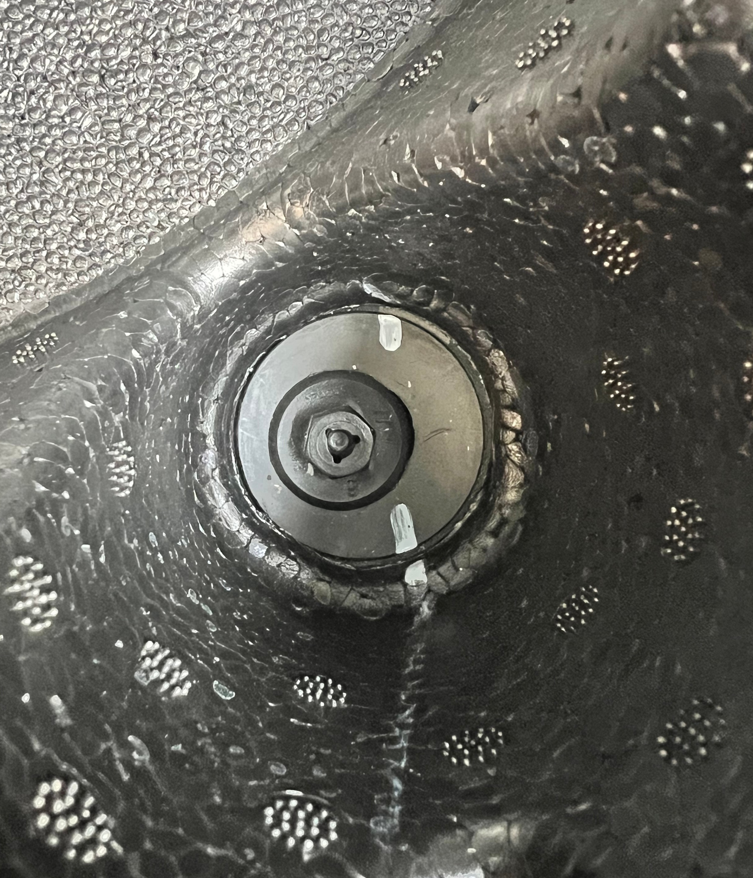

Ektoras Posted March 19 Share Posted March 19 Scratch my question... I just realised by looking at the picture that it is a standard hexagon 😁 Quote Link to comment Share on other sites More sharing options...
