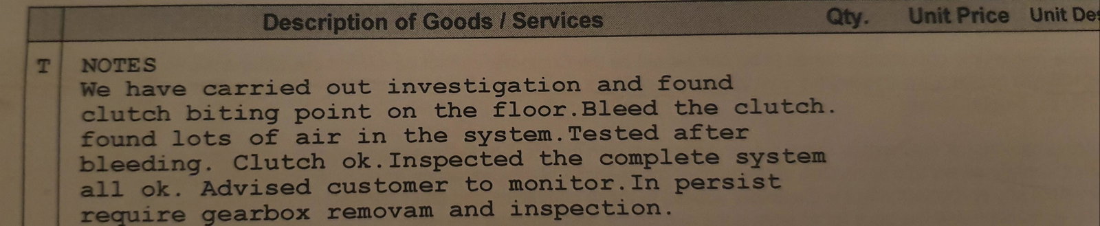

Dannyboy16 Posted June 24, 2020 Share Posted June 24, 2020 Hi all, my girlfriend purchased a brand new Audi A1 1.0l in September 2017, and when I say brand new I mean it had not even been registered with the DVLA yet. After just over a year with no issues my girlfriend noticed the clutch point had started to move, I also noticed this issue when I drove the car. A short while later the problem escalated with the clutch biting point becoming non existent as in there was no gradual release of clutch, it was either engaged or disengaged. It also became virtually impossible to put the car into gear with the engine running and became very difficult to engage 2nd through 5th when driving. At this time we also noticed some clear fluid pooling in the drivers footwell. We then took the car to our audi dealership who carried out an investigation, in their investigation they found that the clutch biting point was on the floor, they bleed the clutch system and 'found lots of air' in it, they then tested the system after bleeding and found it to be ok. They also inspected the complete system and found all ok. We were then given the car back with a warning that if the problem persisted the gearbox would need to be removed and fully inspected. Well after less than a year the same set of issues materialized again in the same order as I stated above. We had three separate AA mechanics come and inspect the car, the first declared it driver error without so much as looking at the car. Both the other mechanics however suggested after hearing about the issues and testing the car for themselves that it was most likely an issue with hydraulics/master cylinder. We have taken the car back to the Audi dealership who have point blank stated that it has to be driver error without inspecting the car, they have also said that only an Audi mechanic is authorised to conclude whether the issue is a mechanical fault or wear and tear. This seems quite suspicious to me as it would appear they have the final say on whether they are at fault or not and we now find ourselves in a dispute with the dealership over this. Hopefully someone can shed some light on what has caused this fault and whether my girlfriend and I are to blame, but I must point out this is the only car we have owned that has had any faults, I have had several cars; none of which developed any of these faults and all are a lot older than the audi. If anyone has any advice or has seen this issue before and can shed some light on the cause that would be greatly appreciated. I have also included a snap of the original audi investigation. Quote Link to comment Share on other sites More sharing options...
