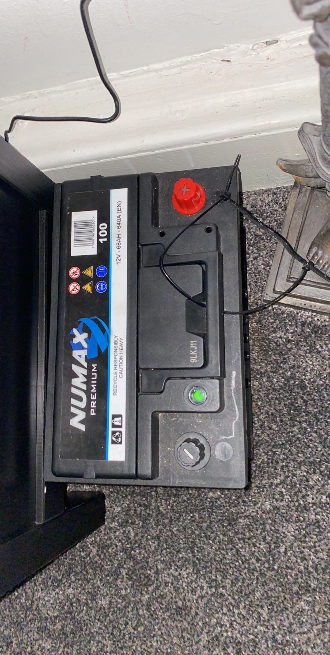

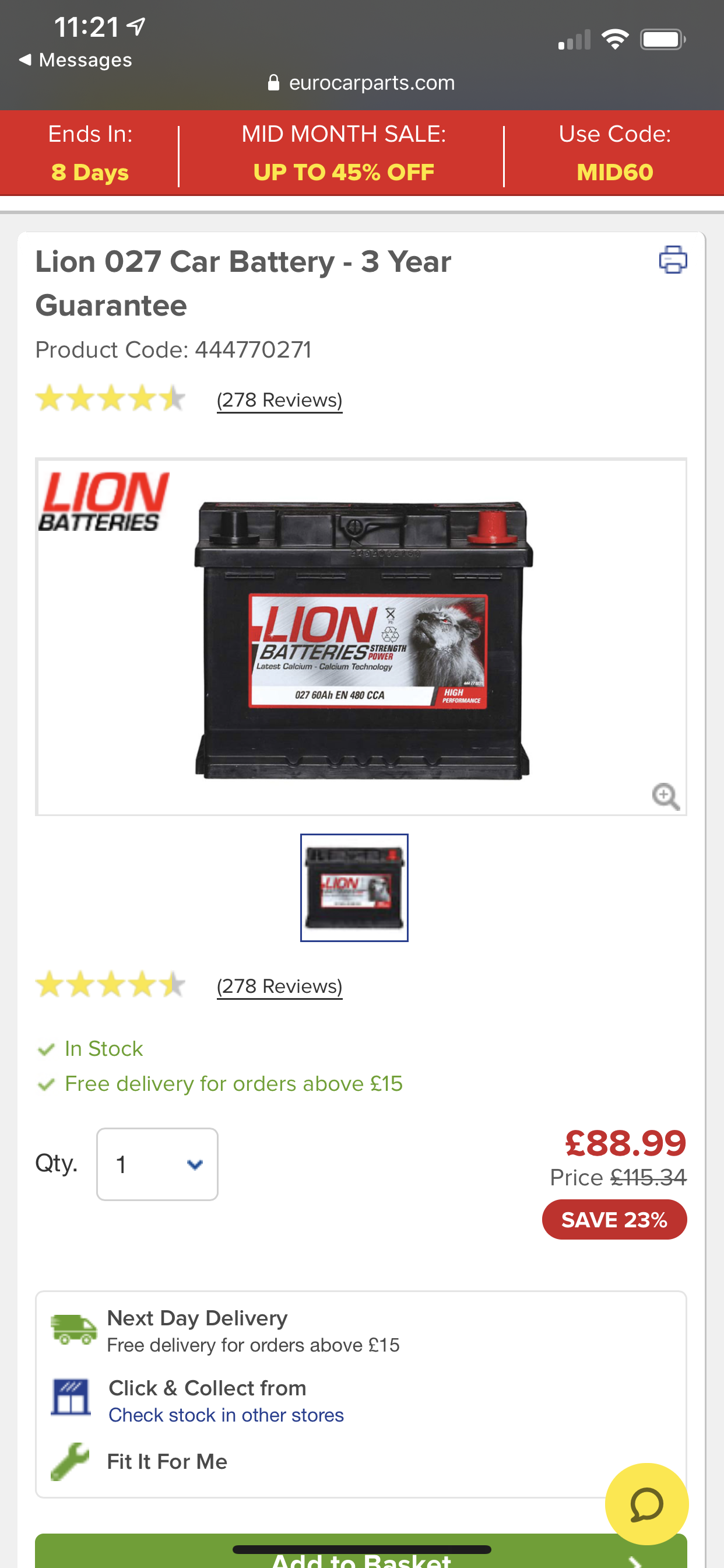

Good morning
i have attached a photo of the battery i got from ecp lion 027 and i have also attached a photo of the old battery
hopefully it may last a year or something till i get a new car this one is causing me all sorts of problems getting a new clutch in today and the turbo looked at

Lion?? Good luck Jamie. Just my opinion, but if asked which brand not to buy.....

Hello Jamie,
Batteries covered by your guarantee?? In any case, the Numax one fitted is at the cheap end of the market, and if the guarantee does cover its replacement then it could well be on a like for like basis.
