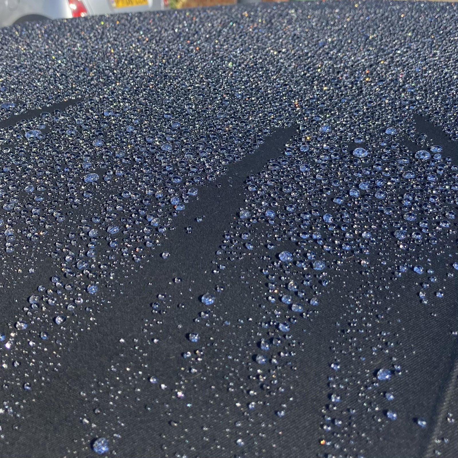

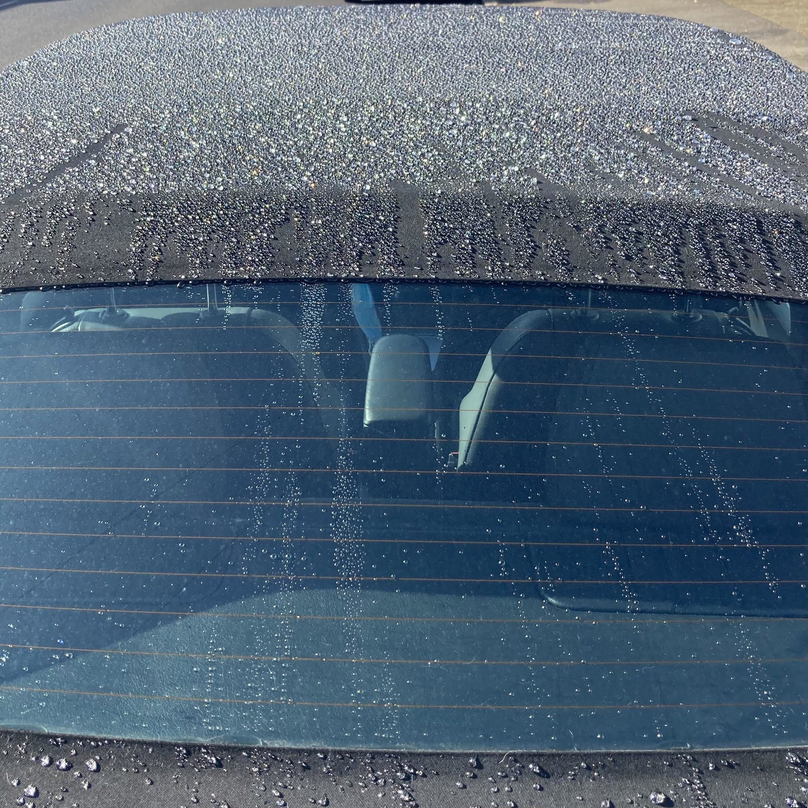

I looked up best protector for tents and apparently people who are on expedition in the Amazon jungle use Fabsil twice a year for protection! 🤷‍♂️
 00F34DD0-7FF0-4781-AD58-116BCD2BE811.thumb.jpeg.39779d71f12e3222fdaeb6d5254f70d0.jpeg4E70F1BF-8A1C-43DE-A64D-6A1137E51B1D.thumb.jpeg.2dce16ebacb9363dae55df167dc9e672.jpegworks for me
