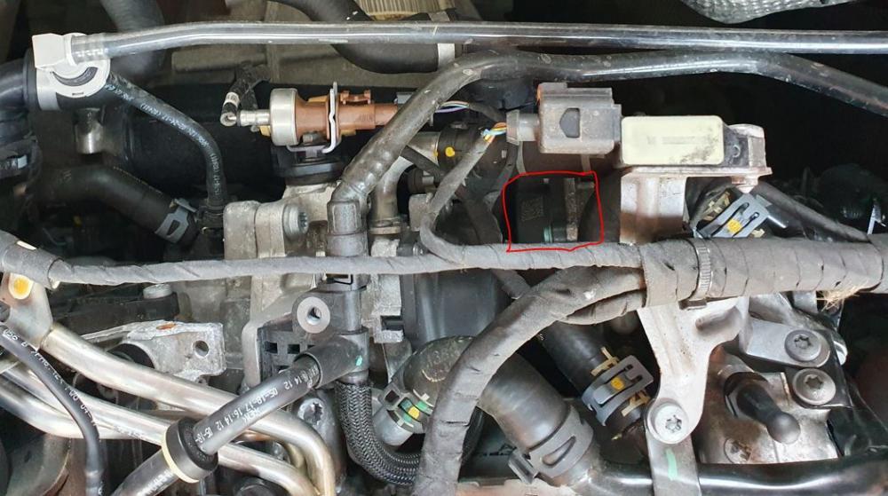

jdragon Posted April 15, 2022 Share Posted April 15, 2022 Has anyone removed and cleaned the EGR valve on a DETA engine? I attempted it yesterday but it looks like there's so much to remove, I abandoned the task. I'm assuming it has never been done on my A5, and at 60k it's likely to be in need of a clean soon, if the build up is similar to my old A4 B8 diesel that I cleaned every 30-40k. Given the effort, I'm wondering if a more frequent "remove a pipe and spray clean" would at least manage the build up, though knowing what it takes to actually clean the valve, I have low expectations. I'm also wondering where the crap goes downstream from the insitu cleaning method e.g. stuck in the CAT? If anyone has some experience to share, I'd be very grateful to learn from it. Quote Link to comment Share on other sites More sharing options...

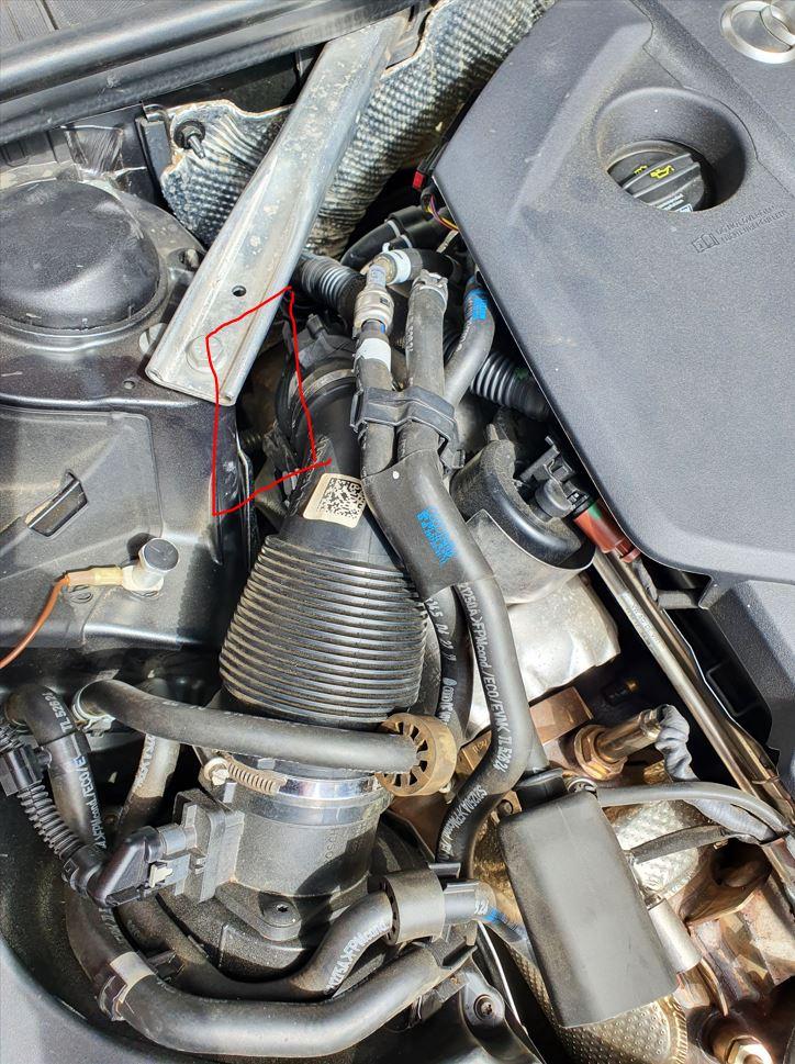

jdragon Posted August 28, 2022 Author Share Posted August 28, 2022 Just to close this topic and avoid causing any confusion, the photo I uploaded in the first post is not the EGR valve. The EGR valve and cooler are located on the lower left rear side of the engine. The side of the valve can been seen looking through the gap indicated by the box in the photo. Foy anyone wanting to attempt this as a DIY, I can confirm it a 6+ hour job, and requires a great deal of patience With regards to the Cataclean, I used it back in April and drove to work (~35 miles) in 5th gear so the revs were at around 2000rpm There are several corners and roundabouts within 0.5 mile of leaving work before I get onto the A road. On the way home, I instantly noticed the car was much smoother accelerating so ran the Cataclean through another 35 miles. I took some measurements from the particulate filter before and after that can ben found here: Obviously it didn't fix the P2002 error because at the point at which the light comes on, removal is the only option. However in my view Cataclean is a superb product (thanks @Stevey Y). The car still feels very smooth when cold even before having the EGR Cooler and Valve replaced, so I have continued to use it at the frequency recommended. I've since mentioned it to others for their cars (other Audis, VW, BMW, Vauxhall) with mileage ranging from 60 - 240k and they have all reported the same outcome from the initial dose. 1 Quote Link to comment Share on other sites More sharing options...
