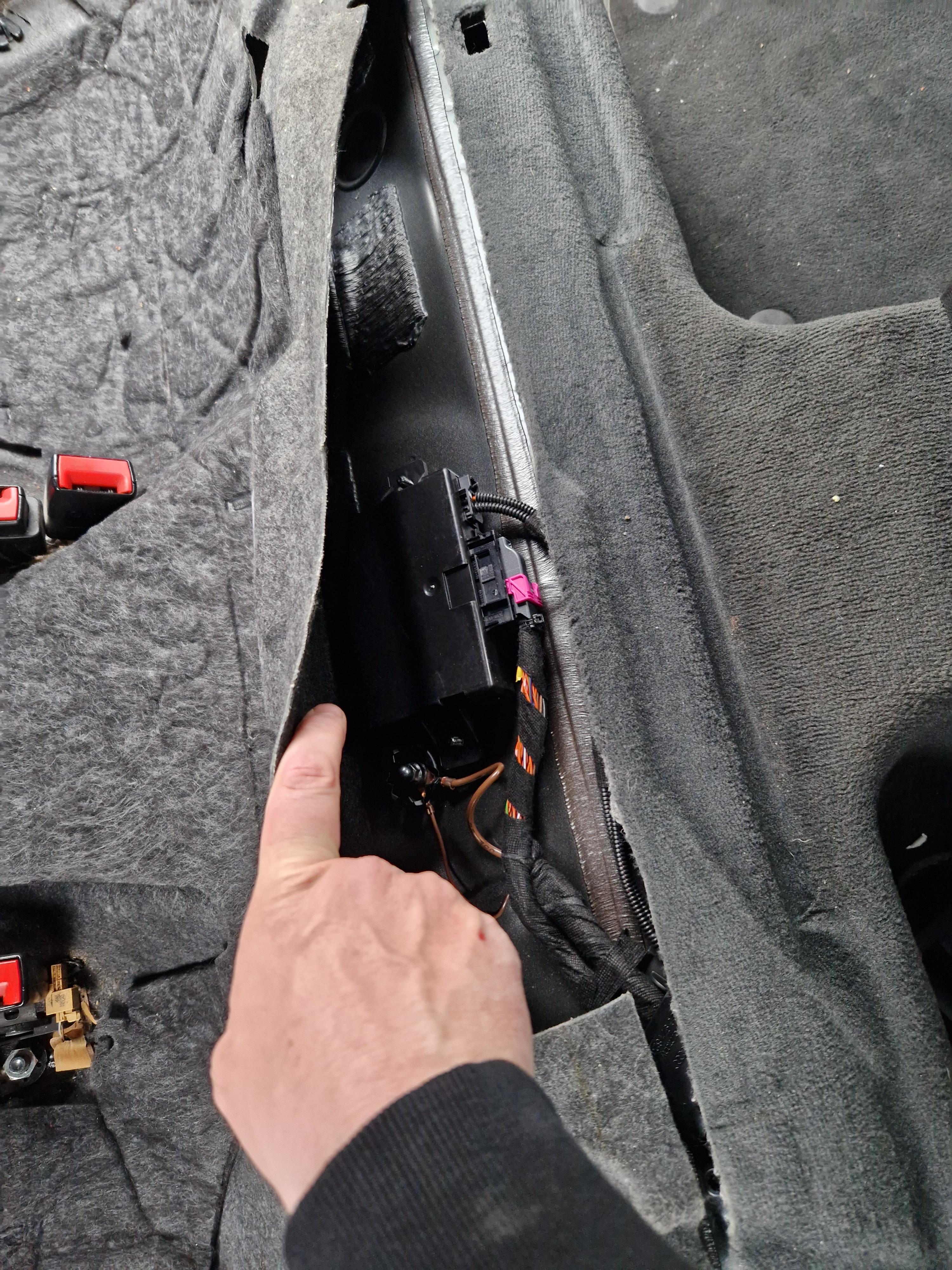

amowolves Posted May 2 Share Posted May 2 Hi Etch and all. I've just signed up as this was one of the many (prob 200+) threads I read on the internet regarding similar issues i.e TPMS, ABS, Spoiler, Park Brake, Stop Start errors etc. I've been having this issue with my A7 for a couple of weeks now. and after spending almost £400 replacing abs wheel sensors, suspect coolant valves and testing with a new battery...it turns out it was actually the central gateway module under the rear seat or the wiring loom leading up to the gateway that's faulty/shorting. I saw your post re your kids movement causing the glitches and low and behold when I applied hand pressure to the seat and carpet around the area of the module my dash lit up like a xmas tree. worse my instrument panel and mmi was going crazy too and rebooting whilst driving. Anyway I removed the rear bench and disconnected/reconnected the module and so far I have driven 20 miles with no issue. Prior to this I couldn't drive 10m before the car started pinging like mad. VCDS scans weren't really helpful either as they showed intermittent loss of communication/missing messages faults in basically every module. So nothing clear. I hope this helps someone to at least identify the issue. if the module is indeed faulty, due to the programming protection it will require an expensive trip to the dealership to replace and program. 2 Quote Link to comment Share on other sites More sharing options...
a6blacked007 Posted May 4 Share Posted May 4 On 5/2/2023 at 1:39 PM, amowolves said: Hi Etch and all. I've just signed up as this was one of the many (prob 200+) threads I read on the internet regarding similar issues i.e TPMS, ABS, Spoiler, Park Brake, Stop Start errors etc. I've been having this issue with my A7 for a couple of weeks now. and after spending almost £400 replacing abs wheel sensors, suspect coolant valves and testing with a new battery...it turns out it was actually the central gateway module under the rear seat or the wiring loom leading up to the gateway that's faulty/shorting. I saw your post re your kids movement causing the glitches and low and behold when I applied hand pressure to the seat and carpet around the area of the module my dash lit up like a xmas tree. worse my instrument panel and mmi was going crazy too and rebooting whilst driving. Anyway I removed the rear bench and disconnected/reconnected the module and so far I have driven 20 miles with no issue. Prior to this I couldn't drive 10m before the car started pinging like mad. VCDS scans weren't really helpful either as they showed intermittent loss of communication/missing messages faults in basically every module. So nothing clear. I hope this helps someone to at least identify the issue. if the module is indeed faulty, due to the programming protection it will require an expensive trip to the dealership to replace and program. This must be module you speak of not my issue gave it a wiggle with engine running no change . Quote Link to comment Share on other sites More sharing options...

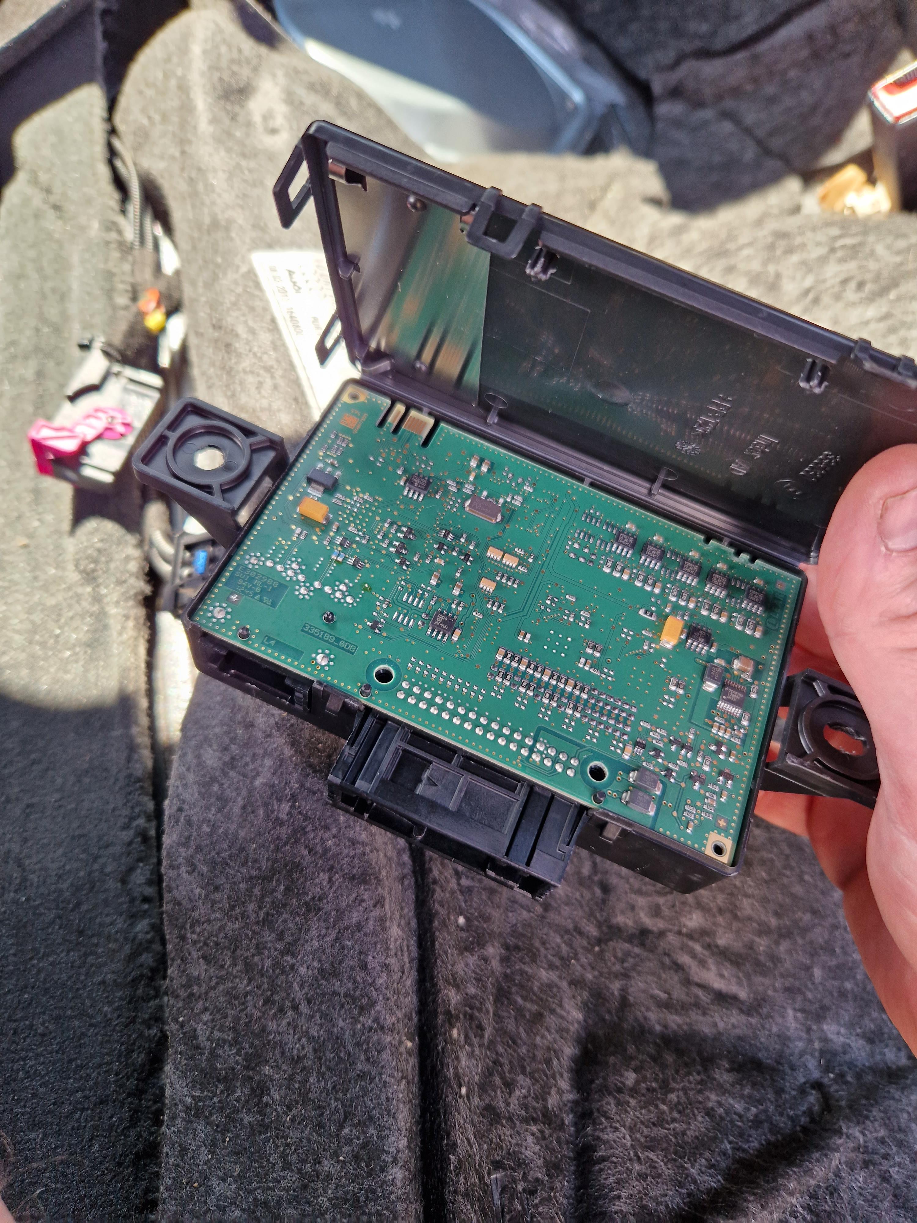

amowolves Posted May 5 Share Posted May 5 18 hours ago, a6blacked007 said: This must be module you speak of not my issue gave it a wiggle with engine running no change . depends on your issue? are you getting lots of no communication and missing messages errors in multiple modules? I too simply wiggled the connection the first time to see if it was loose but it didnt help the situation. It was only when I went back to it a few days later and I physically removed the module and gave it a couple of firm taps as well as straighten the wiring loom did my issues stop. Quote Link to comment Share on other sites More sharing options...

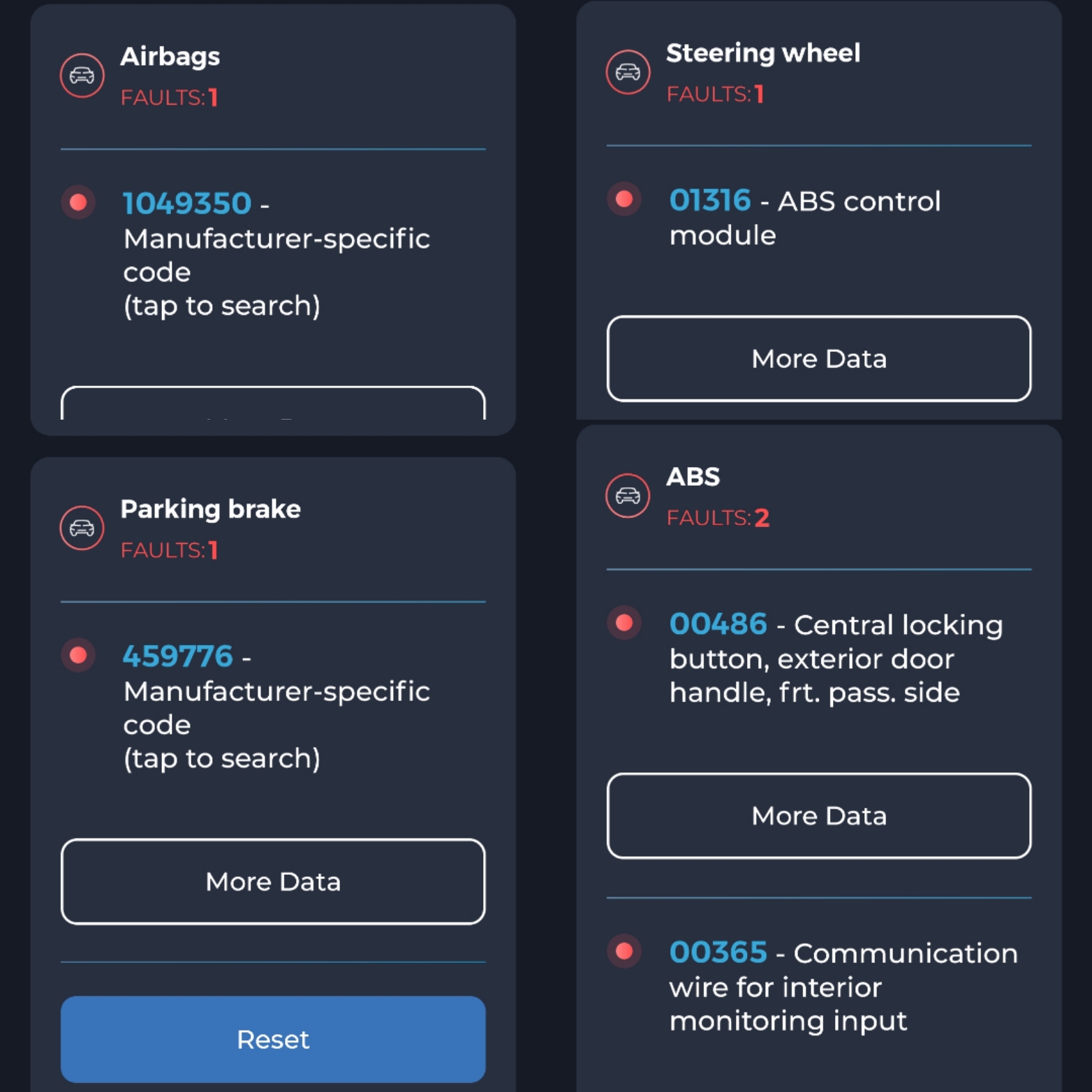

a6blacked007 Posted May 5 Share Posted May 5 I get tyre pressure / abs / handbrake etc etc all lights up like Xmas tree Happened today bumping up curb all faults listed below on carista was fault free beforehand. All faults have been cleared and have not returned. Same faults appear every incident. Quote Link to comment Share on other sites More sharing options...

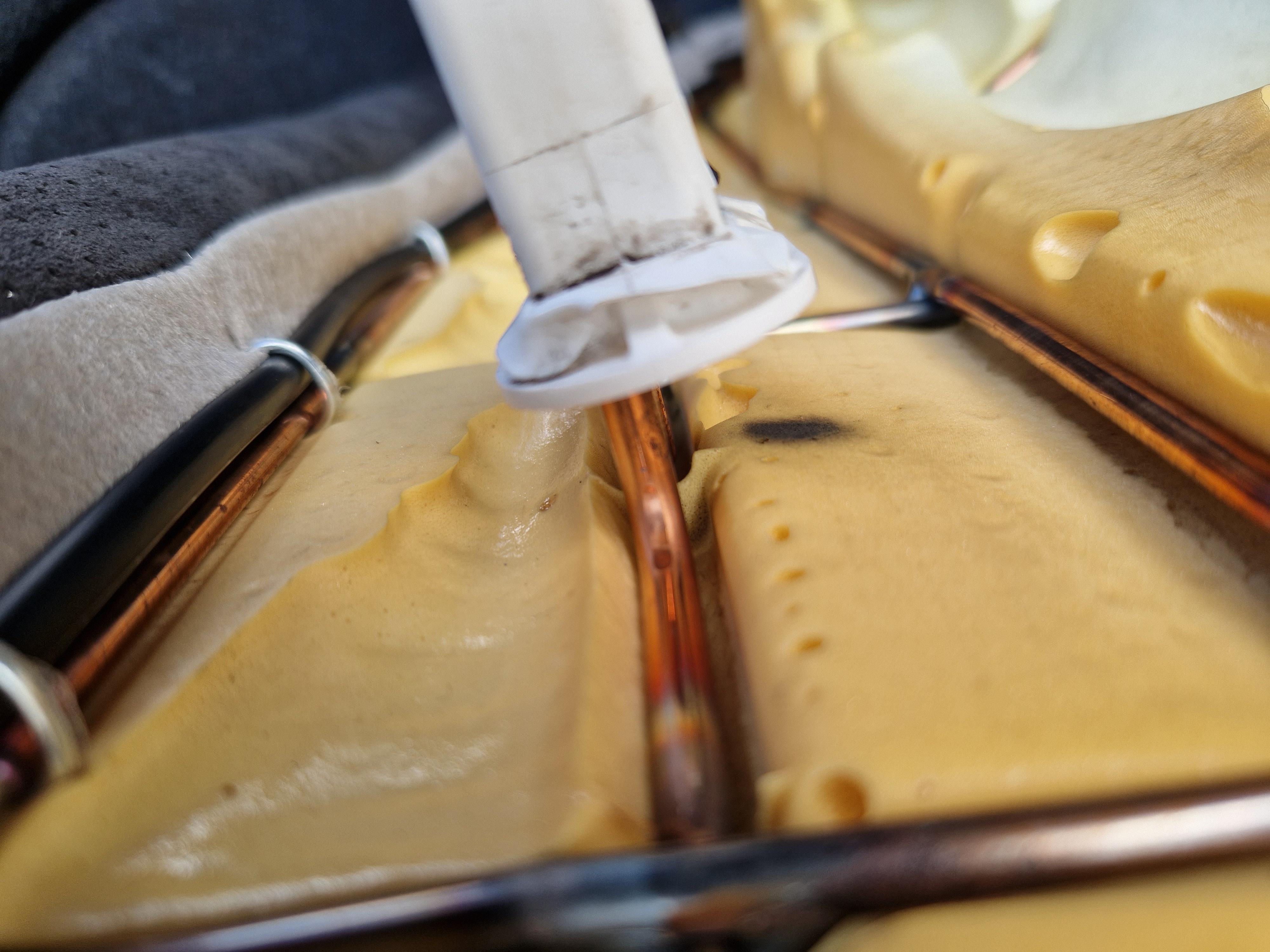

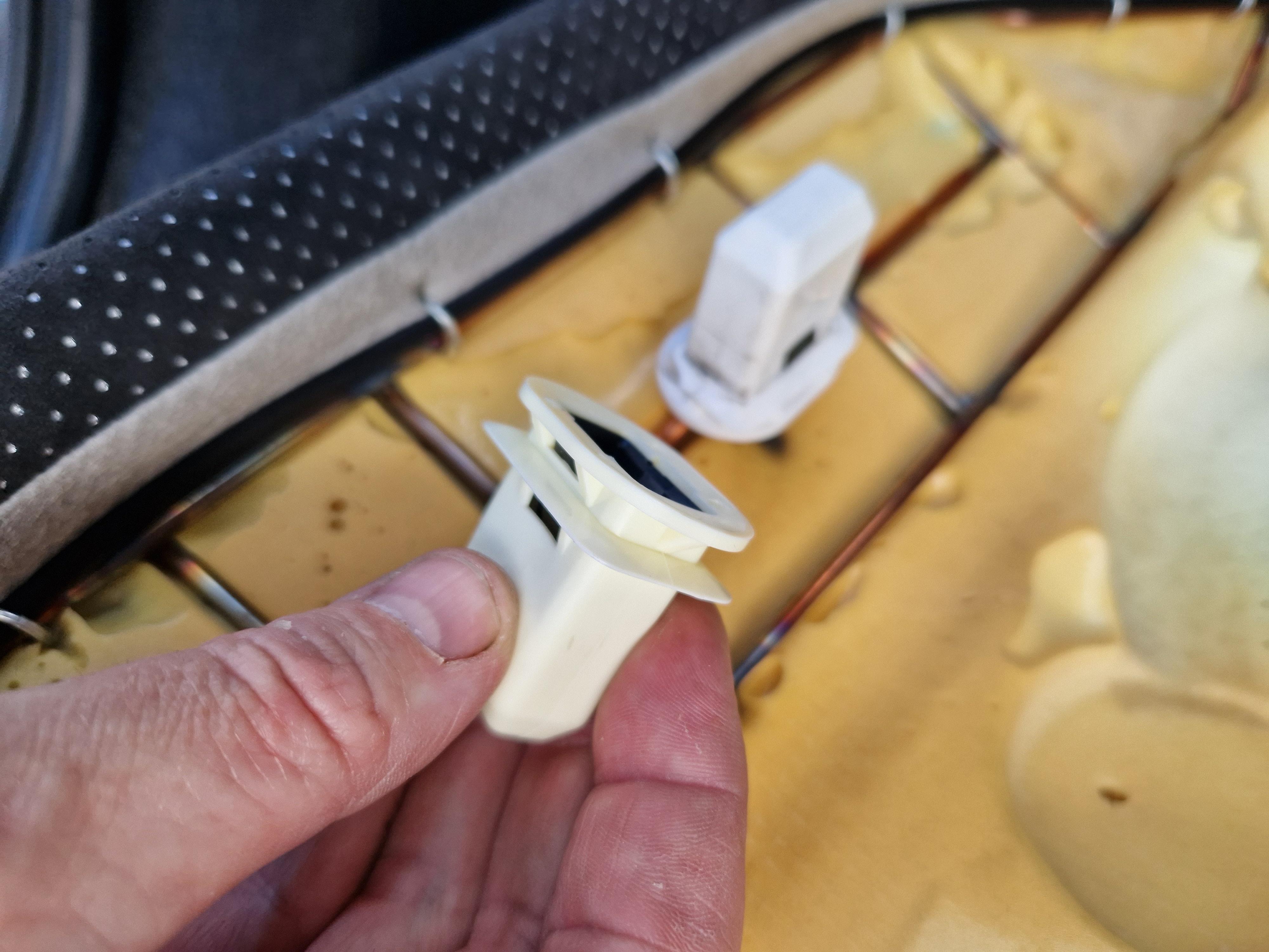

a6blacked007 Posted May 11 Share Posted May 11 Just update took module out unplugged gave it a shake opened it up My nuts were missing that hold module down so replaced them. Theres 2 clips that keep seat fixed down and up off metal that were in poor condition so were replaced Damaged Replacements. They also stop seat pushing down on module only few quid on eBay too. 1 Quote Link to comment Share on other sites More sharing options...

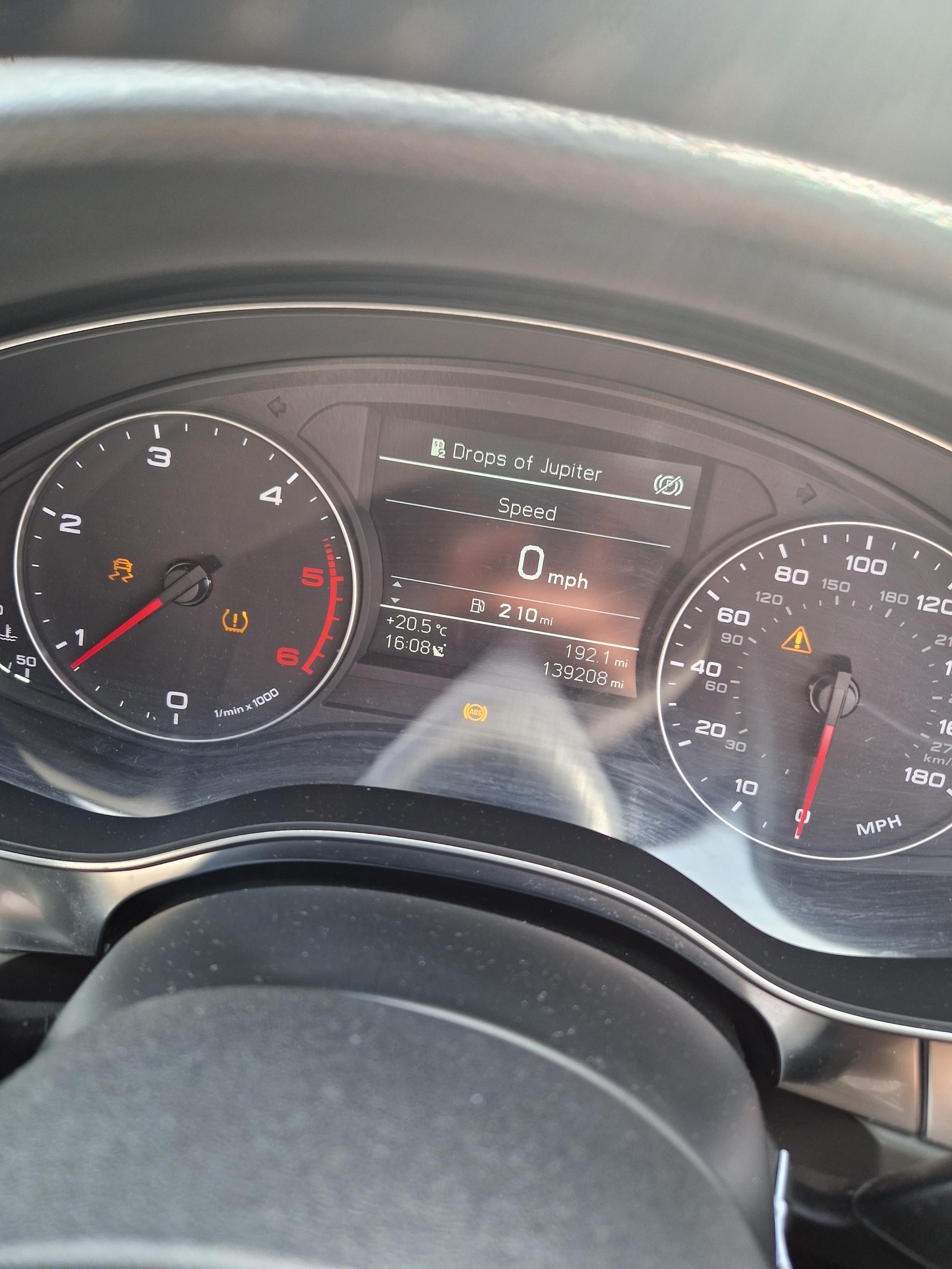

a6blacked007 Posted May 17 Share Posted May 17 Few different faults yesterday car had been jacked up passenger side I was sitting in drivers seat alloy wheel had been straightened Brake switch this time 🤔 Quote Link to comment Share on other sites More sharing options...
