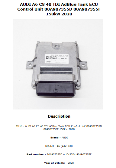

Main dealer called to say the car needs a new AdBlue ECU.  Not a big deal easy enough to get, as below on ebay etc..  Not sure how easy to fit, but I did ask what went wrong on such a low millage car. They are looking around 86 gbp on Ebay...  Im told approx 2 hours to fit?  Lets see... what happens next.  Recall on A6 C8 version rear suspension anti roll bars, plus 2 software updates.

Well got a call from main Audi dealer in Limerick.  Said it was the main AdBlue ecu as I suspected from acds scan.  Told me 799.00 euro to replace unit and 180 euro for the acds scan.  Its in their, so as they said this would sort it, I said go ahead...  Was expecting to get a call to pick up the car, but today they called and said its now the adblue quality sensor.... Could of starting replacing parts at my local garage... to solve... they want another 350 euro, and then what ever happens after that...  Very disappointing to be honest, I told them to just give me the car back, no need to replace parts.
