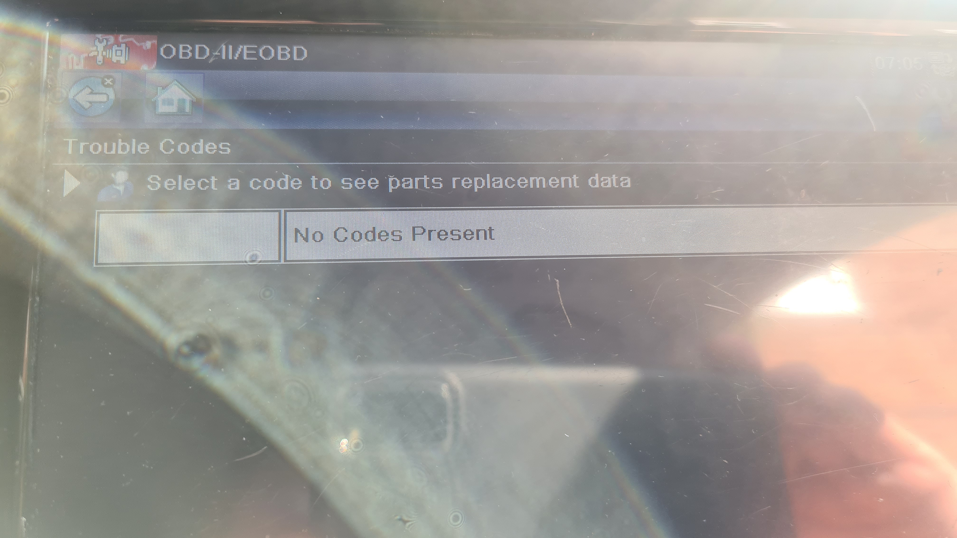

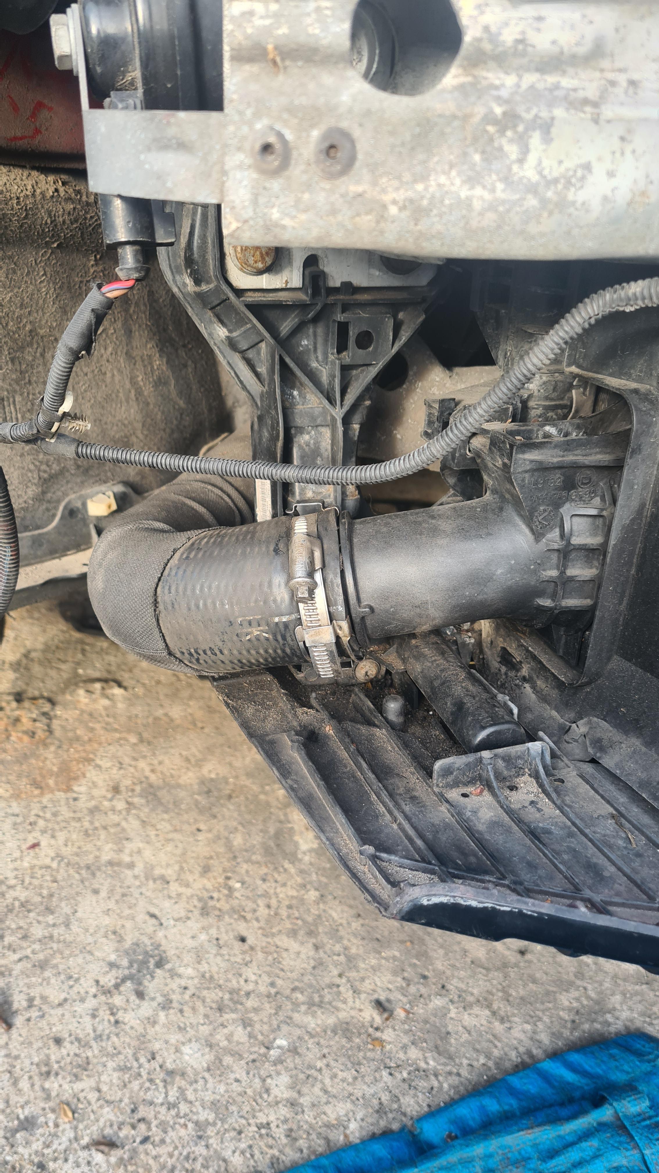

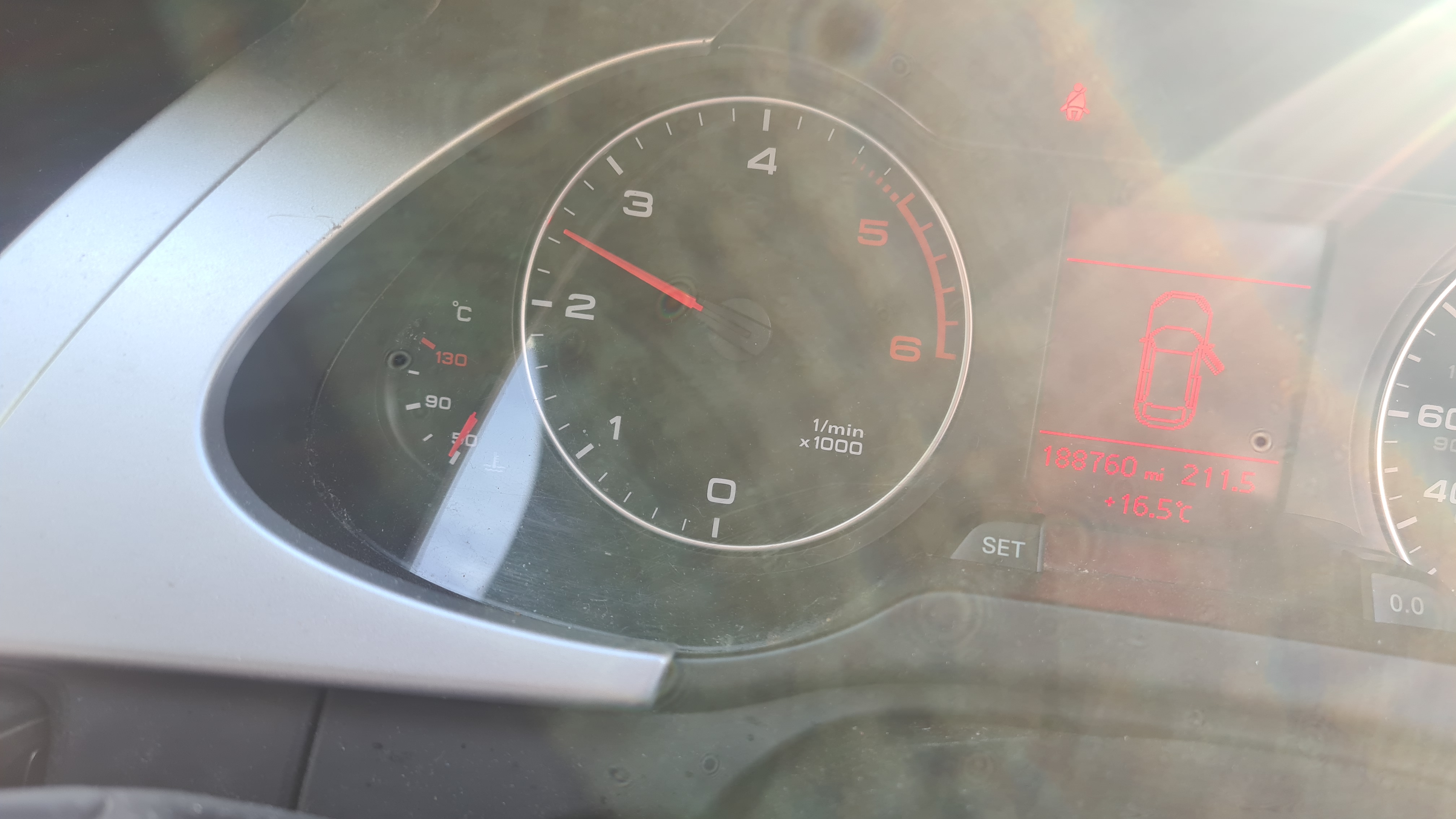

alpha omega Posted May 21 Author Share Posted May 21 started the car up and left it to idle and it now idles fine.no rough idling....i thought great,until i went to rev the car up and its only giving me 2,500rpm......taken the front bumper off this morning as i thought this pipe(see pic)had come lose like it did once and had power loss...checked the connector to the turbo all fine checked other pipes and connectors all ok.....plugged the snap on in....no codes.....any ideas please. stuck with car on ramps this morning.lol..21/05/23 Quote Link to comment Share on other sites More sharing options...
alpha omega Posted May 21 Author Share Posted May 21 update put the car back together still 2500rpm at standstill took it for an italian tune up.it gave power when needed but no higher than just over 3000rpm still powerful enough but not the 4500 i used to have at standstill.still no codes.no warning lights on dashboard.i will have to look into what steve Q has mentioned the dpf as i have symptons of low power,bit of black smoke from exhaust,diesel fuel odour in the cabin,reduced fuel economy.i thought Audi may have picked up on this on thursday the 18th of may as i asked for a health check on the engine. pleased Audi realised about the timing though phew.. Quote Link to comment Share on other sites More sharing options...

Stevey Y Posted May 24 Share Posted May 24 2 hours ago, alpha omega said: strange revs have come back now. knowing my luck not for long lol Hi Steve, the car won't rev above 2500 standing because it has a built in rev limiter to stop that sort of activity and the moronic element from smashing the granny out of the cam belt and valve gear, it ain't like the old days where some used to get a kick out of listening to valve gear bounce and compression rings chattering, the whole process works on reciprocal force I.E. weight counterforce against the driven speed of the engine, the two forces balance each other out. Steve. Quote Link to comment Share on other sites More sharing options...
