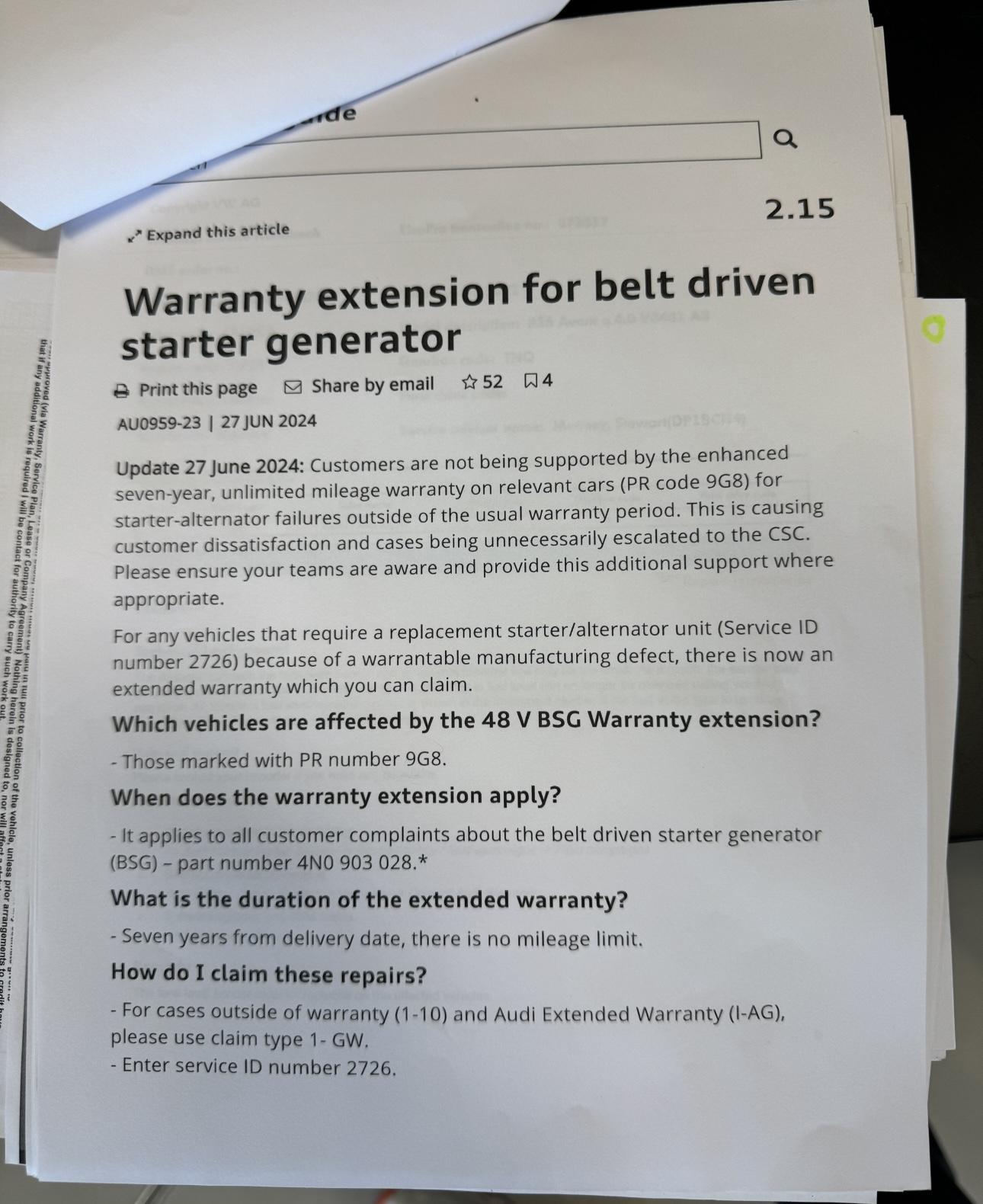

MC-10233377-0001.pdf
@CharlotteW  This may help me as it does not seem to be model specific. Is an internal bulletin?
As far as I'm aware it's from Audi's "hub"

Collected my A7 from garage this morning. Full repair was done under the 7 year free extended warranty.
Ive got the written report etc and will share later once scanned it.
The Audi free 7 year warranty exists, do NOT let anyone at Audi fob you off.
Tell them about all of us with same problems, print this forum if necessary and show them, tell them u are fully aware of rhe USA and UK warranties.
Audi garage will always insist on carrying out their diagnostic check (£150) as first step. But dont worry re that cost as it will be covered by the 7 yr warranty. I didnt pay for anything.

Where did you get a copy of the warranty I’ve been looking and cannot find it
If you look back through this thread, copies of the Audi Bulletins have been posted.
4 hours ago, Bingomighty said:
Thanks for sending that I’ve printed off to take with me. Everything I read seams to say Audi will replace the alternator if it’s failed so I’m unsure as to why people are having problems ?? Guess I’ll find out next week when mine gets looked at.
... If your car is absolutely knackered and immobile I would hope that word has got round to the extent that *most* dealers know what they are doing.
However, if it's failing or intermittent, many dealers will do everything possible to fob you off or open your wallet, because they are afraid they won't get reimbursed.
