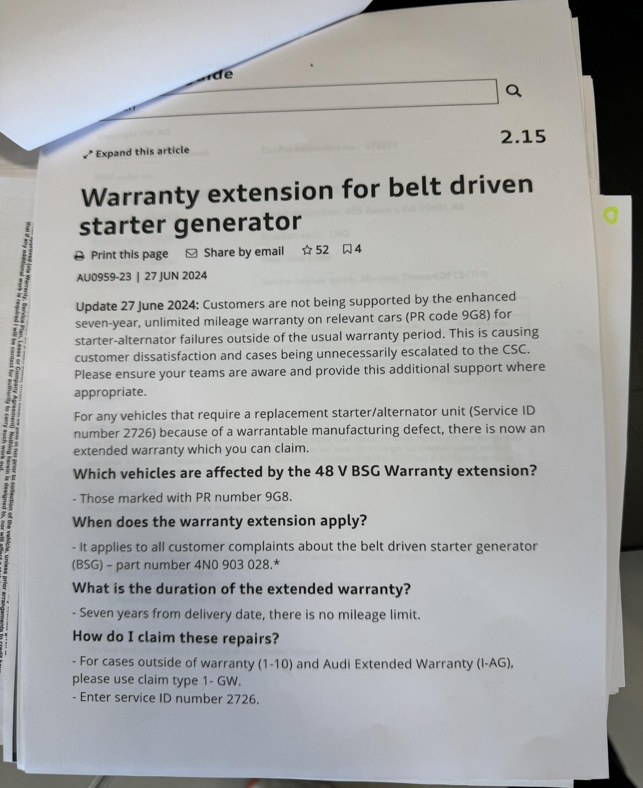

My 2020 Audi A6 Avant 50 Tdi Quattro was fixed FOC. However, this was only after I showed a copy of the website. Customer service was excellent once they were on it.

The key to this is the Audi service information
If your car has the correct PR designation 9G8 (check the sticker on the inside of your handbook) and the part which is faulty is the generator with the number on the attached notice 4N0 903028, that is clearly within the scope of the extended warranty, so Audi should cover the cost of the replacement (improved generator with a different part number).
Er, yes I agree !
In practice, life is not so simple as you portray.
The complication is getting many dealers to
a) Correctly identify the issue with charging (12v, 48v, control unit, BSG) if the BSG has not *failed*
b) Not charge you or ask you to underwrite significant investigation costs if the fault is intermittent, or root cause is not clear.
c) Recognise the 7 year warranty without showing them the Audi edict.
