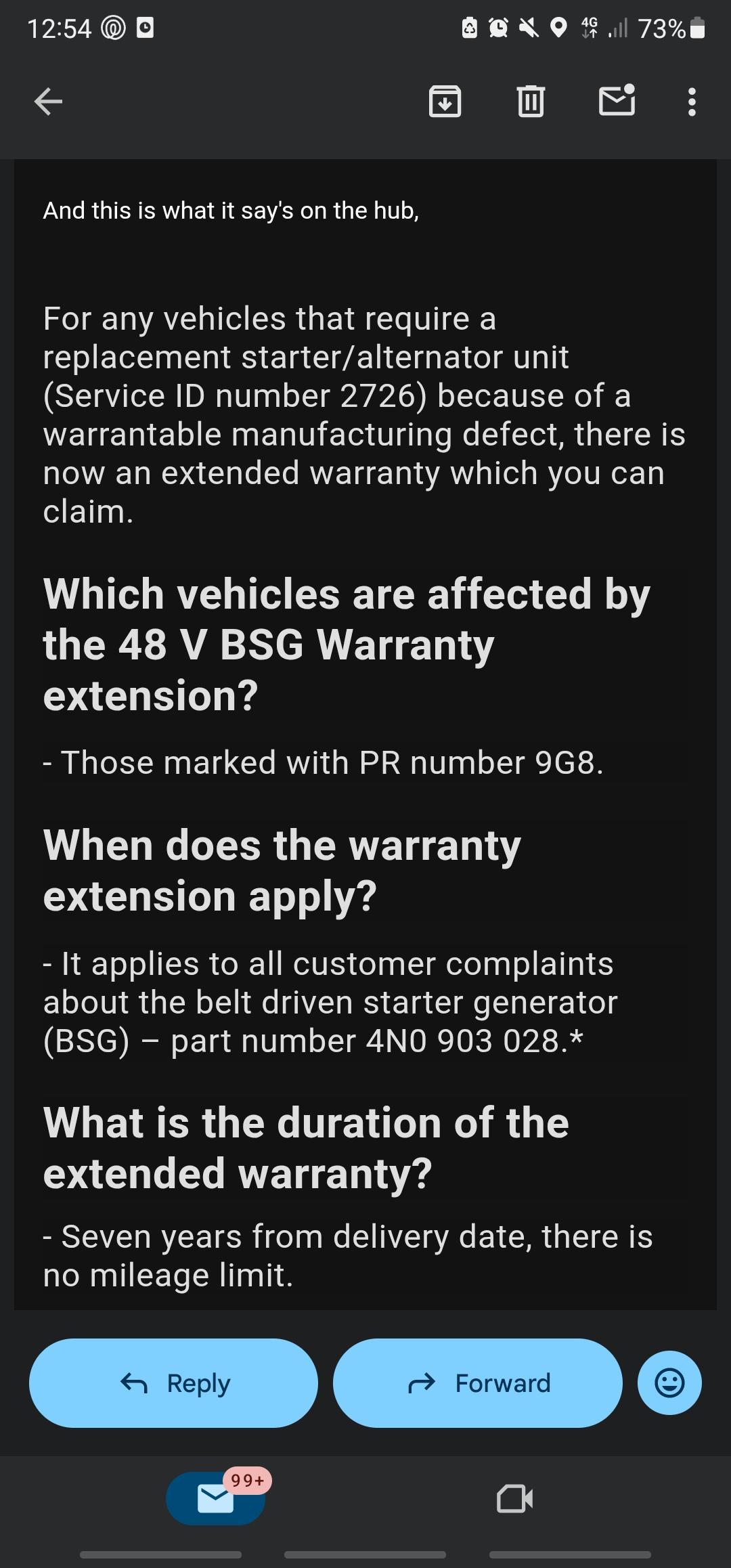

When I got this trouble with alternator (A6 C8 3.0 diesel, 80Tkm) I reported to Audi dealer. Brought the vehicle to the dealer and they told me themself that the alternator was under 7-years warranty. Thus, replacement absolutely free of charge. No escalation, nothig was required. Main point is that: there should be failures in the control module of alternator. Germany.
If I were you, I would clear the matter with Audi headquarter in the UK. They must confirm you the alternator is under extended warranty.

Thankfully, we knew someone that worked there that could send us the recall bulletin from Audi - I left a copy of it in the car and took a copy to the service desk armed and ready. Was also told that I'd have to pay diagnostics if that wasn't the problem, but came back pretty quickly it was the alternator. Audi also paid for a like for like hire car as they had nothing available - funnily enough when they realised how much it was costing the the car was fixed about a week quicker than they estimated (I was under 25 and costing them about £300 a day in insurance from enterprise for the E-class we were given!). This was Audi Sheffield, for reference. Thankfully, we've just collected our new car and PX'd the Audi!

There was no recall. Audi just waited till the alternator failed thn took responsibility.
