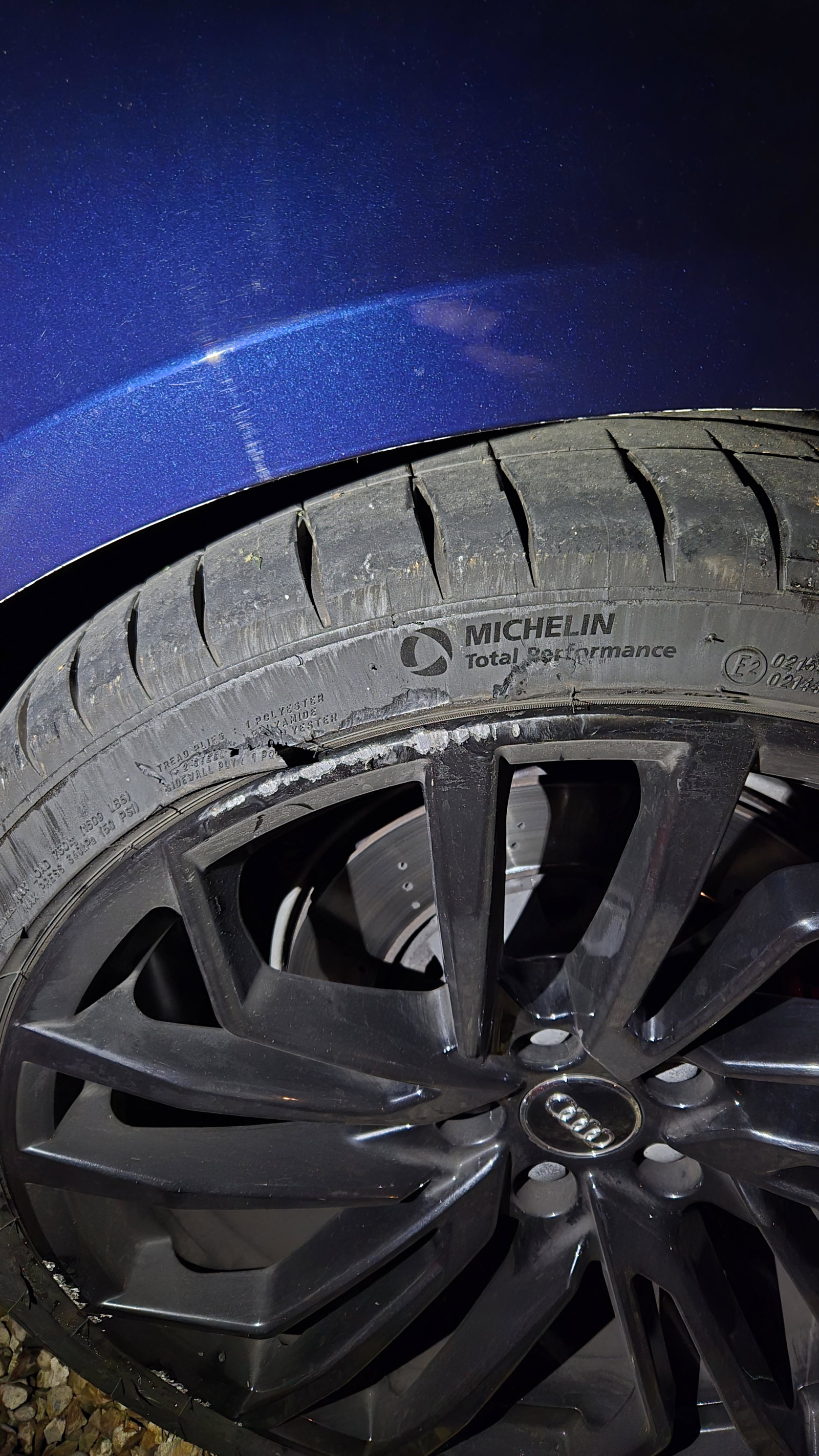

Notice my lights go directly into neighbours house as I approach a shared drive. Dip them, not see a raised kerb... you know the rest.
Off to see if the cut means a new tyre and thankfully I have alloy insurance.

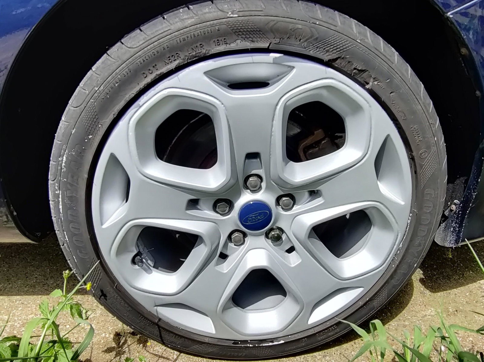

Been there myself with my last car.
If it was just the rim protector lip you would be OK, but it does look like you've taken so chunks out of the actual sidewall on the first picture so I'd say replace, especially on an RS4.

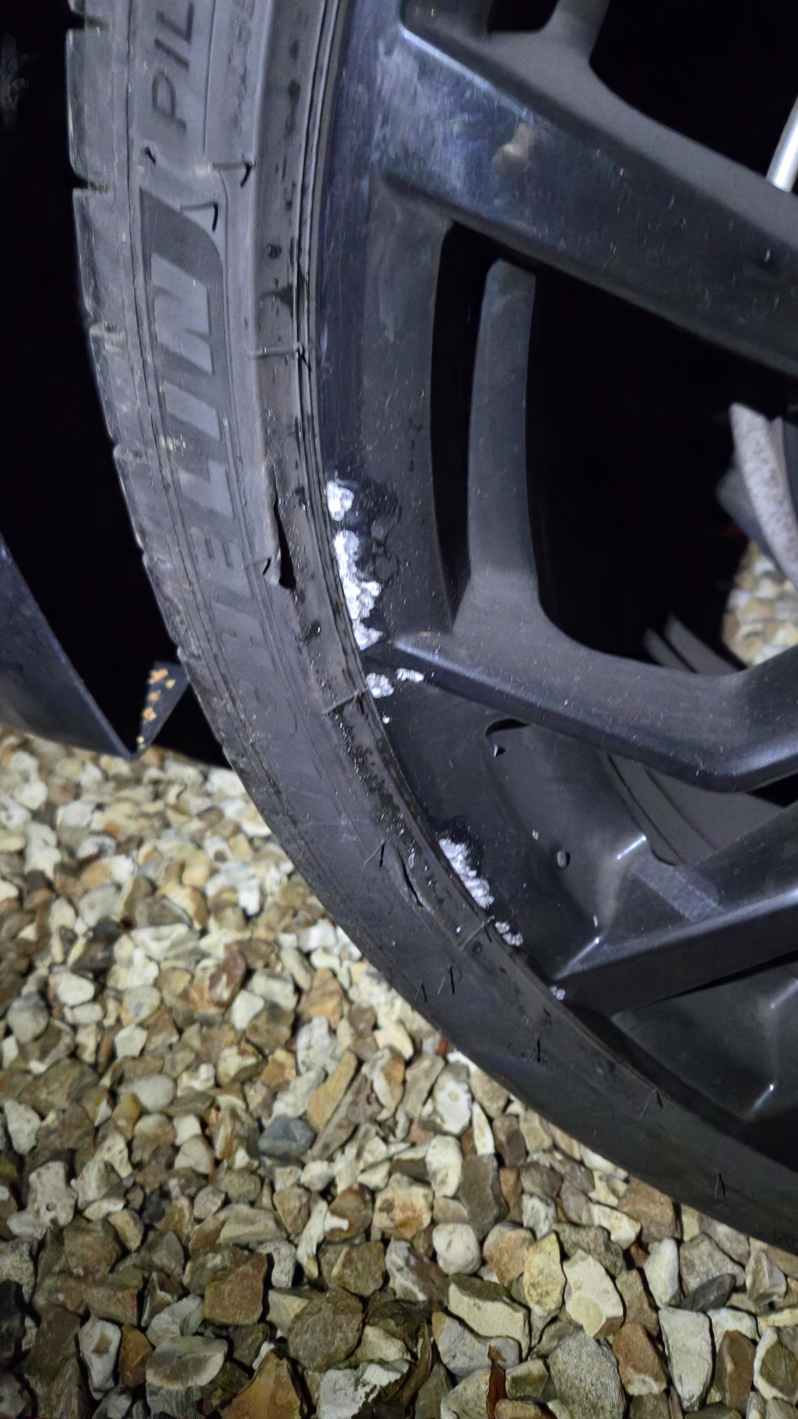

Took it to a tyre centre and they've said it is fine. It is on the reinforced wall bit, typically designed to act as a scuff guard for the alloys. I will keep an eye on it and ask the repair specialist to take a look when they come to do the alloys (I've got tyre cover too).
Such a moron for not paying more attention! It looks so ugly.

I guess I trust the advice of someone who saw it in person and who works with tyres all day vs. a couple pictures shared online. But I am happy to take it to another place later today to get a second opinion.

Yeah, he was totally unequivocal about it too. No "well, I would, but it is up to you". Said it was absolutely fine and the edges were designed for that reason.
Going to another tomorrow to be on the safe side!

Hi any damage to a sidewall is a big NO and will get you nicked if you are stopped that would never pass an MOT, showed the picture to my friend who is an MOT tester, his comment, Nah!
When assessing cuts in a tyre, it is permissible to check whether a cut is deep enough to reach the ply or cord by using a blunt instrument to open the cut taking care not to cause further damage.
The following criteria should be used when assessing a cut in a tyre:
any ply or cord that can be seen without touching the tyre - fail
if by folding back rubber or opening a cut with a blunt instrument, so as not to cause further damage, exposed ply or cord can be seen irrespective of the size of the cut - fail
if a cut which is more than 25mm or 10% of the section width whichever is the greater, is opened with a blunt instrument and cords can be felt but not seen - fail
Before failing a cut, you must make sure it’s the cords that you can feel not a foreign object. If you’re not sure, then you should pass and advise.
https://www.gov.uk/guidance/mot-inspection-manual-for-private-passenger-and-light-commercial-vehicles/5-axles-wheels-tyres-and-suspension#section-5-2-3
If cords or ply are not exposed then it shouldn't be a fail. The pic I posted above went through at least 1 MOT and wasn't even an advisory.
Appreciate all of that Mark, but the acid test is whether a responsible driver of a performance car would take any risk in driving such a car with visible damage to the extent shown, particularly since it will boil down to an increased potential for failure vs. some tens of £s to get it sorted via. the insurance cover held.
This question is asked on the basis of a ‘ Professional opinion’ of ‘…well I would, but it’s up to you’.
That's incorrect. The person who assessed it said it would be absolutely fine and not to worry. I then said I'd replace it when back home in Surrey (we are away this week) and he said that would be a waste of money and totally unnecessary.
Ill be getting another assessment done before we return home. I'm paying for a mobile service to come and assess. But that'll be three professionals looking at it then.
I do appreciate opinions here, but I value that of professionals more.

That's the thing though, the rubber coating on the sidewall has no strength in it, all the strength is from the carcass ply and steel belt plies. The rubber on the sidewall is to protect those from the elements, so if there not exposed then there is no degradation of the strength of the tyre.
I really can't understand anybody even considering driving a car with tyre damage such as this. It not only your families safely, think about others on the road you may injure with a blow out!
Lots of strong opinions on here. Thankfully, I've spoken to professionals and they align with Mark M's comments.
I forget how terribly emotional and vocal people can get when their opinions are not followed. I do appreciate the passion, but in this instance, I'll go with what the pros say.
If there was any indication at all safety was compromised, I'd just replace the tyre. However, the resounding feedback for this tyre is it is cosmetic and I can replace if I am precious about it looking ugly but it has zero impact on integrity or safety of the tyre.
