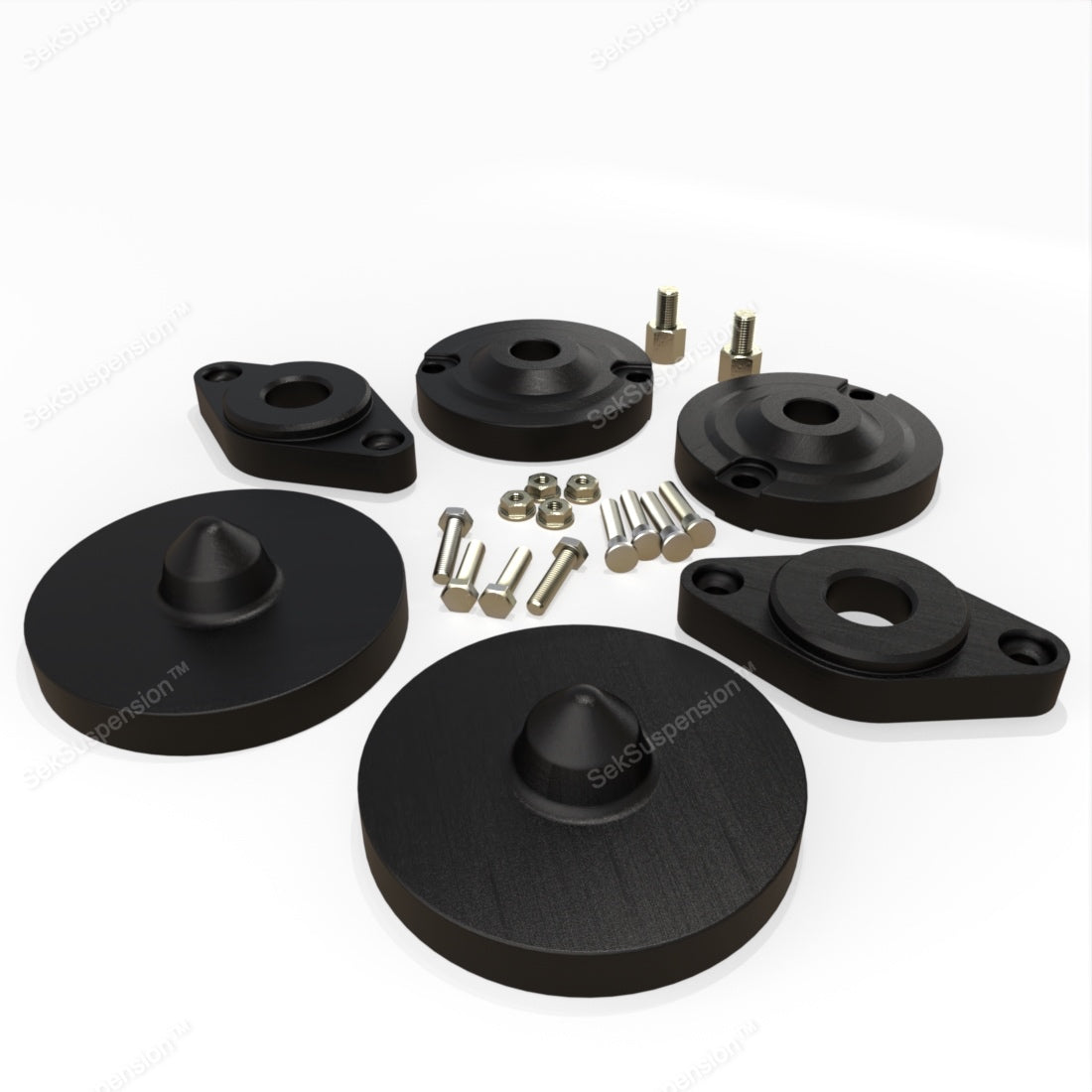

That's good then, if you think the b6 will work with the 30mm drop with eibach. My worry is that the car would scrape on sports suspension which is a 20mm drop so dropping it later I crease further risk of damage.
I guess the alternative is to do away with sports suspension and buy standard suspension instead to increase ride height to negotiate speed humps and rough roads.
Or do I just get the eibach and bilsteins for the improvement but then fit raisers like this:
SekSuspension
No image preview
Audi A6 C5 Suspension Lift Kit
Polyurethane strut spacers. Leveling kit for Audi A6 C5 1997 -2004 2th generation. Raise the height of the car 20mm 30mm 40mm. Installation Hardware Included.
Again I'd appreciate your thoughts on that. I know I'm going round the houses with making a decision but I want it to be right.
If it makes any difference the A6 has the 3rd row seats in the boot and tow bar.

Hi just use standard springs and the B6 shocks the outcome will be the same better handling without ground clearance issues, with regard to the brakes why bigger?, if you use standard discs that are high carbon ATE, MEYLE, they will be more than adequate especially if you use Comma ESP4 fluid and Delphi or Brembo pads, I use the same on my cab and believe me with the milage I do they stop every time and with regular fluid changes I get loads of miles out of my brakes, it works, your braking system was designed to meet every possible contingency of highway driving unless you decide to track day the car, I went through this with my Titanium X Sport Mondeo Estate and what I have described works, as soon as you start introducing spacing hardware you create different geometry problems and with regard to the bolts see if you can get stainless replacements all problems solved.

So do away with the sport suspension (minus the b6 shocks) to raise ride height. As stock suspension was sport.
I was thinking just improved brake performance. As I'm planning to change calipers etc anyway.
Sorry for all the questions just trying to consider all options.

Hi yes you don't need stiffer springs as the B6s will effectively cope by making the spring compression much smoother and more progressive, you can use the sport springs with good effect as factory lowered is just under 25mm try Kilen springs as these are cold manufactured and very robust and won't break the bank. brakes the bigger the better is not quite true for the rears as they only even in emergency conditions receive a lower amount of pressure than the fronts which you may want to use bigger everything but I can't see the point when good quality standard discs and pads do the job, example, I was watching a police documentary with a car chase over thirty odd miles at speeds of over seventy miles per hour through country roads, eventually the officer had to pull over as his o/s front pads were smoking but his car still stopped, then ask yourself the question am I going to be doing that a lot?, good quality fluid pads and discs will do the job.
