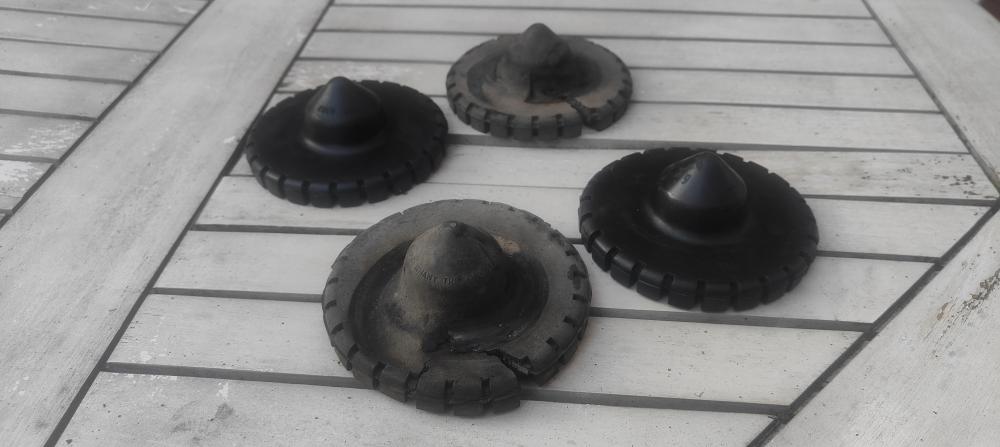

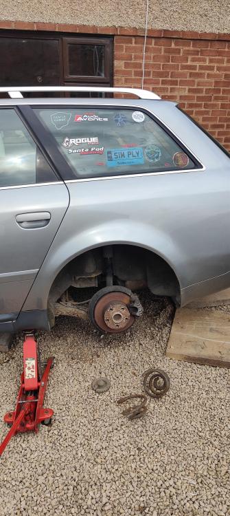

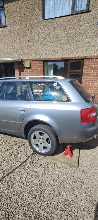

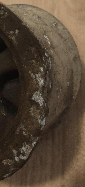

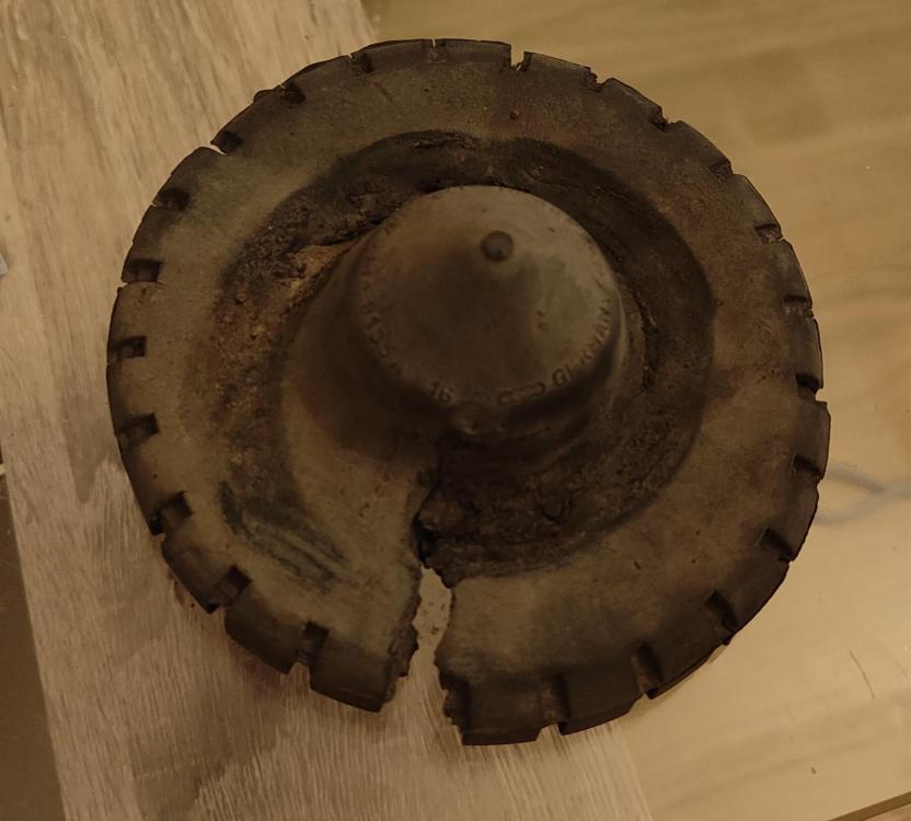

Sorry it's been a while. The A6 is booked in into a garage for engine work in July. So that gives me time to get the bits sorted. So today, my mate and I attacked the rear end. I'm aiming to replace the rear axle, brakes, suspension.
One of the rear springs had snapped and the car fought us all the way. We're struggling to get the calipers off as the bolts seem seized. This has stopped us progressing further.
Handbrake was seized one side.
Both spring rubber caps are perished and split.

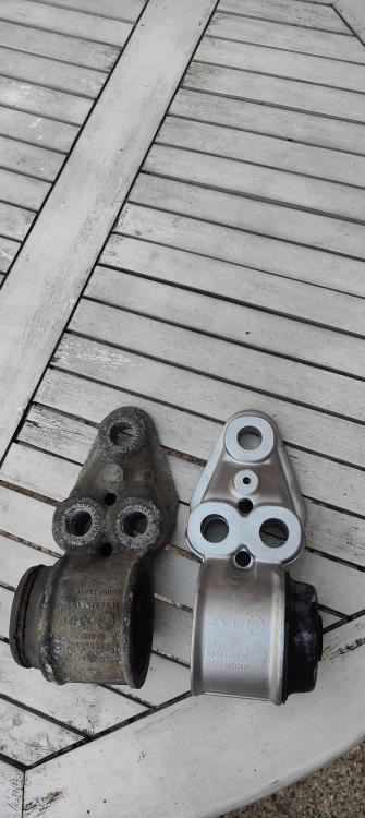

Currently trying to find a new/refurbished axle as I'm trying to prevent the situation like on this Passat. Does anyone know the passat axle and A6 2wd axle are the same?
I've contented I'm axles and another supplier of Passat b5 axes but they haven't got back to me.
I'm going to fit powerflex bushes to the axle where it mounts to the car.
