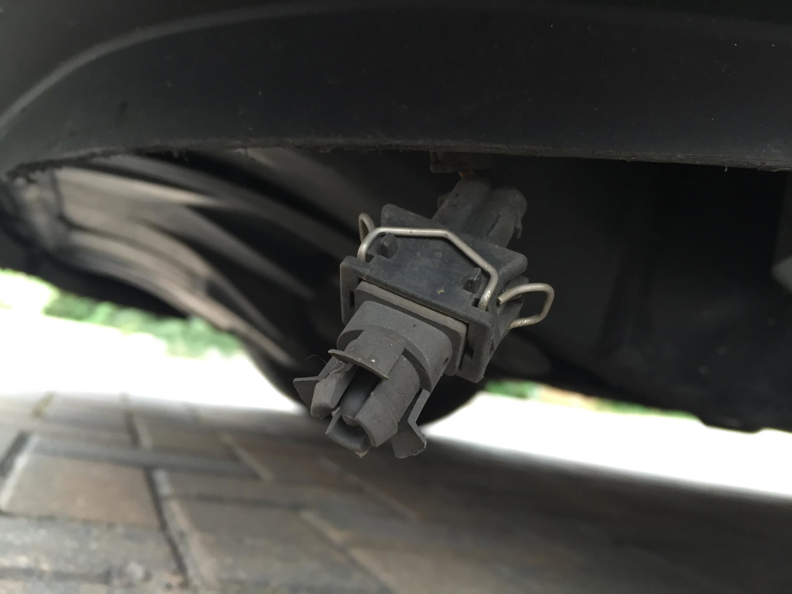

I've joined this forum in the hope that someone will be able to help my son who drives an R reg Audi 1.8T Petrol.
The attached photo shows something dangling underneath his car!
Can anyone tell me what it is and what is to be done about it?
Is the car safe to drive?
Many thanks to anyone who can help.

it looks to me to be a sensor of some sort. Is the car driving fine? In failing that does the a3 have fog lamps and if so are they both working?

I'm with Steve on this, and favour the possibility that this is a "broken off" plug for something like a fog or spot light if fitted. It would be worth checking that all the lights are working. Other possibly is that it's a dislodged horn connector. Should be two horns? - and perhaps only one working,
I think it's great you are encouraging you son to take a responsible attitude to his motoring, and introducing good thoughts of whether it is safe to drive or not. On that topic I would say it's always difficult to judge things at a distance with forum replies, so if there is any doubt on a car being safe to drive it should always be checked out for assurance at a local garage as soon as possible.
This is external temperature sensor. Nothing to worry about just needs to be cliped back on where it was

It clips into the near side lower bumper grill next to your fog light if you have them fitted.
