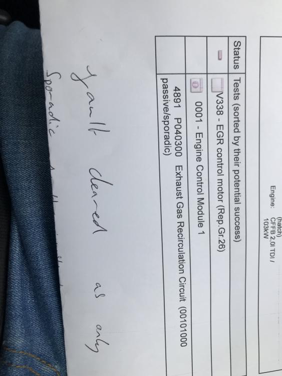

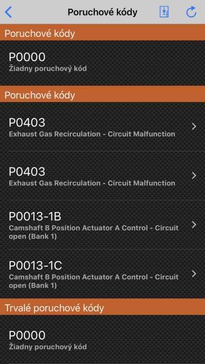

Hi, had my cambelt changed at Audi last week thursday next day on way to work my glow plug plug light started to flash and car went to limp mode, like if turbo wasnt working, plugged my OBD reader result are underneath have a look what it could be ?

No I had my cambelt change on thursday last week went home all good friday went to work my glow plug light flashing car in limp mode plugged it in showed that as in picture called audi went to see them monday yestrday morning,he said all good cleared code if come back its EGR valve? Btw the glow plug light comes and goes strange

Ok let me explain my obd computer shows 2 error code picture below one is exhaust etc that is egr and bottom one is something to do with cambelt ? Someone told me on forums, and on facebook forums as well, that timings out ? My car had recall done but before I bought it, spoke to emissions audi centre they going to change egr free of charge yes, called audi now regarding this code that my obd shows they said we only go by our computers here in Audi not by any others and they said glow plug light is fault of egr which im having done on tuesday

P0013-1b code ?

No I have bought the car from showroom in sussex I have 3 months warranty from them still, yes the egr going to be changed free of charge, spoke to audi emissions and they made claim for me with refrence, I hope everything is ok with cambelt and hope my reading are wrong regarding p0013-1b
Dont worry about other codes. They can be triggered by egr
