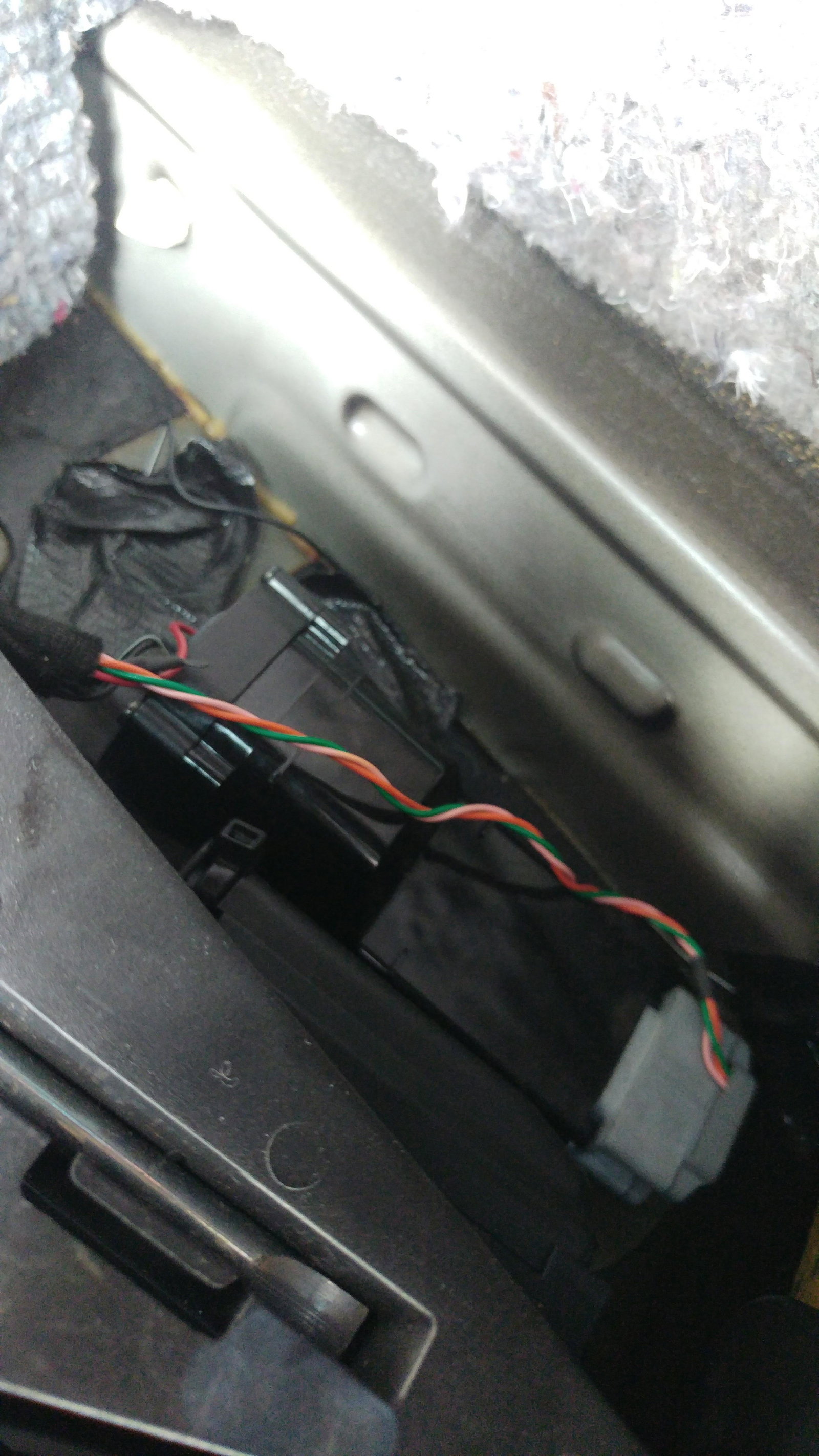

WPAWS Posted October 20, 2017 Share Posted October 20, 2017 Cheers i will look after work see if i can find it, i know where my jack and tools are is a piece of foam with a shiny black box under it, that may be it Quote Link to comment Share on other sites More sharing options...

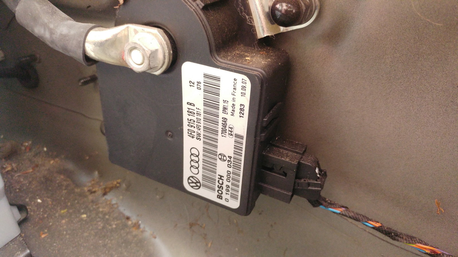

WPAWS Posted October 20, 2017 Share Posted October 20, 2017 found these 2 not sure if their the ones, 1st one contact to battery 2nd one under tool kit and jack Quote Link to comment Share on other sites More sharing options...

WPAWS Posted October 20, 2017 Share Posted October 20, 2017 I have spent over an hour on google trying to locate the location of the module that allows me to sort the mmi display for parking and can not find where its located, may be i just dont have that module on my car Quote Link to comment Share on other sites More sharing options...
niedzial1983 Posted October 20, 2017 Author Share Posted October 20, 2017 34 minutes ago, Paul A6 said: I have spent over an hour on google trying to locate the location of the module that allows me to sort the mmi display for parking and can not find where its located, may be i just dont have that module on my car If you have rear or rear+front pdc then the module is there. Best way to check is via vcds Quote Link to comment Share on other sites More sharing options...

WPAWS Posted October 20, 2017 Share Posted October 20, 2017 10 minutes ago, niedzial1983 said: If you have rear or rear+front pdc then the module is there. Best way to check is via vcds i have rear parking sensors so just need to find someone close who has vcds, may try a local garage and see if they will do it Quote Link to comment Share on other sites More sharing options...
