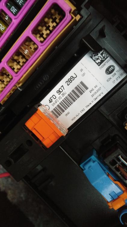

nah dont have the correct one mine is 4f0 907 289 j after a little searching mine is a Comfort Control Module
Its not the comfort module . Its the parking assistance module that you need to check
am i in the right area? plastic cover on drivers side rear?
Looks like this
