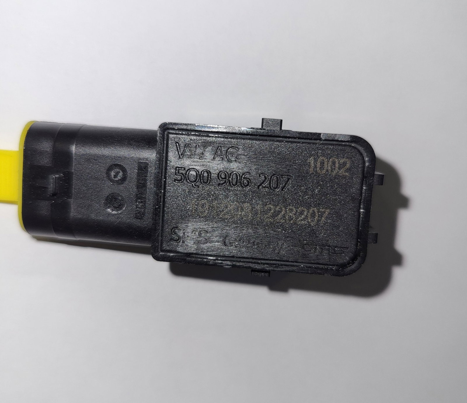

C123 Posted September 4, 2023 Share Posted September 4, 2023 (edited) Yes I also got 5Q0906207, not 5Q0906207A or 5Q0906207B - dealer said all the same part and A and B were just a different batch or something. Let’s hope that whatever the part number, these ones actually work and don’t ‘brick’ the ABS!! Edited September 4, 2023 by C123 Quote Link to comment Share on other sites More sharing options...
