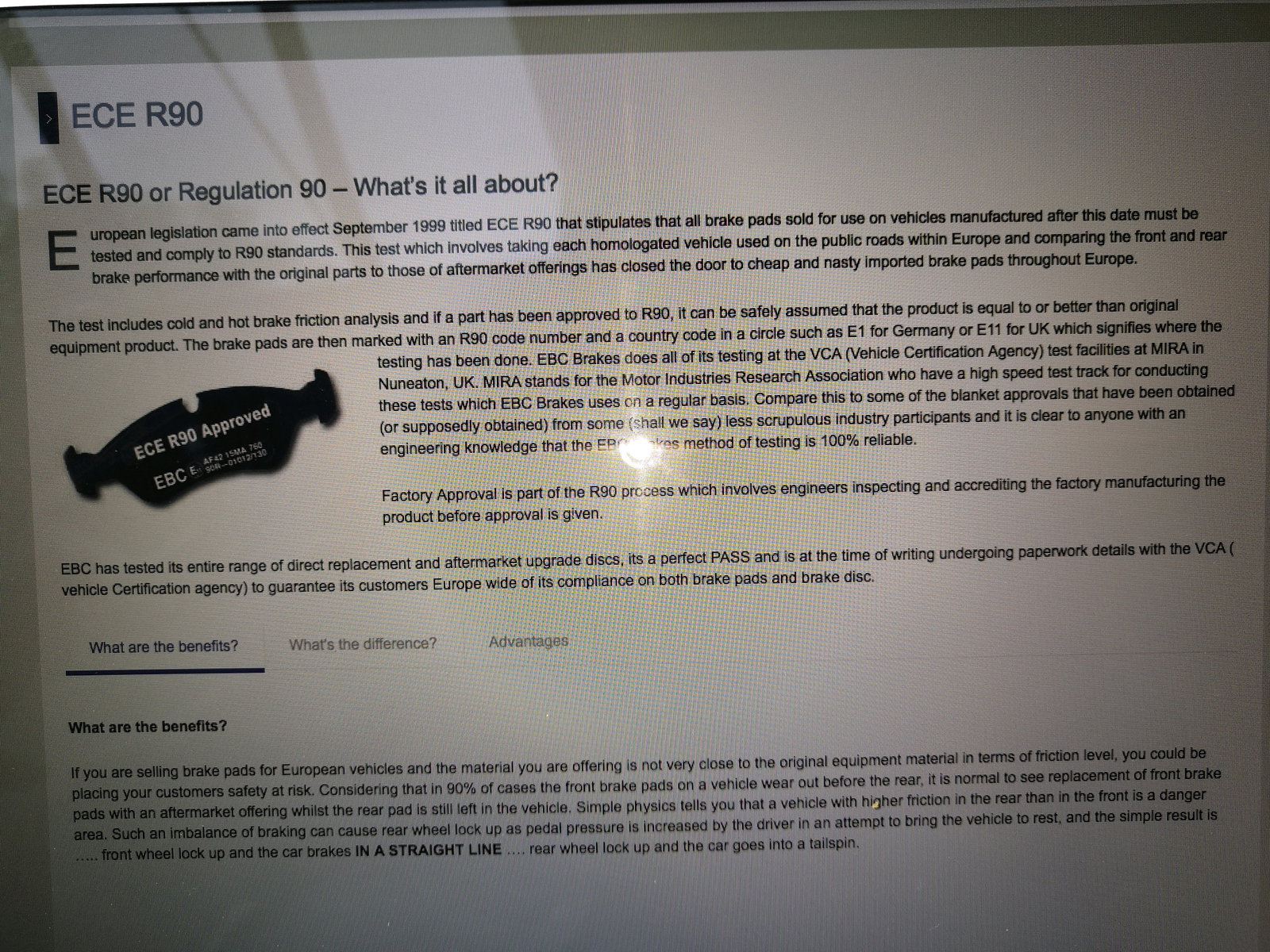

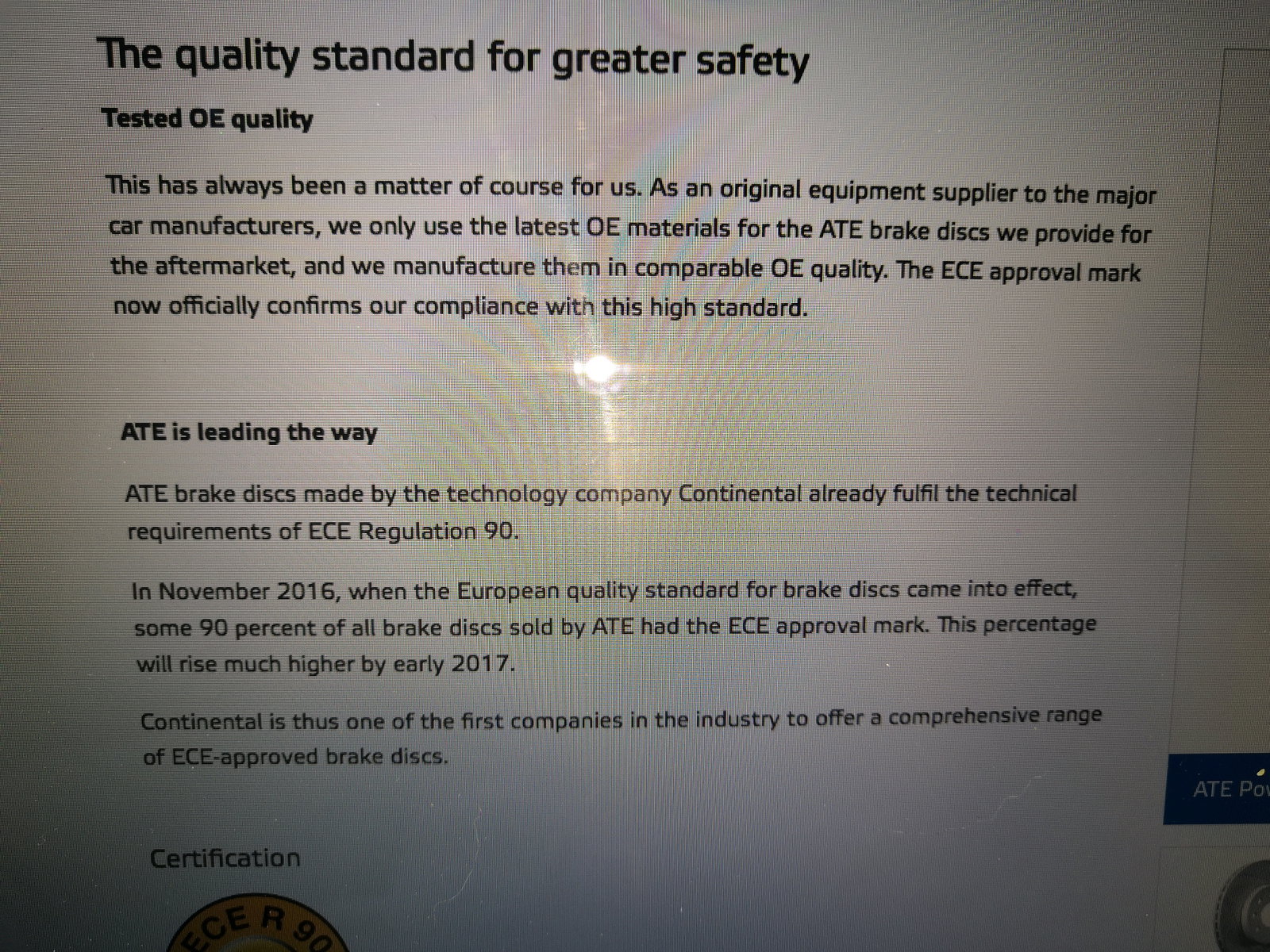

Gareth try and disagree with the above, both are high profile manufacturers of braking consumables to both aftermarket and motor manufacturers, I really don't think they would publish either of these statements if there was even a hint of culpability if the information is wrong, I would draw your attention to the first paragraph of the EBC blog and then to the first paragraph on the ATE blog, they state that both OE and aftermarket are manufactured to a comparable standard to achieve certification.
