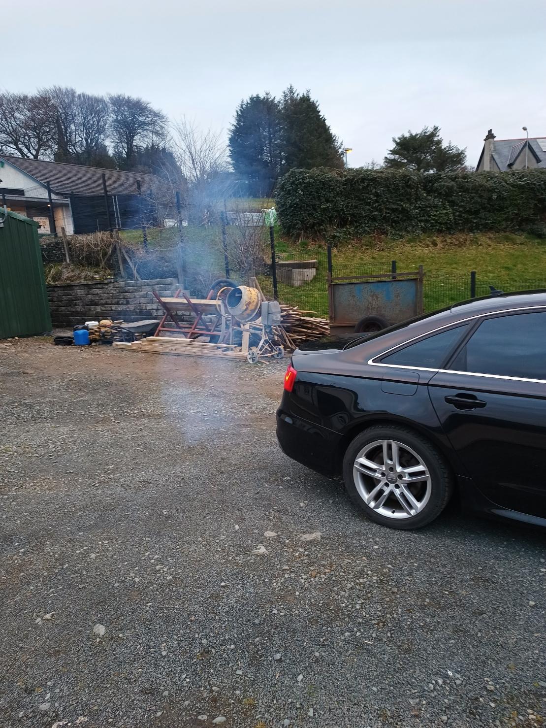

Kev555 Posted January 6, 2022 Share Posted January 6, 2022 (edited) Hi all my first post here since joining a couple of months ago. I have a 2013 A6 C7 3.0 TDI. Occasionally when the car stops in traffic it starts putting out excess smoke which stinks of diesel. I thought about the injector issue which I heard was in earlier models? but its too intermittent for an injector I think as I can drive around long and short journeys for a week and no issues and then it arises on a short trip and its gone the next morning? I'm thinking faulty temp sensor or EGR? Any techs or forum users come across this before. help narrowing this down appreciated to speed up diagnosis. Edited January 6, 2022 by Kev555 Quote Link to comment Share on other sites More sharing options...

Kev555 Posted January 25, 2022 Author Share Posted January 25, 2022 (edited) Finally got round to looking at the A6. I went through all the live data and could not find any tell tale signs from sensors etc. I dumped a can of purge cleaner in the tank for a few days to see how that goes. After test driving it yesterday I find that once the A6 is at normal temperature and after every lets say 5 mile run it smokes at standstill for about 1-2 mins then clears and is fine after that until you go for a run again. I'm thinking DPF issues at this point and next step i suppose is doing a regen. I tried a stationary regen with my icarsoft but just seem to get errors as if I'm not meeting the criteria correctly? Temperature on the 02 sensors seems to be reading ok but some data from the DPF seems to be missing making me think its possibly been mapped out of the system if thats possible? or my icarsoft pro isn't fully compatible with the ECU. Any thoughts out there or should i just continue to suspect DPF? Edited January 25, 2022 by Kev555 Quote Link to comment Share on other sites More sharing options...
Kev555 Posted January 25, 2022 Author Share Posted January 25, 2022 Managed to get a stationary DPF regen done today with another laptop. Ran for half an hour and medium diesel smoke the whole time during the regen similar to what it does when coming to a stop after a run. DPF is showing zero soot and info is a bit off from it. I'm wondering has it been doctored? Quote Link to comment Share on other sites More sharing options...
Kev555 Posted January 26, 2022 Author Share Posted January 26, 2022 (edited) Unplugged the MAF this morning as Steve suggested this could also be at fault and went for a 30 mile round trip. No smoking whatsoever at standstill during the journey. Should I order an MAF or would it not stop smoking anyways with the MAF unplugged even if it wasn't at fault? The temperature sensor seems to be behaving normally in diagnostics data and DPF doesn't seem to be the issue although cant be 100% sure. Could any Techs or forum members help me confirm the MAF, sorry if the info I posted so far isn't enough. Edited January 26, 2022 by Kev555 Quote Link to comment Share on other sites More sharing options...
