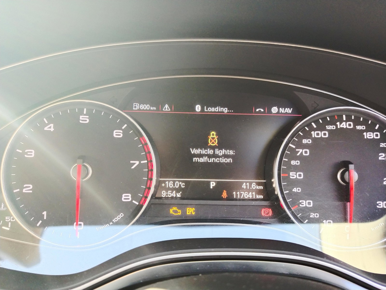

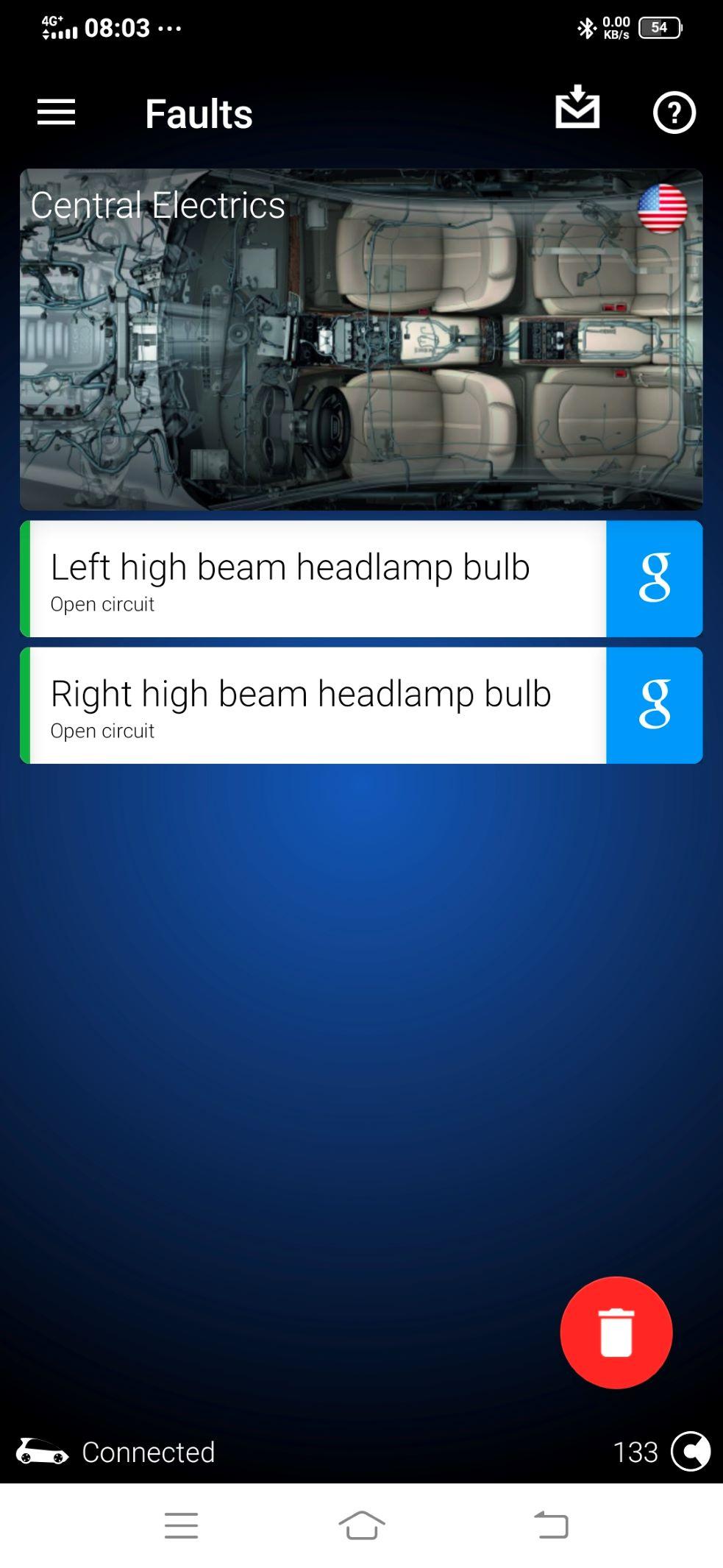

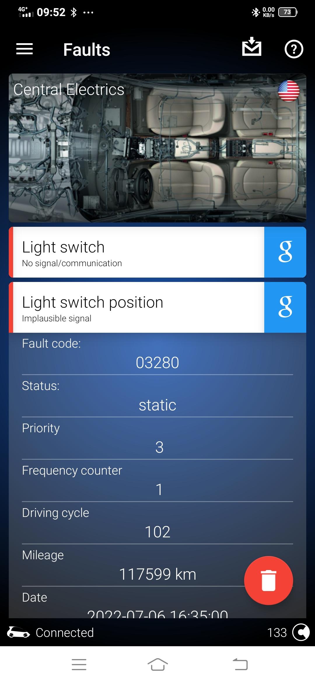

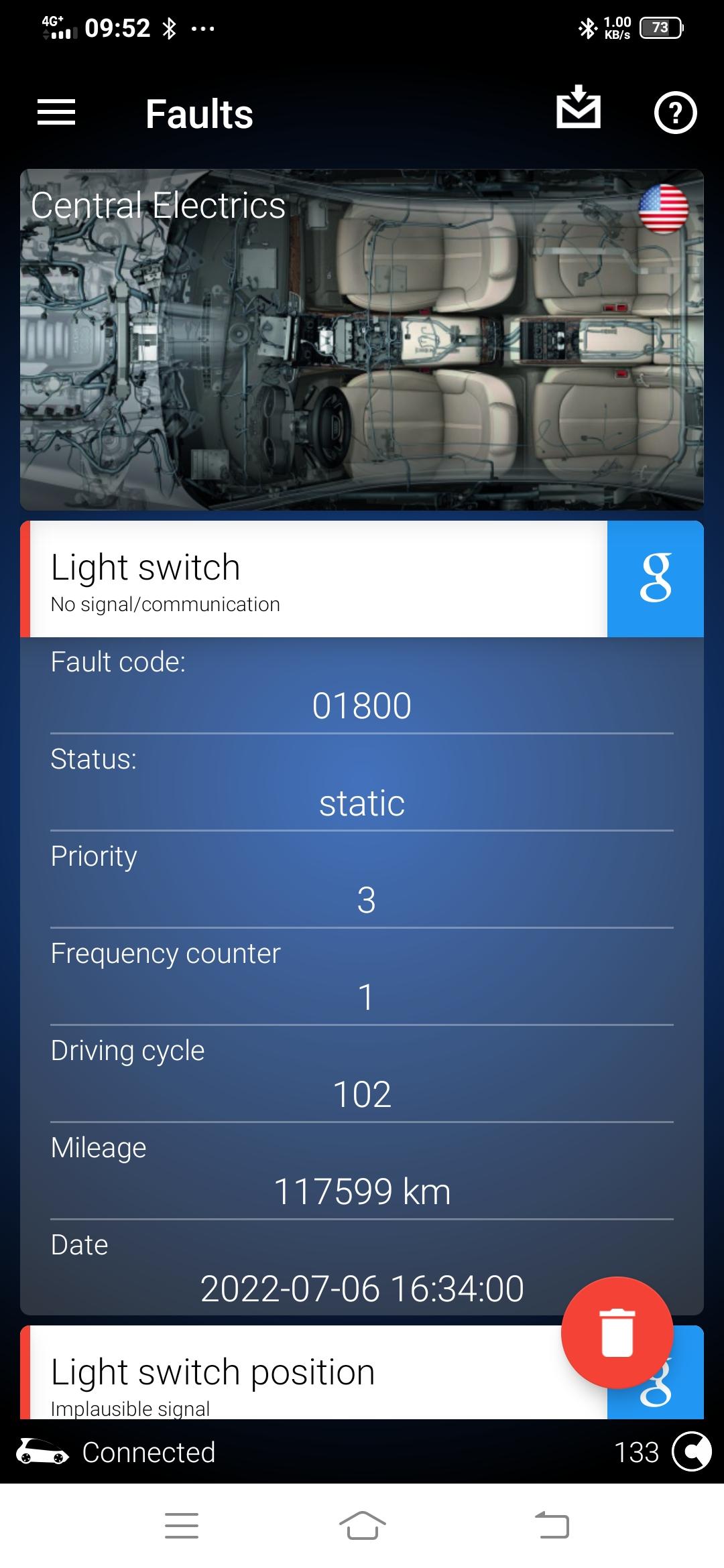

yay 6 Posted July 8, 2022 Share Posted July 8, 2022 Hi, I have an error message " Vehicle lights malfunction" on the dash. I have checked, and all the lights appear to be working, no bulbs/leds appear unlit. A scan with OBD11 reveals the following faults: The faults cannot be cancelled. Any thoughts on what might be causing this? Thanks Quote Link to comment Share on other sites More sharing options...

Steve Q Posted July 12, 2022 Share Posted July 12, 2022 Could it be an issue with the switch or ballast boxes in the headlights? Quote Link to comment Share on other sites More sharing options...

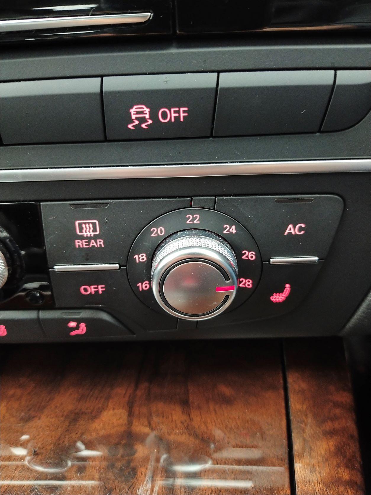

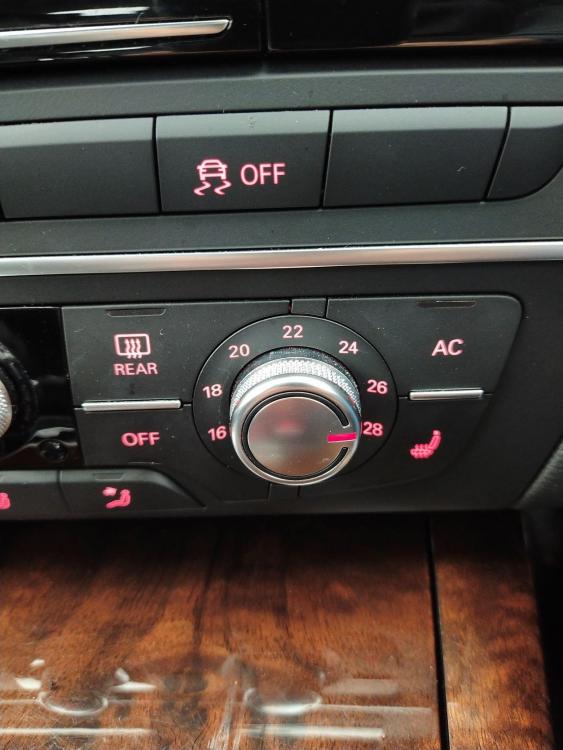

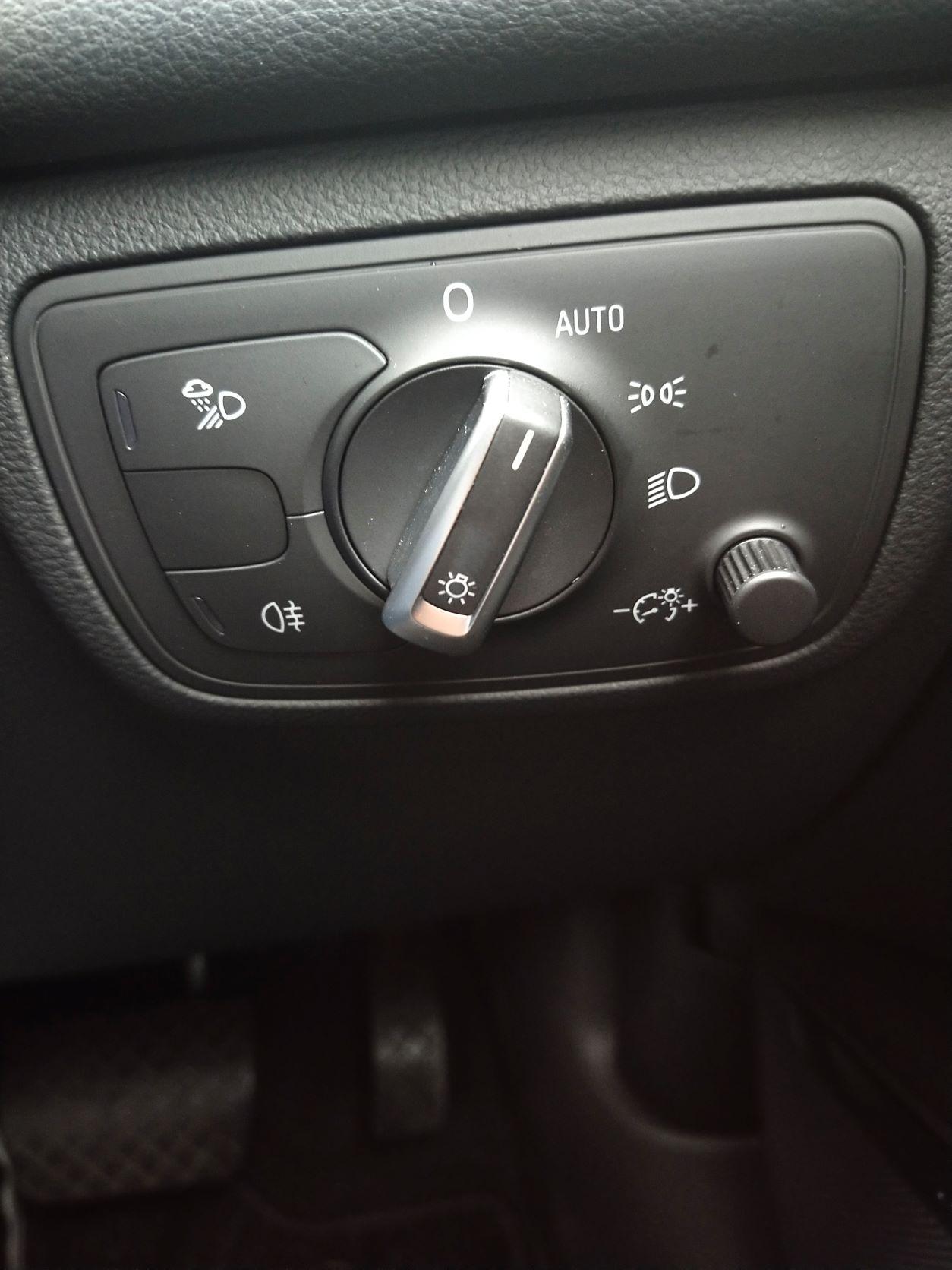

yay 6 Posted July 14, 2022 Author Share Posted July 14, 2022 A little more information on the problem: The light selector switch and the indications around it do not light up but all the other switches do. Further, the headlights and taillights turn on, even in daylight, irrespective of the position of the light selector switch. If the switch is in the "Auto" position, and the door is opened with the ignition turned off, the buzzer goes off until the selector is turned to the off position. Quote Link to comment Share on other sites More sharing options...
Steve Q Posted July 14, 2022 Share Posted July 14, 2022 I'd look to change the switch as a starting point. Quote Link to comment Share on other sites More sharing options...
yay 6 Posted July 18, 2022 Author Share Posted July 18, 2022 Ok, will order one and post the result Quote Link to comment Share on other sites More sharing options...
yay 6 Posted July 18, 2022 Author Share Posted July 18, 2022 ....and now, my wife's car, a C7 sedan 2012 2.8fsi. High beam does not work, either in flash mode or full high beam. The blue indicator light on the dash comes on when the stalk is pulled. A scan with OBD11 came up with the message "open circuit". I erased the message, but the high beam still does not work. Quote Link to comment Share on other sites More sharing options...

yay 6 Posted November 1, 2023 Author Share Posted November 1, 2023 Unfortunately I could not fix the issue myself. A trip to the auto electrician, $$$ and mumjo-jumbo explanation later, the lights are now functioning. Something about the signal from the stalk not being recognised and thus a circuit board or two needing to be replaced. 1 Quote Link to comment Share on other sites More sharing options...
Mercmanexs Posted November 2, 2023 Share Posted November 2, 2023 Thanks for the response. This is the only forum that had a reference to this error. I let the car sit outside uncovered. I think leaves blocked the windscreen drains causing water to get behind the dash. Quote Link to comment Share on other sites More sharing options...
Tim2014A6 Posted November 29, 2023 Share Posted November 29, 2023 Did the A6 switch replacement fix light malfunction issue? Have same exact issue...including no indicator light on headlight switch. I replaced switch with no change to symptoms. May have to find electrical diagrams and trace... Quote Link to comment Share on other sites More sharing options...
yay 6 Posted December 6, 2023 Author Share Posted December 6, 2023 On 11/30/2023 at 10:22 AM, Tim2014A6 said: Did the A6 switch replacement fix light malfunction issue? Have same exact issue...including no indicator light on headlight switch. I replaced switch with no change to symptoms. May have to find electrical diagrams and trace... Yes, it did. Quote Link to comment Share on other sites More sharing options...
