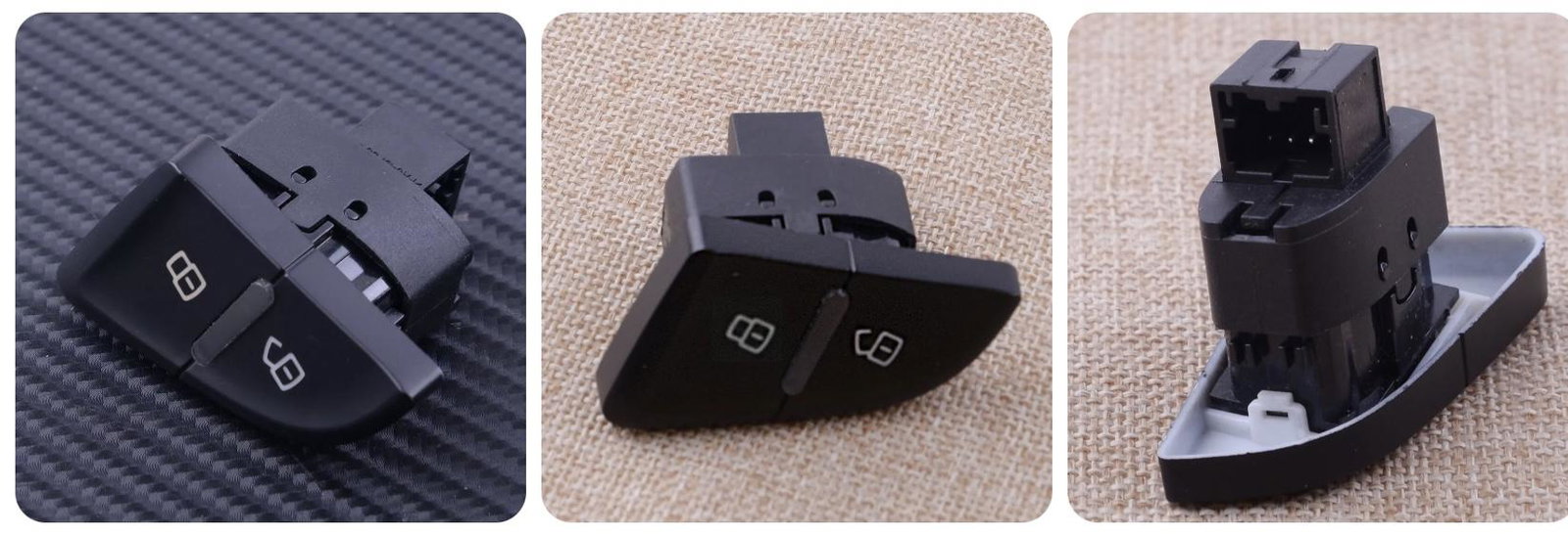

The lock/unlock switch on the driver’s side door card on the convertible has had a hard life. Since I can get a new eBay replacement for just over six quid, I thought I’d fit a new one.
Do I need to remove the door card to replace it, or can I prise it out with a spudger or similar?

Well, good news and bad. You do need to remove the door card to change the switch, which is held in place by a couple of metal spring clips. None of the new style door card clips broke when removing and refitting the card! 😃
Unfortunately, that's the end of the good news. The switch I'd bought from eBay has a different connector on it - so couldn't be used. Plus I ham-fistedly managed to break the old switch getting it out 🤦‍♂️
To rub salt into the wound - Audi have discontinued the switch (part number is 8E2 962 1085 PR), so I've ordered a used part from eBay, leaving the plug hanging out of the hole in the door card.  It'll be a simple matter of connecting the plug and then popping it into the housing when it arrives. I'm going to see if I can replace the cover (which was the only snag) of the switch when it arrives with that of the switch. I bought it from China, and I'm not going to bother going through the rigmarole of returning it.
