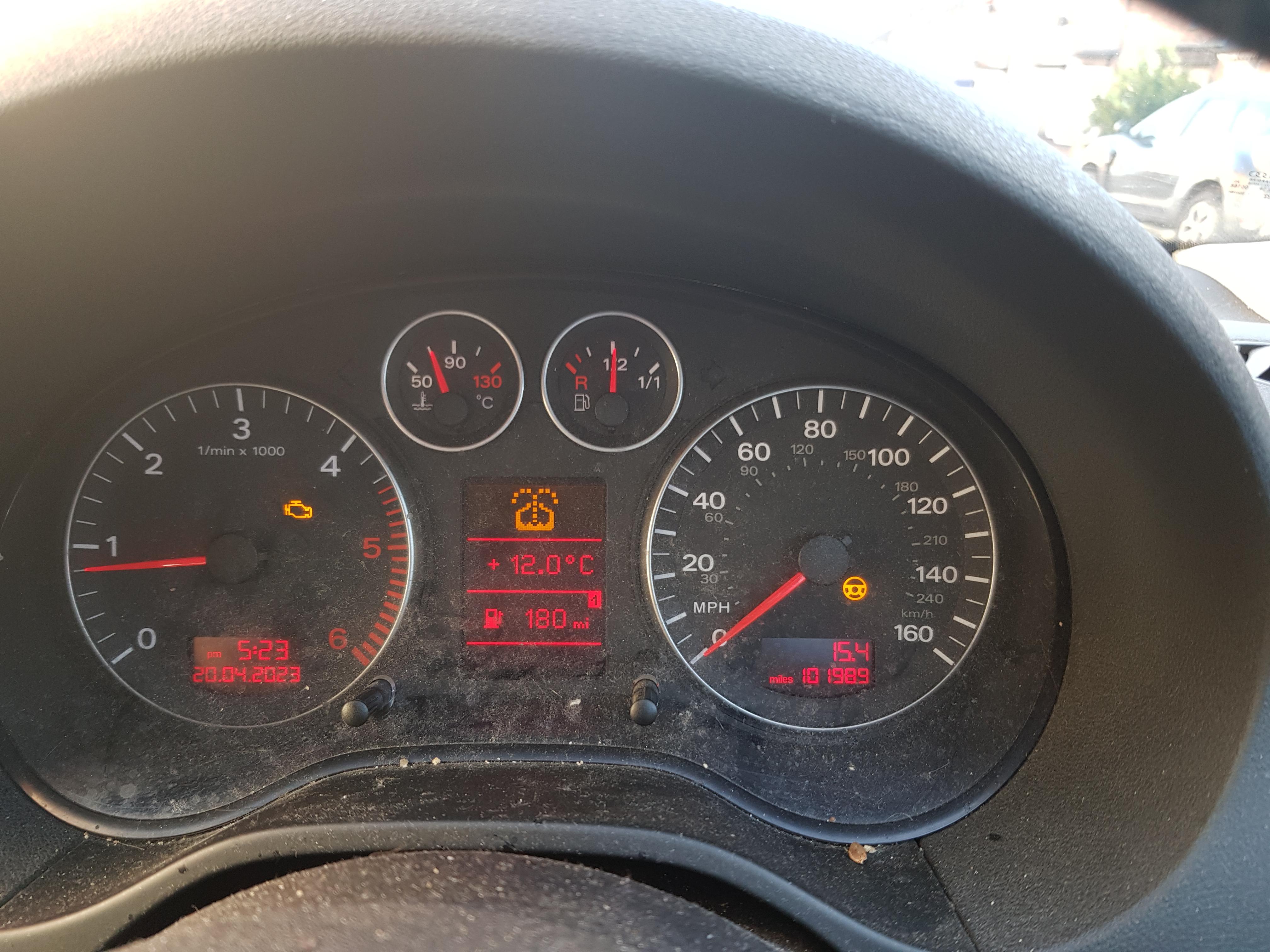

AudIanMc Posted April 20 Share Posted April 20 (edited) So I failed my MOT recently due to: Anti-lock braking system warning lamp indicates an ABS faultStop lamp(s) not working NearsideWheel bearing rough when rotated Offside Front Kwik fit couldn't sort that so took it to Audi specialist who sorted it by replacing OSF ABS sensor and wheel bearing BUT the steering wheel light is now on (see picture) so I can't pass MOT. They said its steering wheel rack needs to be replaced and thats £1290. I said obviously, that wasn't on when I brought it in so you've done something. First they tried to say it was on when I brought it in (ball ox) - when I refused to accept it - they've said its a sensor on the steering rack thats led to the light but nothing they've done. Can someone please shed a light on this? Any advice is appreciated as I want to get back at them and take it as far as I can Edited April 20 by AudIanMc Quote Link to comment Share on other sites More sharing options...

Stevey Y Posted April 20 Share Posted April 20 1 hour ago, AudIanMc said: So I failed my MOT recently due to: Anti-lock braking system warning lamp indicates an ABS faultStop lamp(s) not working NearsideWheel bearing rough when rotated Offside Front Kwik fit couldn't sort that so took it to Audi specialist who sorted it by replacing OSF ABS sensor and wheel bearing BUT the steering wheel light is now on (see picture) so I can't pass MOT. They said its steering wheel rack needs to be replaced and thats £1290. I said obviously, that wasn't on when I brought it in so you've done something. First they tried to say it was on when I brought it in (ball ox) - when I refused to accept it - they've said its a sensor on the steering rack thats led to the light but nothing they've done. Can someone please shed a light on this? Any advice is appreciated as I want to get back at them and take it as far as I can Hi is there no independent garages near you, Audi specialists/Kwikfit are the biggest shower of thieving its on the planet Kwikfit are wary of doing anything that might get the workshop dirty and the other monkeys will try and create work, so suggest you get a third party to have a look assuming its conventional power steering not electric could be someone has unclipped the wiring to the sensor. Steve. 1 1 Quote Link to comment Share on other sites More sharing options...
AudIanMc Posted April 20 Author Share Posted April 20 Aye there is, I've already got one in mind. Appreciate the advice mate, i'm eager to learn now so I can keep myself right. Fed up, always the same ball ox. Its an Audi A3 sportback 2006 so I think its conventional - definetely going to give the independent a call tomorrow. Cheers. Ian Quote Link to comment Share on other sites More sharing options...
audia4b5kev Posted April 20 Share Posted April 20 14 minutes ago, Stevey Y said: Hi is there no independent garages near you, Audi specialists/Kwikfit are the biggest shower of thieving its on the planet Kwikfit are wary of doing anything that might get the workshop dirty and the other monkeys will try and create work, so suggest you get a third party to have a look assuming its conventional power steering not electric could be someone has unclipped the wiring to the sensor. Steve. TRUE ROBBING BASKETS 1 Quote Link to comment Share on other sites More sharing options...

AudIanMc Posted April 20 Author Share Posted April 20 Orite mate, thanks for the reply. I wasnt clear in my last post - Kwikfit did mot and refused the retest. Vasstech VAG fixed problems and then left it with steering wheel light on - said it was there before I brought it in, it wasnt, and then said it's going to be steering wheel rack replacement £1290. I wouldn't hv it. Then manager called back and said they'd look into it for free as goodwill. Then went back on it and said def would be sensor on steering wheel rack - so needs full replacement. Super suspicious Quote Link to comment Share on other sites More sharing options...
cliffcoggin Posted April 21 Share Posted April 21 Yes, very suspicious. Possibly the rack sensor or its wiring was damaged during the wheel bearing change. It would not be the first time that repair of one fault created another by disturbance of the wiring. Apart from going to another company for a diagnosis, (without mentioning the problems with Vasstech or Kwikfit to avoid any prejudice), I don't know what to suggest. Quote Link to comment Share on other sites More sharing options...
AudIanMc Posted April 21 Author Share Posted April 21 Kind of got them good so far - I called them, the technician says the light was on when he pulled the car into the garage tuesday, but that means it wasn't there Monday and they have to acknowledge that. So, I said that and they've went full bull and said it was there Monday too. So im wondering do they have a duty to inform me of that considering they ran a diagnosis for the ABS dashboard light on the Monday? Quote Link to comment Share on other sites More sharing options...

snapdragon Posted April 29 Share Posted April 29 If you could get the full VCDS log of a code read, you would at least get the date and time that the error first appeared. It might even be something silly like steering wheel is not at 0 degrees when driving straight which will throw an error. 1 Quote Link to comment Share on other sites More sharing options...
