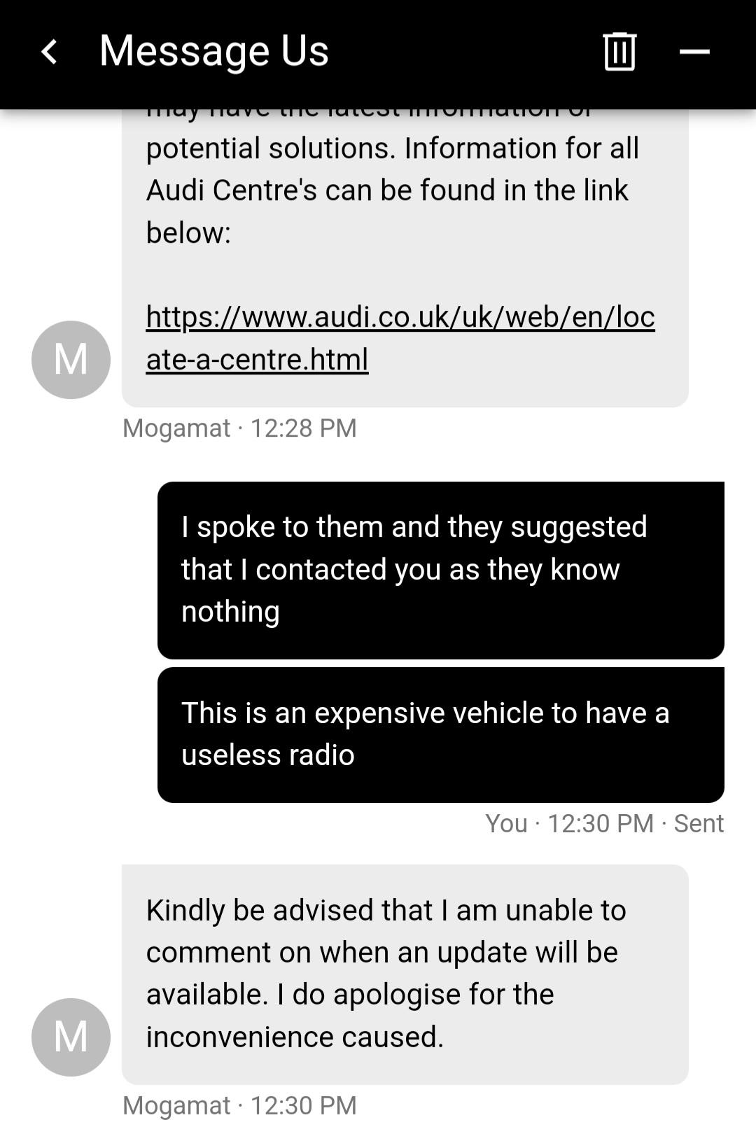

Spoke to the same customer service rep as Geoff64 in the above post and got a fairly similar response. Said he couldn't comment but was basically admitting they knew about the issue and were looking into it/going to communicate something on the matter(when who knows..). Originally he told me to take it into the dealer but then retracted that advise after speaking to his manager which confirms (as we already know) the dealer can't do anything as yet. I'm an Audi A6 c7.5 2017 by the way with the same RMC software version as everyone else. Maybe it's time to bite the bullet and get an Ali express android auto/car play retrofit.... It's wider than Audi by the way and my friends 2016 vw golf had the same issue. So if it's VAG wide I'd like to think they have to look into it.

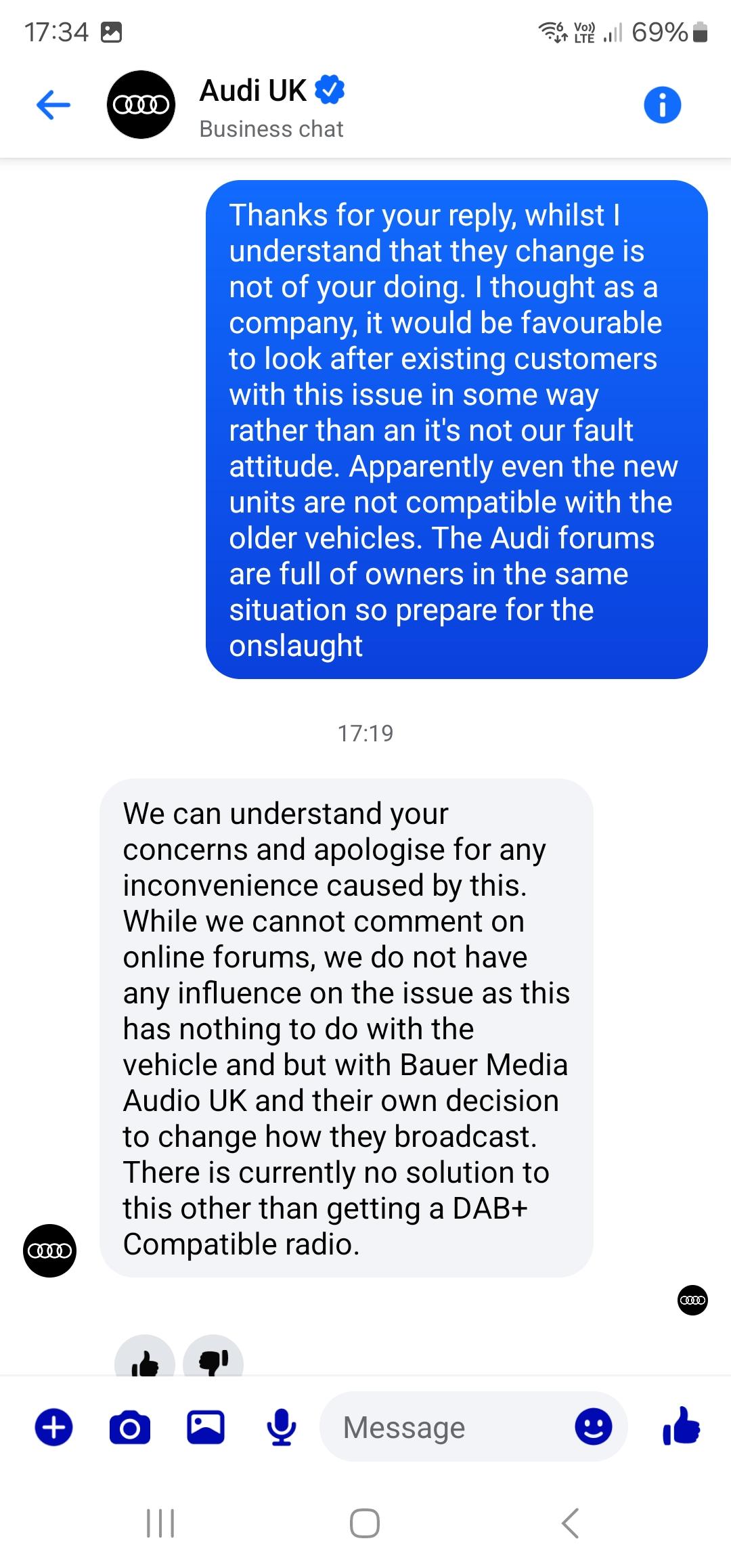

Just a further note, this is Audi UK response
Anyone know any good solicitors? Asking for a friend…  🤣
That’s an interesting take - the radios in the cars we produce can’t play the radio stations and it’s the radio station’s fault - but all other cars can ?!?!
Thing is, as I understand it, it's not just Bauer Media Audio UK.  It will eventually be all channels.

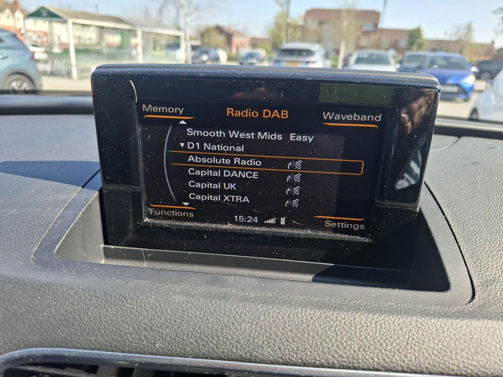

Add me to list, please, with 2016 Q3.  Lost dab channels at same time, end march,  except also lost Virgin main station, which they say is still Dab, not dab+, only their anthems/ legend station is just dab+.  Also lost talksport2, and a whole list is stations I don't listen to.  BBC all ok but then they are all fine on FM.  According to my manual it is a dab+ radio installed.

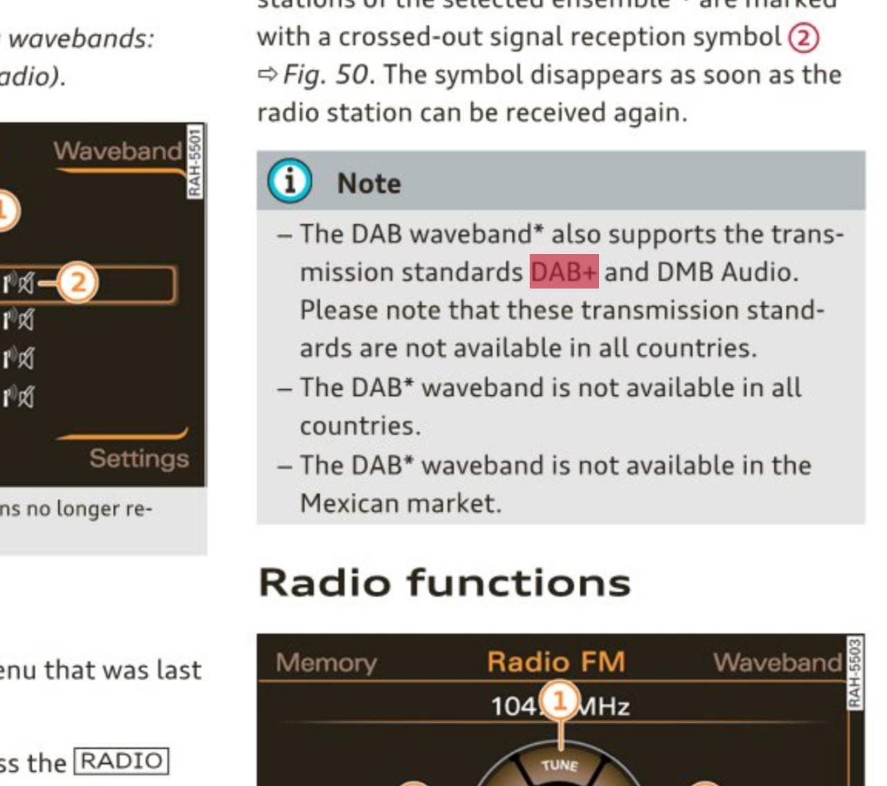

Hi All,
Add me to the list (A6, 2016). Below is an extract from the MMI manual, stating DAB+ is supported. IMG_2238.thumb.jpeg.218666e1478879af83b937c8a34ff95b.jpeg
Edited by Taffy-Glos
26 minutes ago, Taffy-Glos said:
Hi All,
Well spotted, Sir.  That's what mine says also.  They're bang to rights, aren't they?  It'll be interesting to see how they respond.
