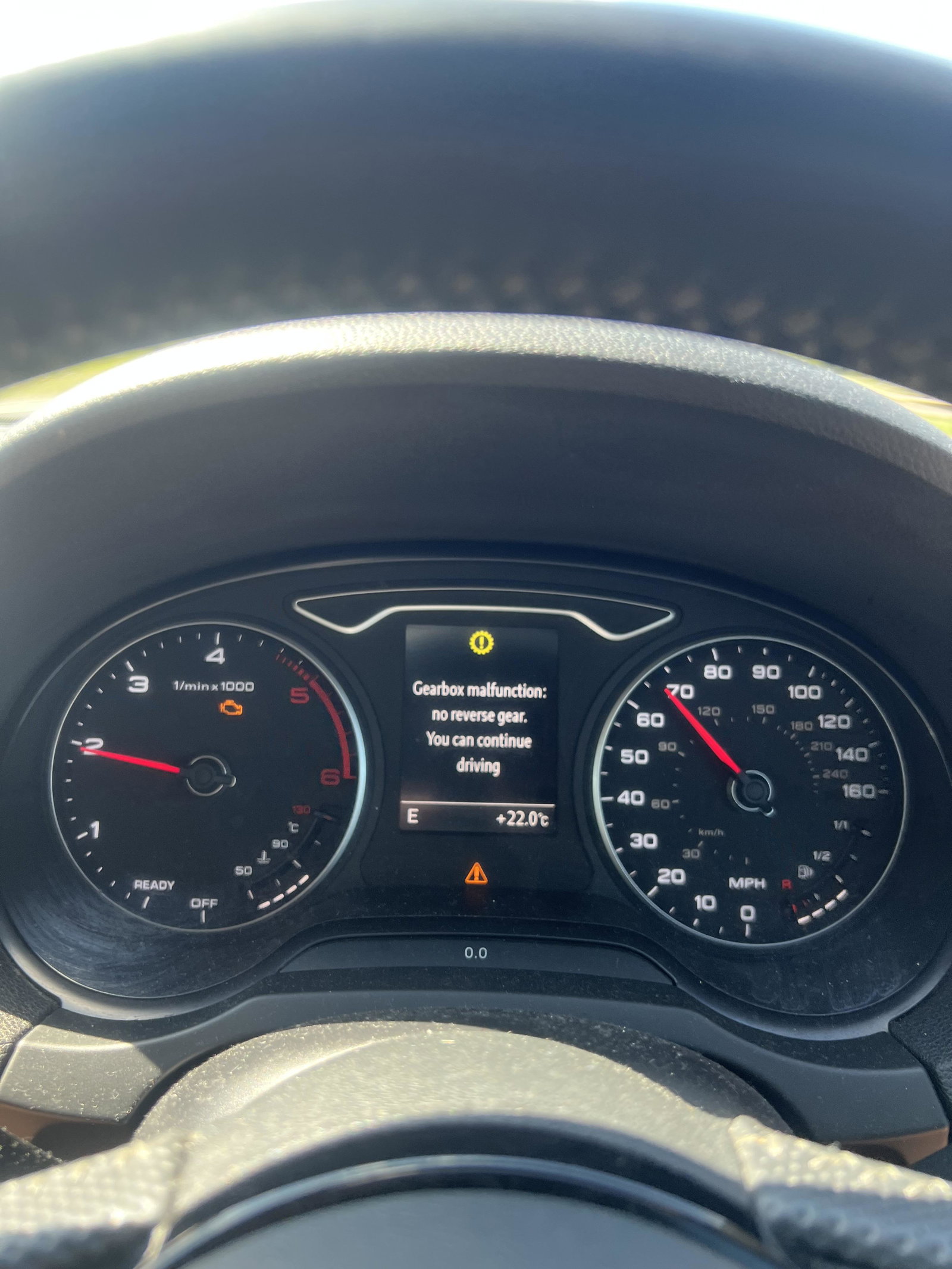

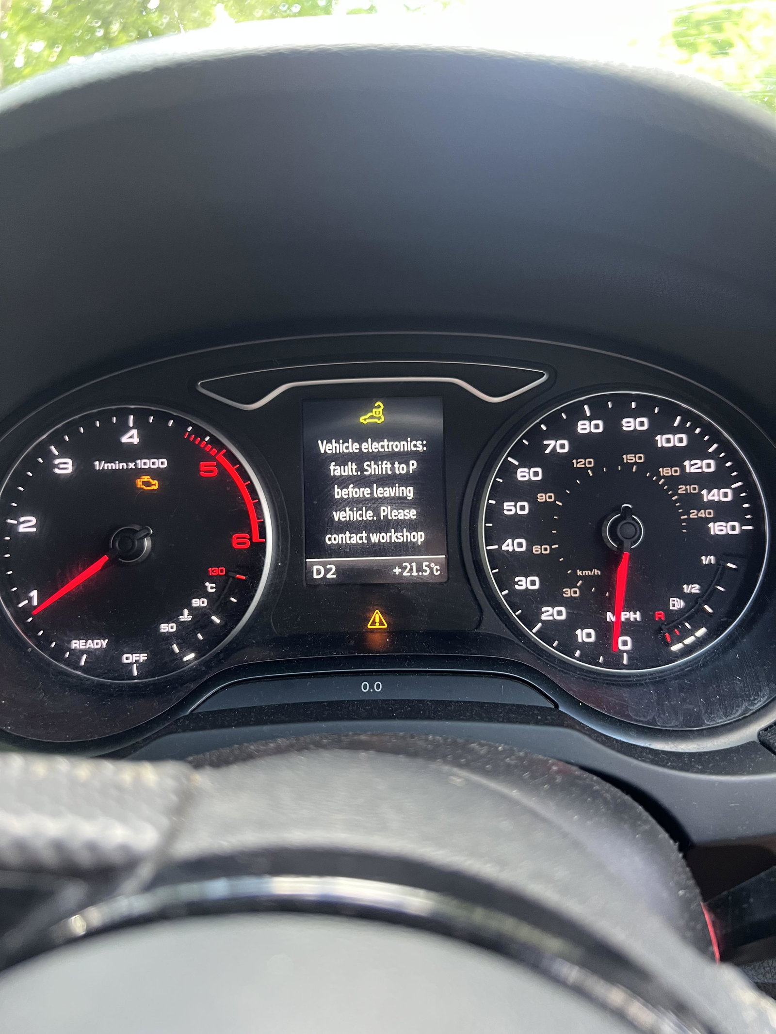

TomAudzz Posted May 10 Posted May 10 Audi A3 2017 with an automatic S tronic gear box. Sometimes when I get in the car it’ll throw up a fault saying I no longer have reverse gear and then also takes away 2nd 4th and 6th gear. This is an intermittent fault that sometimes just goes away with keying the car on and off but the engine management light stays on permanently. Then other times I’ll get in and start up and it’ll throw up a different fault code. All really confusing because I never know if the cars safe to drive. I took it to a garage to have the faults diagnosed but because the faults keep coming back then clearing by themselves it’s almost impossible to get them diagnosed because it’s always random. If anyone could point me in the right direction or has suffered from this issue themselves any information would be greatly appreciated. I’ll attach the faults in images below. As I said both of these faults are intermittent so they come on and off all the time but the engine management light is constantly on.
spartacus 68 Posted Sunday at 05:51 AM Posted Sunday at 05:51 AM The car needs to be scanned with VCDS. The fact the fault is intermittent will still register the error, and time it happens. Given it’s the gearbox, then act sooner rather than later to have it checked. This gearbox needs an oil and filter service every 38k miles.
Steve Q Posted Sunday at 03:24 PM Posted Sunday at 03:24 PM I agree with Richard. Wire case scenario the megatronics unit is on the way out.
