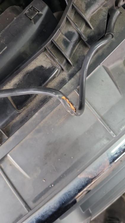

sarahb3579 Posted June 11 Author Posted June 11 6 hours ago, Magnet said: Thanks, Faulty new starter motor? The fact that it’s new is no guarantee that it is serviceable out-of-the-box, or that it will remain so during its guarantee period. Sub standard electrical components from distance parts are not uncommon! Having said that, was your original one the culprit?? Varta battery should be fine and is likely to be the OEM brand, although I have had issues with them in recent years, and no longer depend on their quality vs. brand. Pressing clutch pedal before starting:- by no means an uncommon requirement. update!! this was found, the mechanic forwarded me the picture but not sure where it is. starter is still being chnaged tho to a new one just in case i think. originally, i changed it to a new one, drove it around fine for 2 weeks and then had the same issue of not starting. first mechanic said the starter has been changed before i bought the car so not sure what that was about.
cliffcoggin Posted June 11 Posted June 11 That burnt cable would certainly explain the starting problem. I hope your mechanic is going to renew the cable rather then just wrapping bit of tape around it, and then secure the cable with a clip so that it does not flop around and wear the insulation off.
sarahb3579 Posted June 11 Author Posted June 11 10 minutes ago, cliffcoggin said: That burnt cable would certainly explain the starting problem. I hope your mechanic is going to renew the cable rather then just wrapping bit of tape around it, and then secure the cable with a clip so that it does not flop around and wear the insulation off. judging by the photo im assuming the cables connected to either the starter/ battery but he didnt say. i hope so too only took the third time to the mechanics but finally something has been found !! i shall update when i hear back. thank you!!! much appreciated 🙂
Steve Q Posted June 11 Posted June 11 Glad the mechanic has got to the bottom of it 🙂 please keep us posted
Magnet Posted June 11 Posted June 11 Difficult to say from your photo, but that may be the engine earth. Let’s hope it isn’t, since if it is, I would not think that in isolation would prevent the starter motor from doing at least something. Regards,Gareth.
sarahb3579 Posted June 11 Author Posted June 11 thats the only picture he sent me or i would have posted another!! thank you so so much all for your guys help, so so appreciative and will keep you all updated!!! 🙂 1

sarahb3579 Posted Friday at 02:28 PM Author Posted Friday at 02:28 PM UPDATE!!! the frayed wire was changed completely and seems to have fixed the problem. thank you for everyones help 🙂 1
