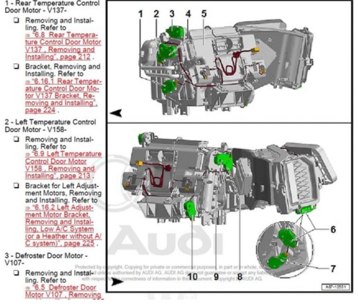

Any idea where this air flap motor is located in the car? I'm presuming it'll need programming by someone who has VCDS too? Also would it be the same part number as the recirculation motor too?
The only picture I have under the glovebox from when I replaced the recirculation motor(example 1) was this one but I believe (example 2) is the fresh air motor. I couldn't see any others for the passenger side.
Edited by figo_rulz11
Just now, Sid2020 said:
A few variants but hope this is helpfull

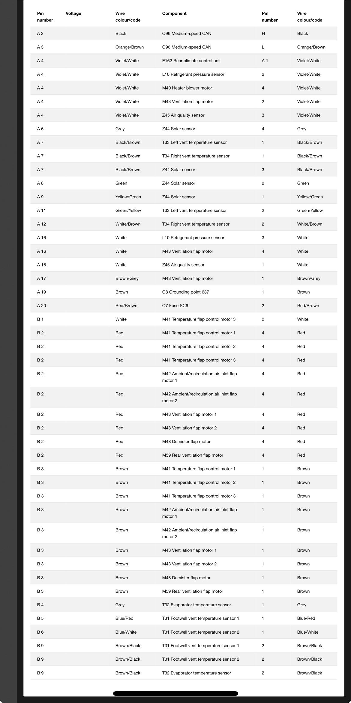

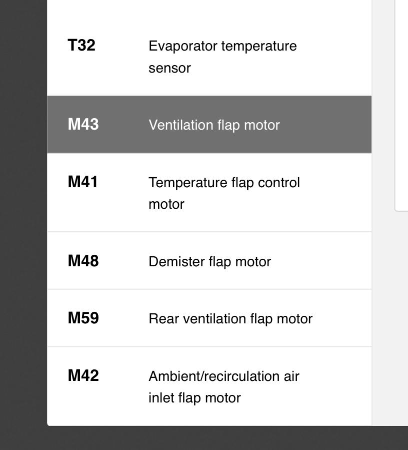

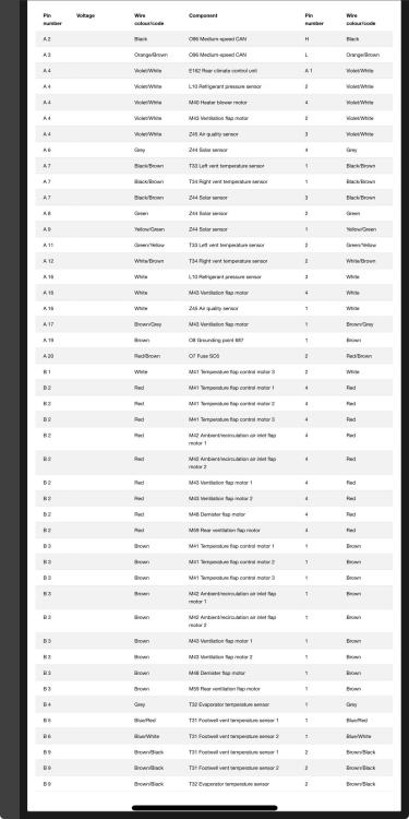

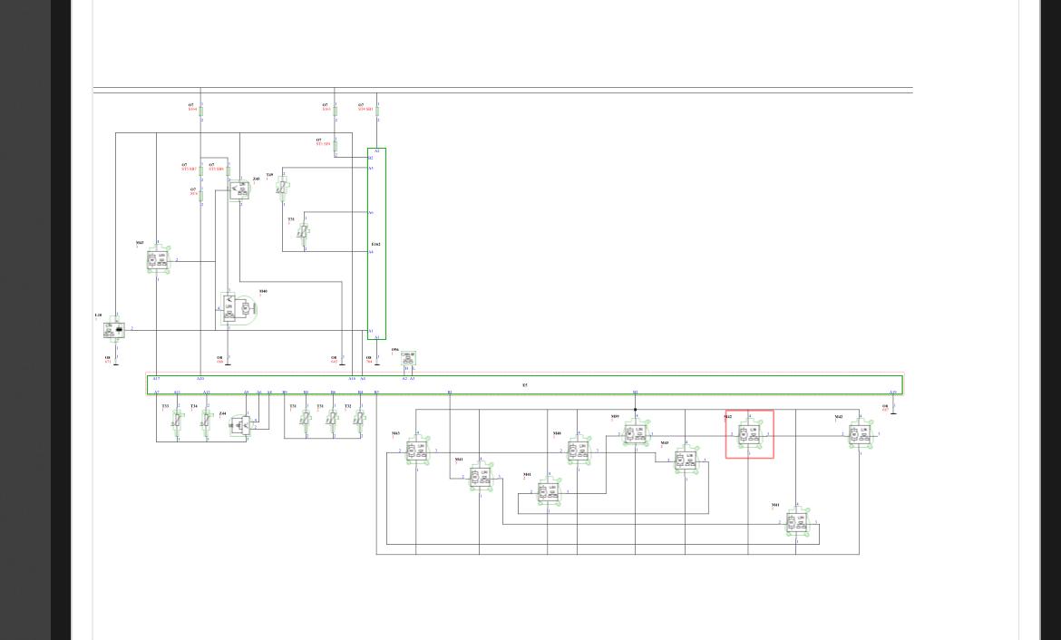

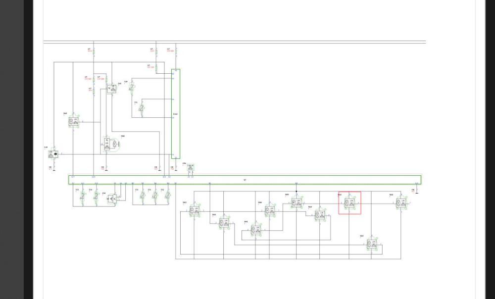

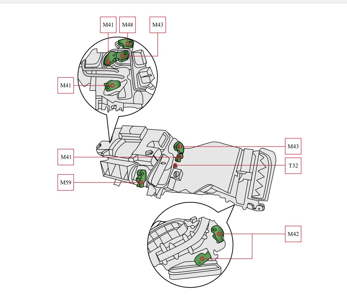

Thank you Sid, I appreciate you. I don't suppose you have the PDF/document you could send me for instructions too where it references the pages?
I'll have to get error codes read to see where the problem lies with which component but may be difficult as it's intermittent but rather do the research now.
Unfortunately I don’t but I have access to abit more info which might be of use
