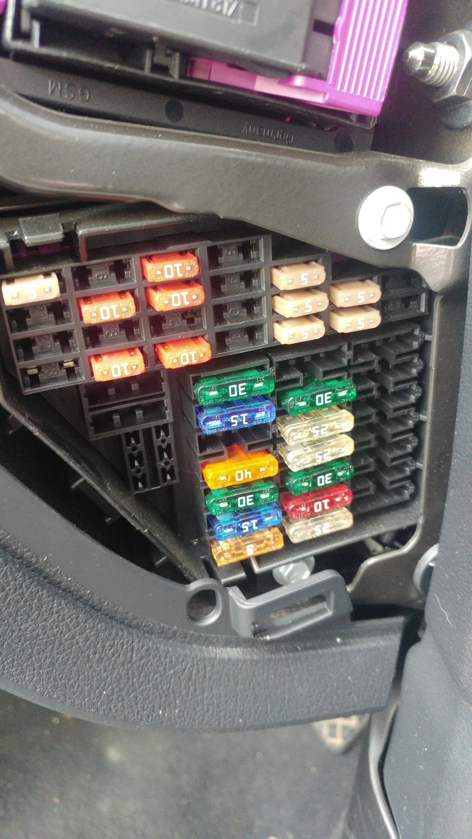

Looking at my fuse description pic can anyone tell me  which fuse switches off with the ignition
