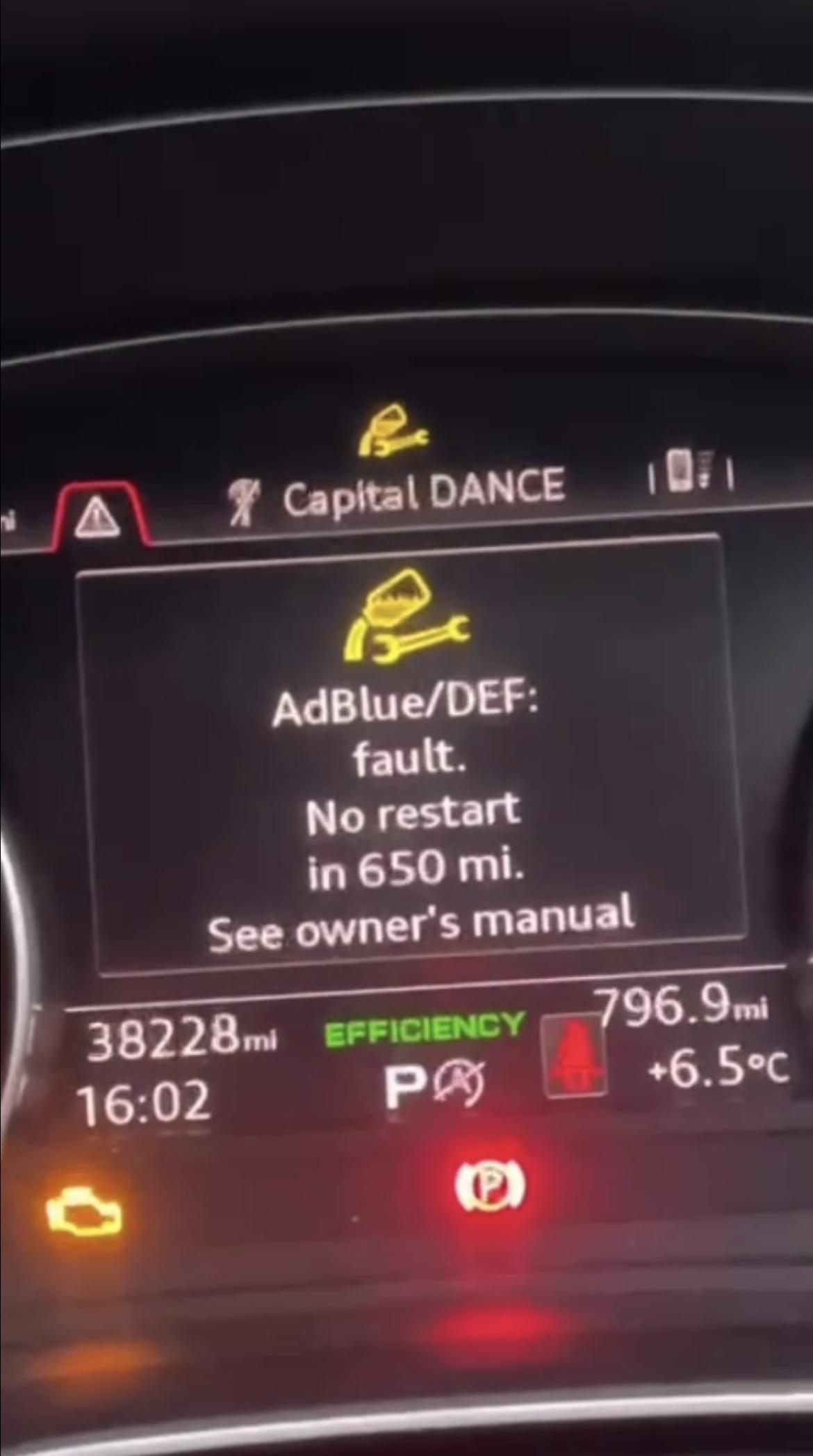

A bit off topic but doesn’t anyone know anything about this problem A4 Allaroad (B9)
Your car has a seperate adblu tank. It's used to help with emissions. The tank is nearly empty and needs to be filled. On my car, you'll find the filling point next to where you fill your car with Diesel (it's the blue coloured cap) Most cars take 12 litres, but some have a 24 litre tank.
You can buy Adblu from most petrol stations - some even have a Adblu pumps, but I've not come accross any
The AdBlue tank is full it only appears in the morning on a first drive then goes away for the rest of the day. Think it’s a dodgy sensor
my mistake - shoulda read the message properly!
