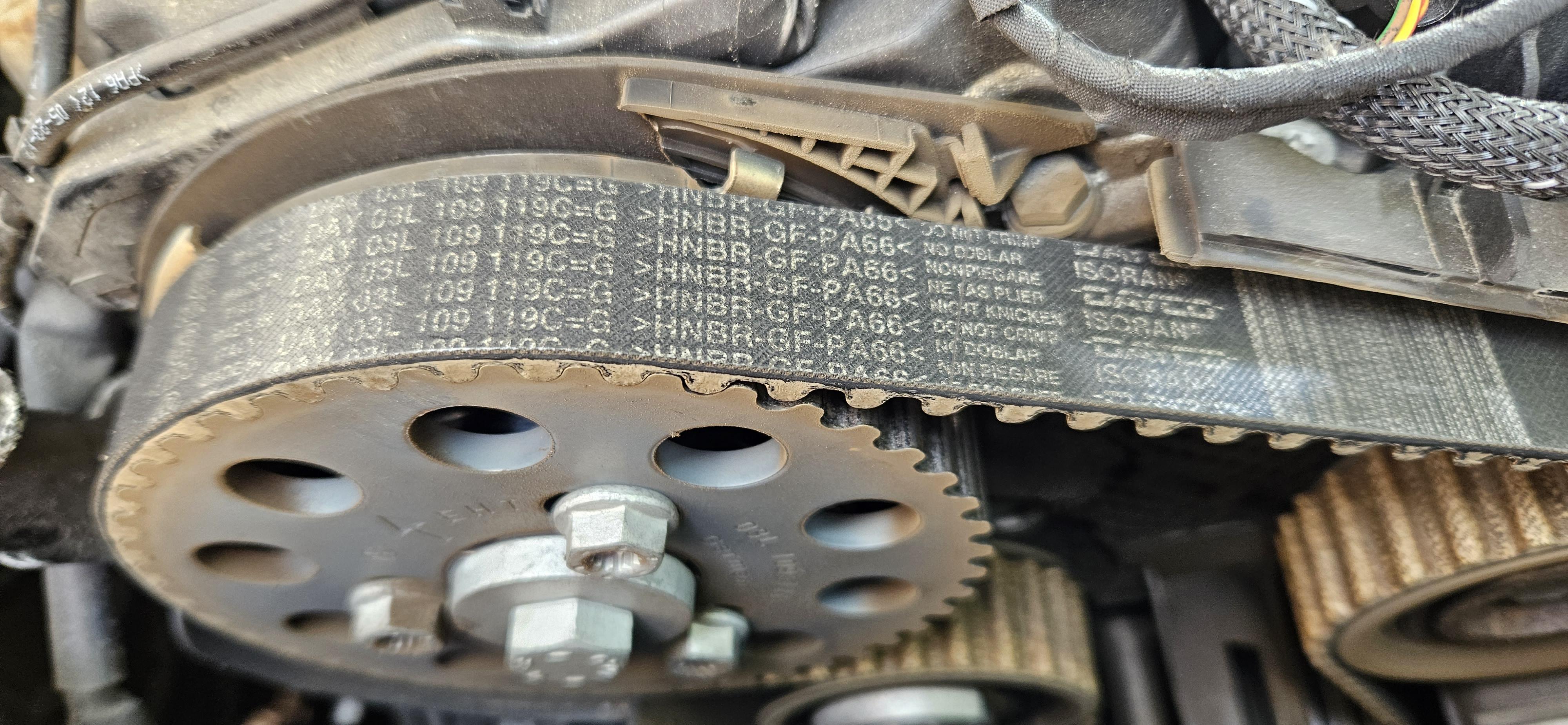

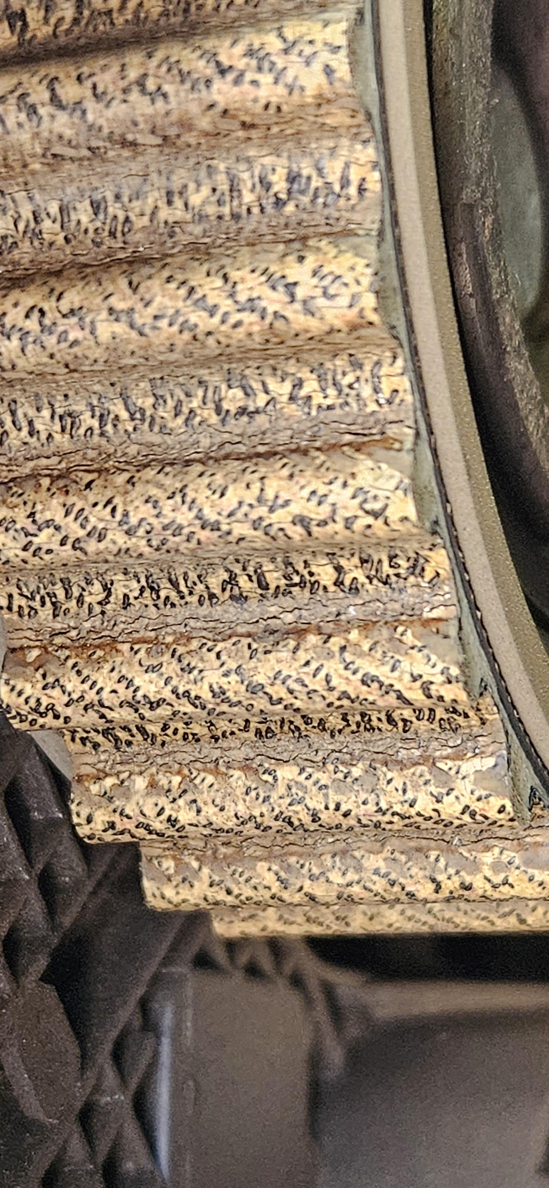

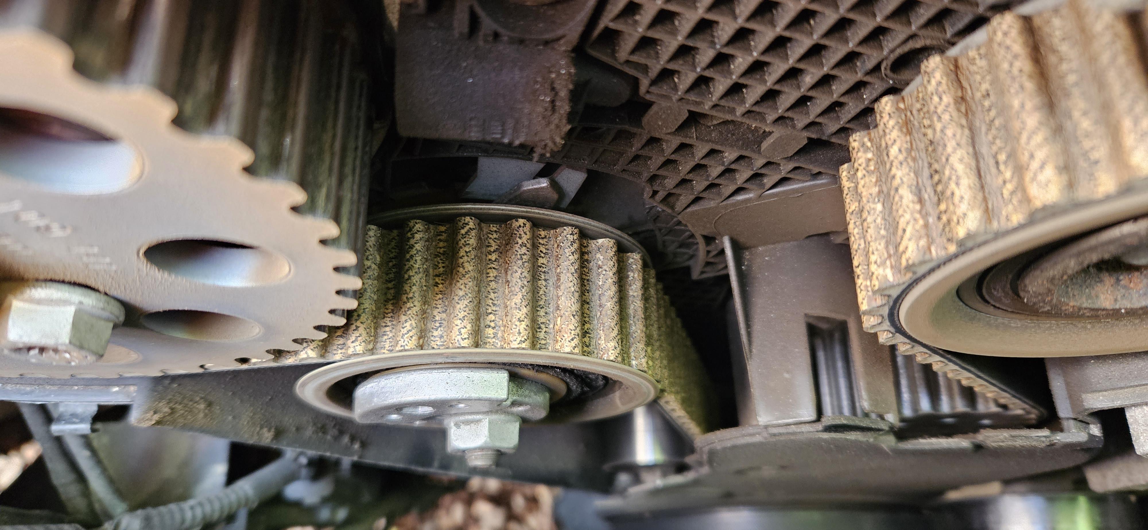

Bought 2012 A4 2.0 Tdi Tecknik se 2 months ago and at 72000 miles and was told timing belt has been replaced but no proof in service book but has been serviced every year, on 72000 mile now and Independant garage that has serviced it for years can't help as was on private plate then. Can anyone tell from photos if ok or needs doing? Pics added

Hi if you do the sums it should be on its third belt by rule of 80k or 5years, you can't tell by looking at it and Dayco is aftermarket premium the OE is INA, but from my analysis of the photos it doesn't look that new therefore from a personal perspective I would change it absent any documentation to prove otherwise, when you consider the alternative of the repair bill if it lets go a replacement is a lot cheaper.
Thanks Steve, belt does have Audi stamped on left of writing you can see, I was more worried about little cracks in third photo, any idea of replacement costs?

I too would be concerned with the cracks, and would certainly follow sound advice and get it renewed along with the additional components mentioned.
